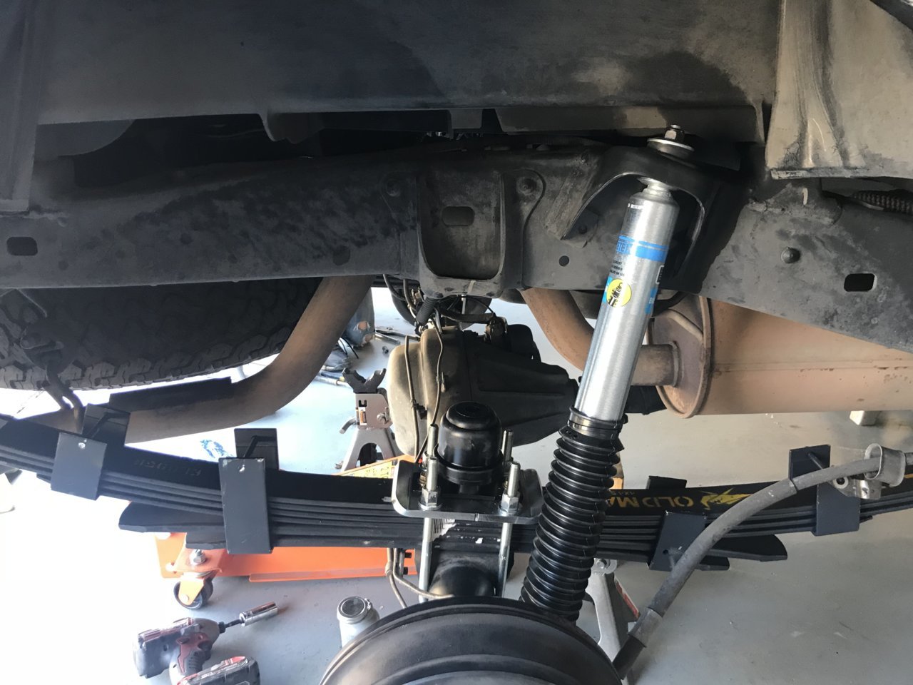

    I literally just did this last night.
