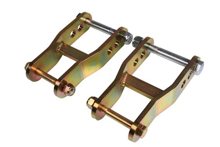

    Thats a good idea but i wonder if longer shackles create any problems or just a weaker shackle

    Everything, when you take 3 inches out of your travel and when you add blocks that is what you are doing. Your shocks will bottom out quicker on down travel and on up travel there will be a lot more stress on control arm bushings and ball joints because the coils will have more pressure on them before you hit the bump stops.
