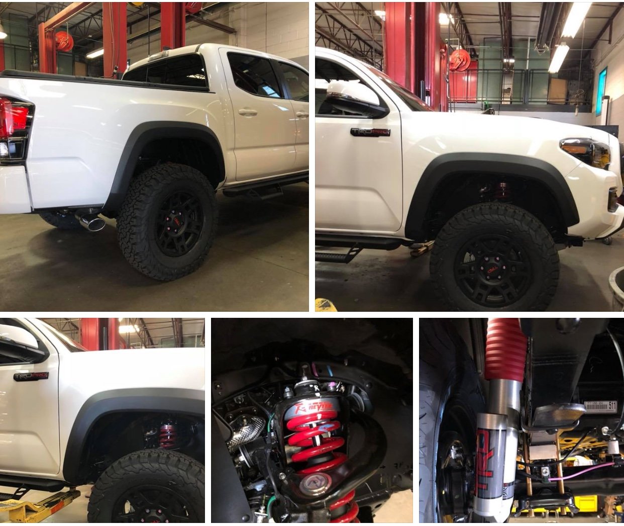

    Ackem what i said was

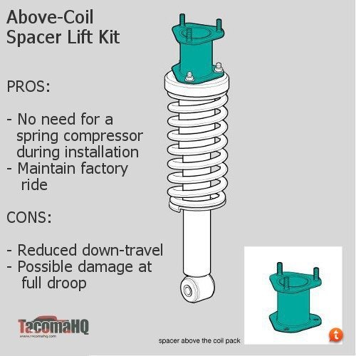

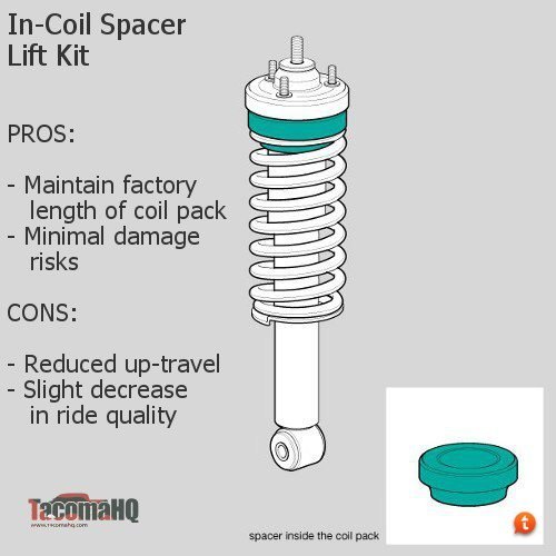

    I put 100k miles on my 2004 with a Revtek 3” coil spacer. She saw some off-roading and even jumped all four tires off the ground at a railroad crossing one night! Zero issues.
    Top spacers cause shocks to break if you don’t extend the bump stops to counteract it. And top spacers allow your LCA to hang further at full droop, which can put CVs in more of a bind.
    Coil spacers limit up travel, but it’s the same thing as getting new adjustable coilovers and cranking them up 2”- you now have 2” less up travel.
    If you’re going to run spacers, run the coil spacer- the ones that you have to take your strut/coil assembly apart to install. Way more reliable.

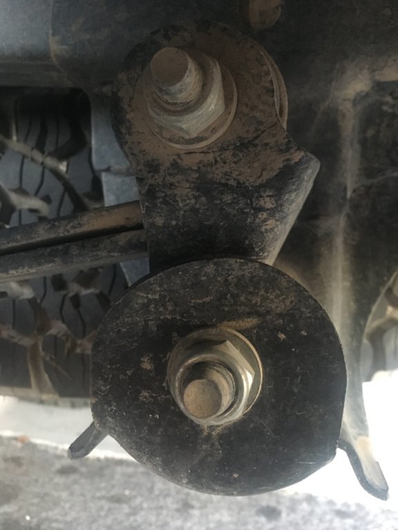

    Not bad

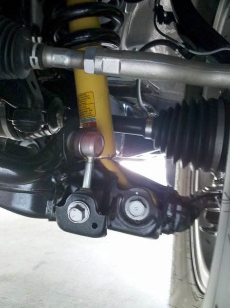

    Bad
    Causes this because the shock bottoms out before the LCA hits the bump stop.

    So to fix this just get bigger bump stops right? Also theres many theroys why that happens and ever notice that it also ever only happens to the yellow bilistein shocks?
