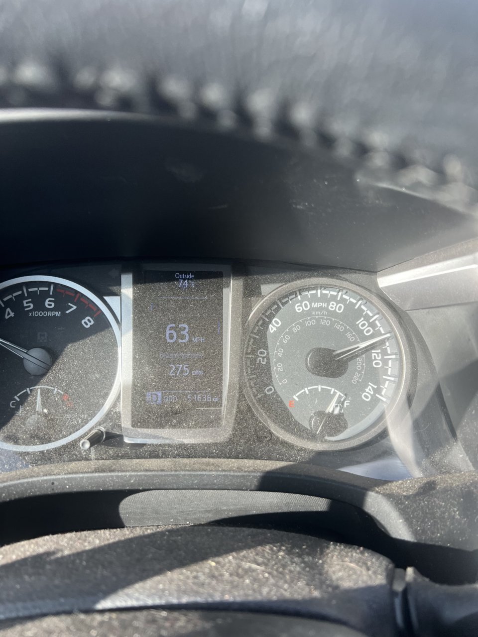

  17. Sep 10, 2023 at 5:06 PM
    #17
    Danlawley
    Danlawley New Member
    Sep 10, 2023
    #433233
    2020 Toyota Tacoma
    Limited 4x4
    My Speedo is off by a few more than normal just started doing this today. Any thoughts?
