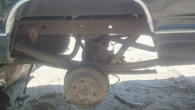

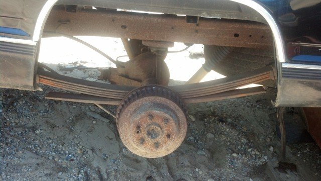

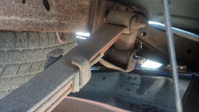

    Finally got to the yard and found an 89 Chevy 2500 with these springs on it. 63" L x 2.5" W. Got everything unbolted but couldn't get the bolts holding the springs in place out before they closed. Going to take another go at it this weekend, hopefully someone else won't take my hard work.
    Any ideas on how to release the tension to easily get these remaining bolts out?

    hey cliff since its at max droop i'm assuming the ubolts are in place still is this right ?
    Or is there something under the diff holding axle up ?

    I've unbolted the ubolts. Only the shocks are holding the rear in place....its just the leafs' tension that is holding the bolts there. I can still use the rearif needed. I tried jacking up the rear back to the leafs to relieve tension with no luck..
    What do ya think? Springs look good for OMD approval?

    yeah they have smooth even ARC, shit you don't need the main leaf right ?
    I'd just remove centerpin & let the mess drop
