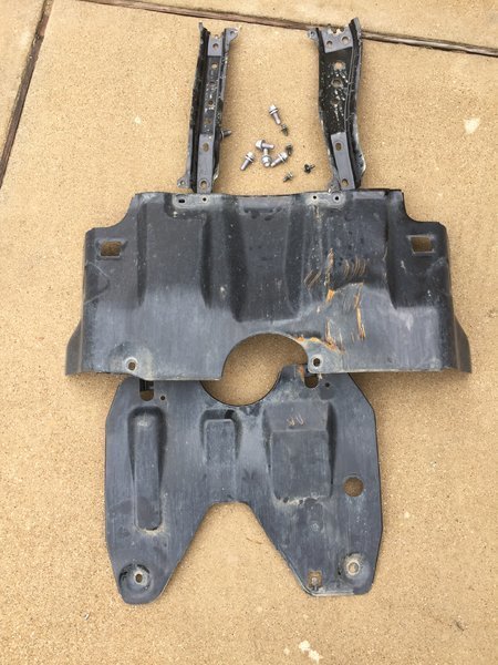

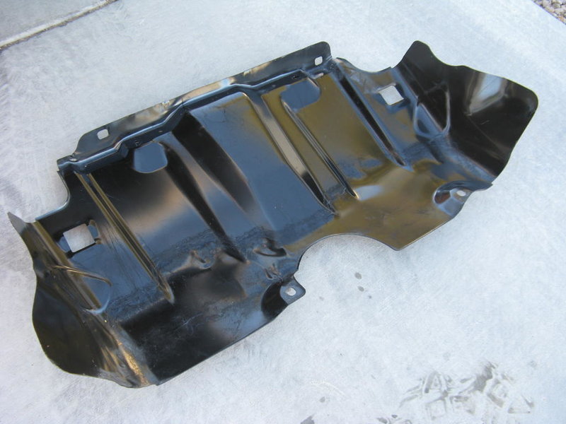

    SR, SR5, TRD sport, and limited models should come with the one single front splashguard/bashplate/skid plate thing. Mine came with one and it’s a 2016 SR 4x4.
    The off-road model gets both a front plate and front diff plate.

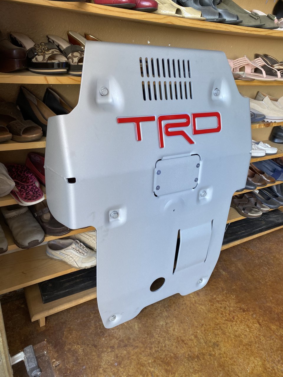

    The TRD pro skid plate comes on the TRD pro models. I can confirm that any of these plates will fit from 2016 to current models cause they all use the same mounting points although the pro skid uses spacers and longer bolts.
    You can find a bunch of stock skids on the used market like Craigslist, Offerup, eBay or even Facebook. The oem front plate uses 4 bolts (Size M8-1.25 x 25mm) to hold it in place.
