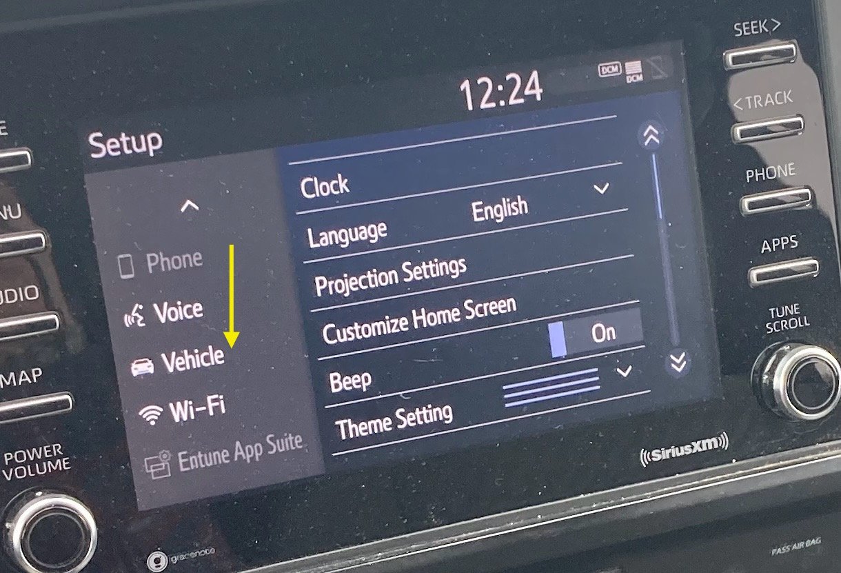

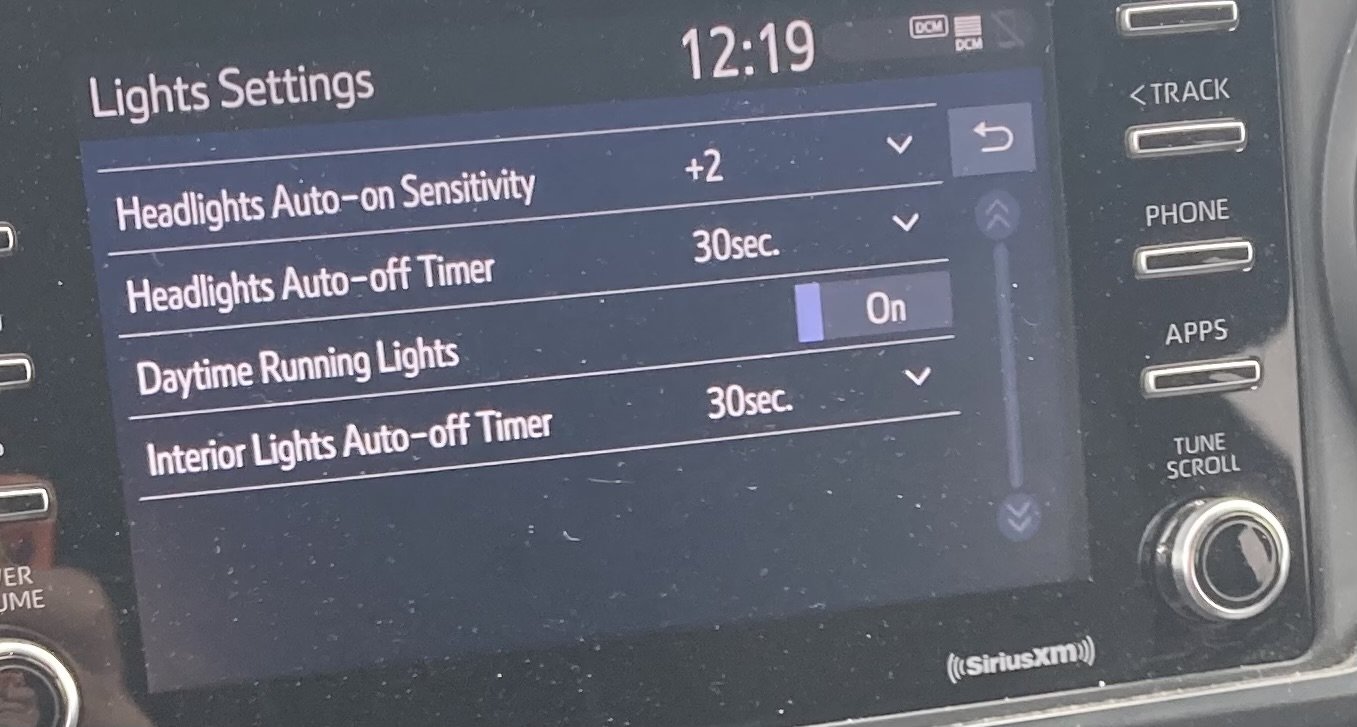

    I have a SR. Does yours not have it on the stock? You can also adjust the DRL in vehicle settings on the multi-media screen.

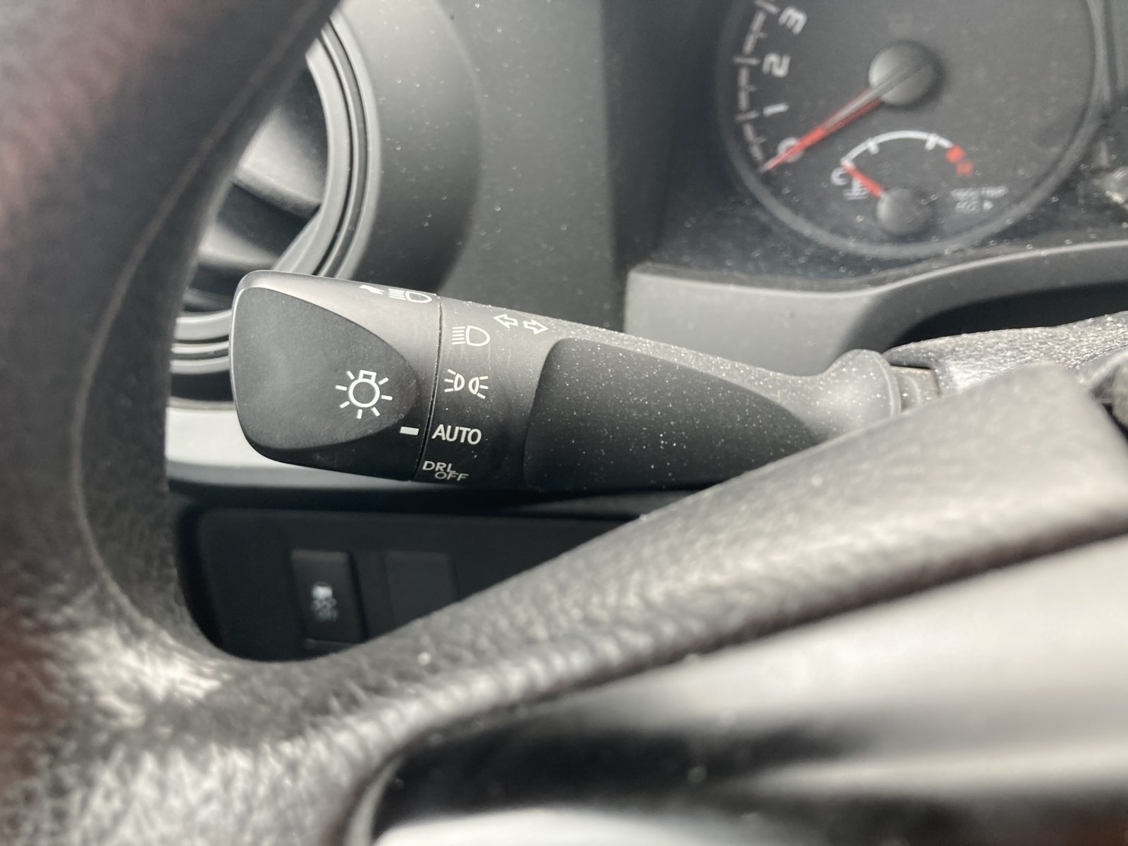

    2023 SR. Stalk settings are: Off - Auto - Park - On. Oddly enough, the ‘off’ position is labeled ‘DRL Off’. And, I just confirmed that in the ‘auto’ position, the headlights turn off when it’s light out. (Held flashlight over light sensor on pass side - headlights turned off.)
    So - no headlights during daytime, and so no DRL. Unless I just turn the lights all the way on. Why, Toyota, why?

    Thanks, I’ll check the settings tomorrow.

    This is the most basic, cheapest model (no back seat cushions), I called a dealer and the parts department says there are no running lights (DRL) on that model. I am going to get in the "Vehicle Settings". If I can change the "Timer" to 15 seconds, I'll just leave the parking lights on.

    I got into my settings and reduced the time to 0. I can leave the parking lights on, they come on when I start and go off when I turn the ignition off. I'll be happy with that because I have tail lights too. Never understood why the DRL weren't in the back too.
