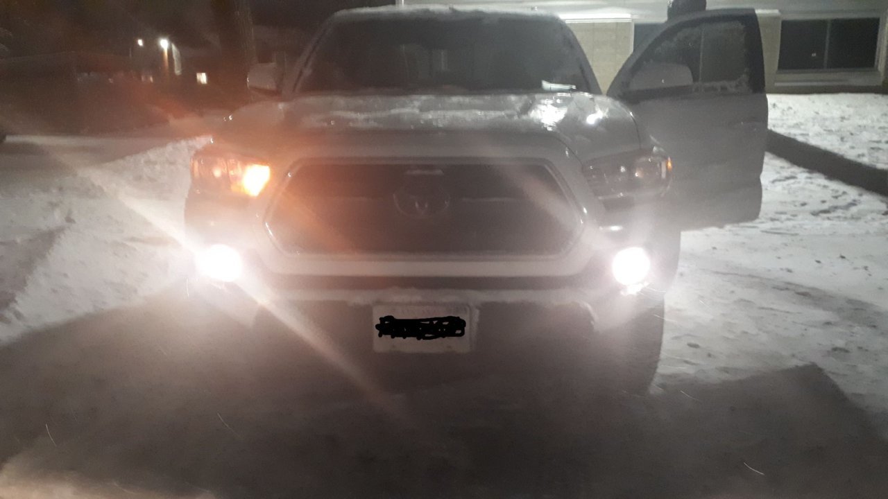

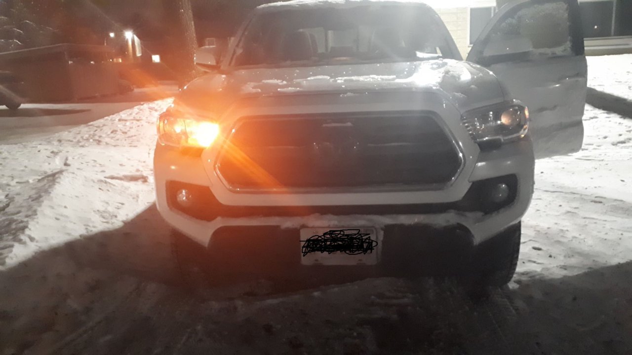

    Truck is turned off, key out of ignition, e-brake is off, headlights turned on. Only 1 daytime running light is illuminated:
    Am I missing something? Should not both DRL's be lit up? When I start the truck the drivers side then kicks on.

    For anyone that cares... the dealer ordered the wrong bulb the first time, they had to order the right one again which finally came in this week. Swapped out the old bulb with the new and the problem is fixed. You can see one of the filaments is broken on the old bulb. Now I know for next time!
