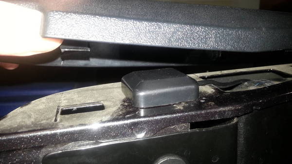

    Carefully remove the plastic insert with a small flat screwdriver, and slowly lift the plastic cover from the top of the bed. Only lift plastic high enough to install antenna, and it does take a little work to get the plastic to lift and disengage fasteners. You do not need any tools to lift the plastic rail cover.

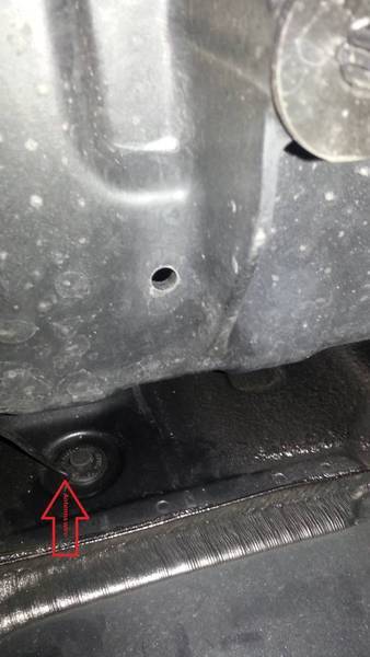

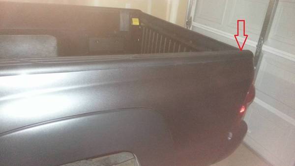

    Place the antenna in the location shown in the photo and run the wire down the square opening. Then, run the wire over the wheel well toward the back of the cab. Locate the rubber gasket behind the cab on the drivers side and remove. Run the wire inside the cab. Take your time and be careful not to damage the wire. I am also going to install a wire protector similar to the other factory wires under the truck.

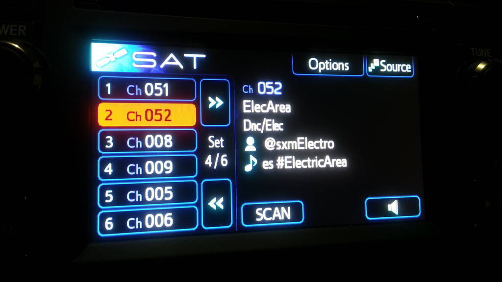

    Excellent reception in my 2013 Tacoma Regular cab. I also installed Toyota part# 00016-00076 to add the XM Satellite Tuner kit to my factory non-JBL touch screen radio. Antenna fits perfectly, and there is more then enough room under the plastic to hide the antenna.

    I think you'll need a square antenna to fit since the surface under the plastic is uneven and there is just enough room for the square low profile metra antenna.

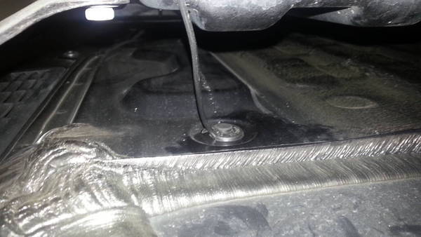

    Here are two photos showing the antenna radio wire entering the cab.

    Just did this Mod today... Very Cool! the recommended antenna works very well, it fits perfectly in the hidden cubby beneath the bed rail as Hunterwil indicates.

    I removed the inner paneling behind the drivers side rear seat which required removing 3 bolts to the panel, and 2 bolts to the rear seat back. I then popped the kicker plate trim and rear lower panel to gain access to the rubber plug shown in the pictures.
    I popped the plug out and drilled a small hole in the center, and split the plug on one side to fit it around the antenna wire, and then reattached the plug and wire back into the body.
