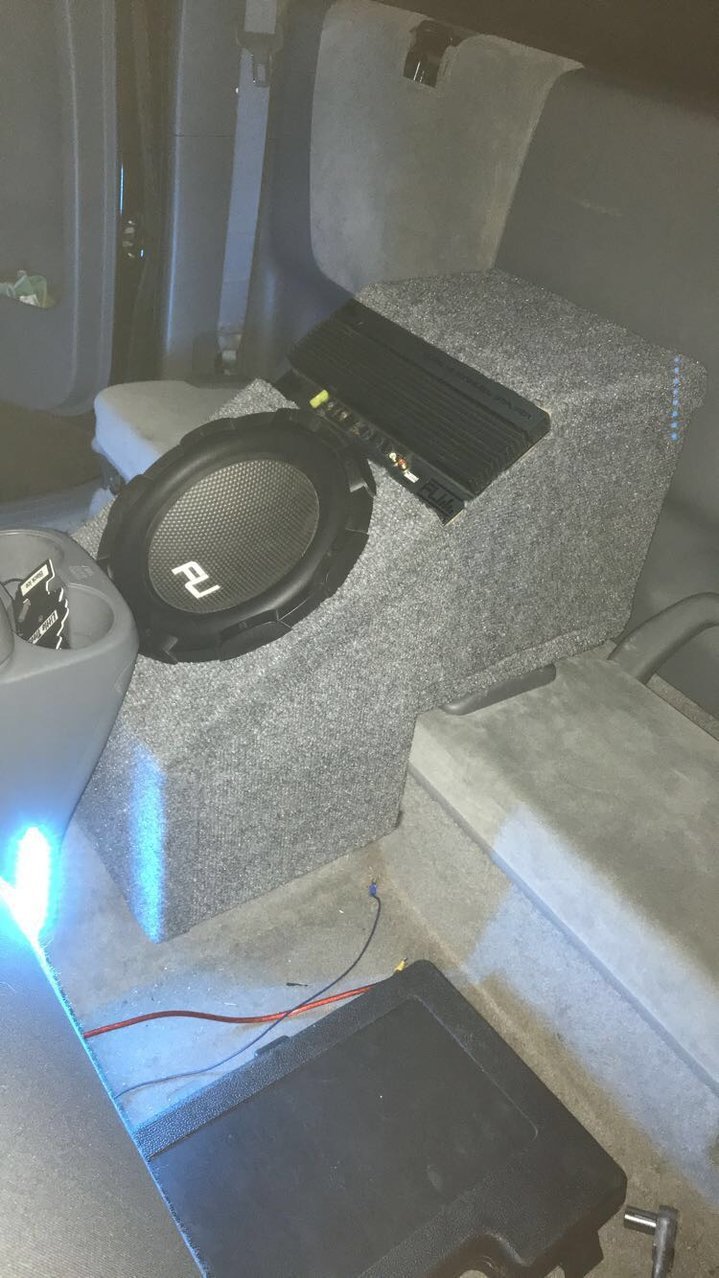

    Looks nice. How bad does the truck rattle? I wanna do the same thing in my AC, but put the box behind the passenger seat instead

    Not bad at all it actually fits very nice I have the dimesnsions for a 12” sub but u would need to lengthen the base to support it in the bottom of the seat

    no port at all actually sealed but i had to run silicone on the amp to seal it against the angles

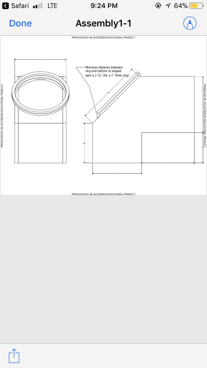

    I wanted to do a 12" sub. The box is the only thing holding me back. If you can enhance that picture for the sub box diagram it would be much appreciated. I caint read the numbers :p Unless you tryna build me a custom box haha

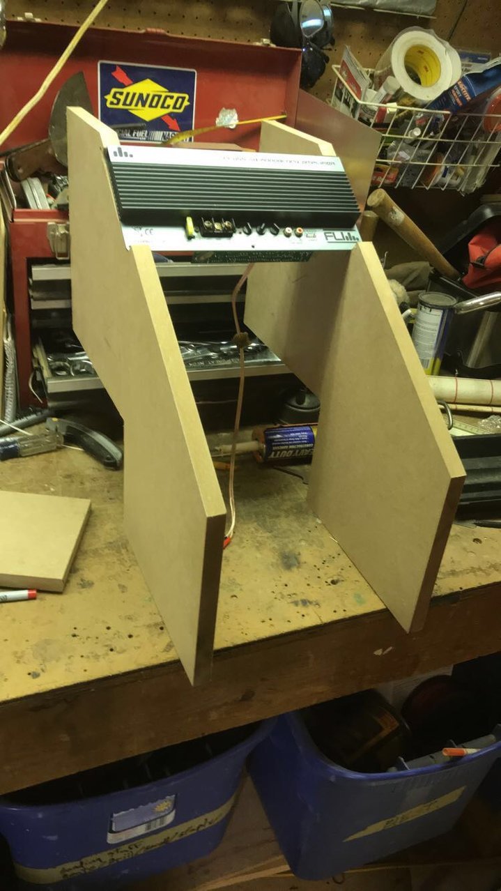

    I’m not gonna lie I’d take the money to make u one but I’m not a professional and there’s always a chance u want to make a personal alteration I’ll try and enhance it .also the mounting of it is that the outside screws mount onto the side panels but I pre drilled all mine and one cracked still the mdf board is so fragile u have to be very careful

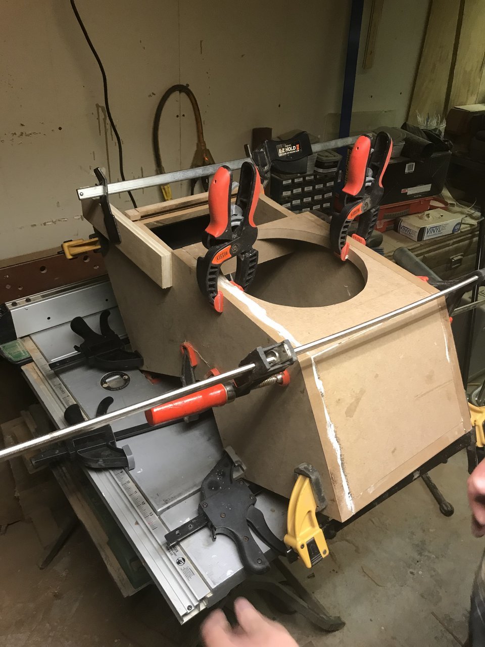

    True true, thank you very much for the blueprints! Now i see you built your amp into the box itself, my wiring for my powered aub is already run under my passenger seat. Could i install the amp under the passenger seat and just fill it with polyfill or something? Think i could get by with using MDF board, some two inch screws, carpenters glue/caulking anything im forgetting?

    Clamps lots and lots of clamps to use !

    This has to be the first time I've seen a plate amp installed in a vehicle. Pretty clever! Man that box looks like a total PITA to build though.
