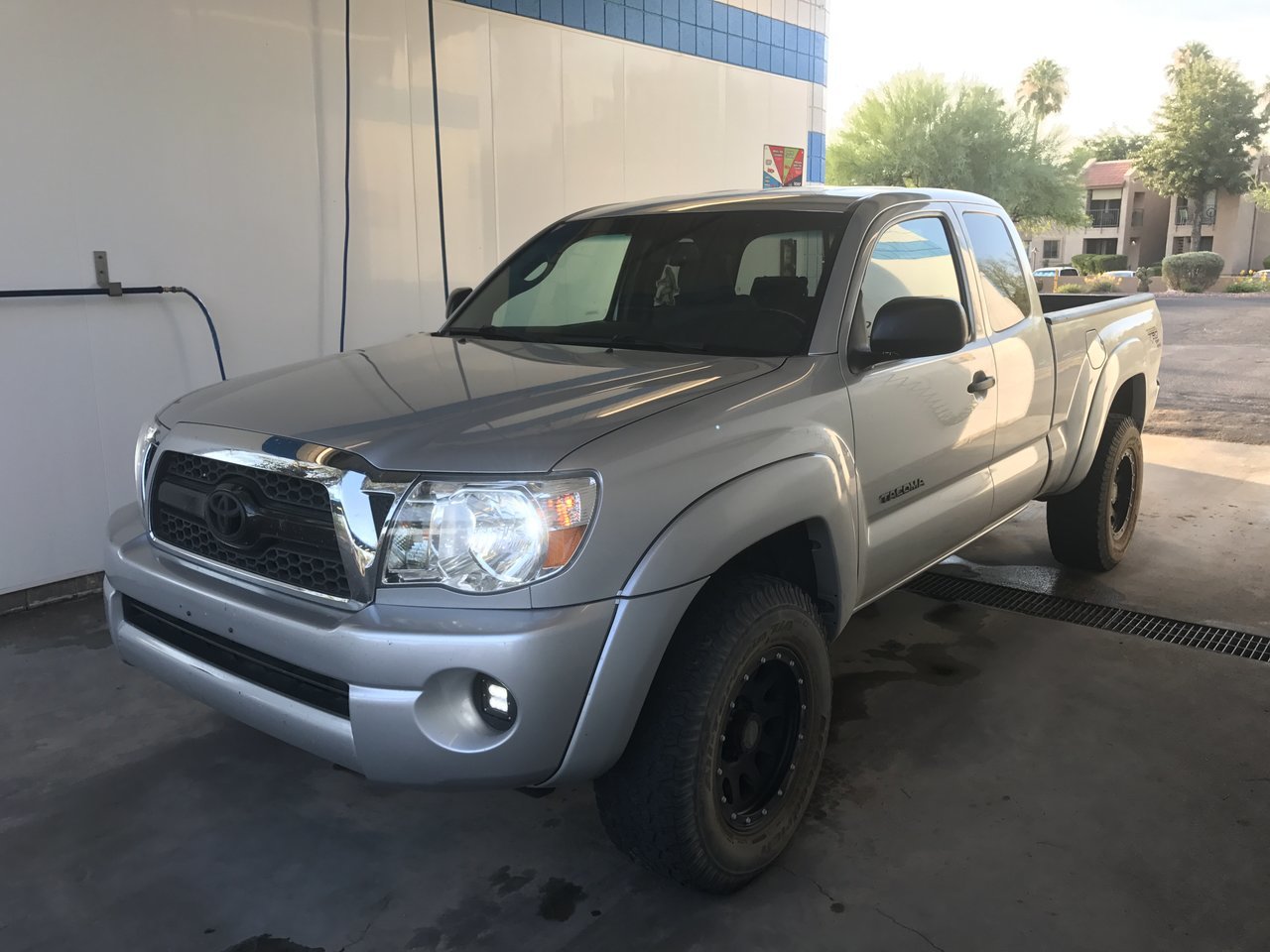

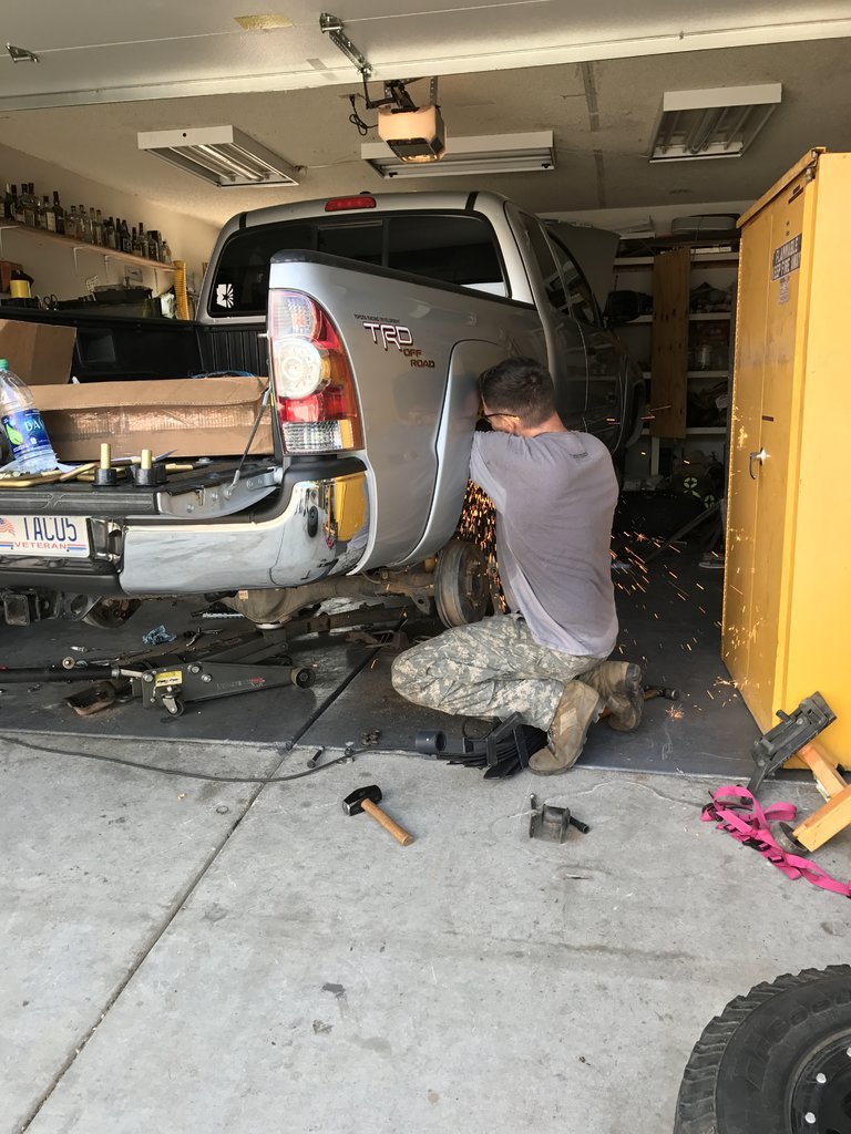

  8. Aug 16, 2017 at 6:33 PM
    Buckwheat893
    Buckwheat893 Well-Known Member
    Jul 23, 2017
    #224855
    296
    Cody
    Tucson, AZ
    2011 AC

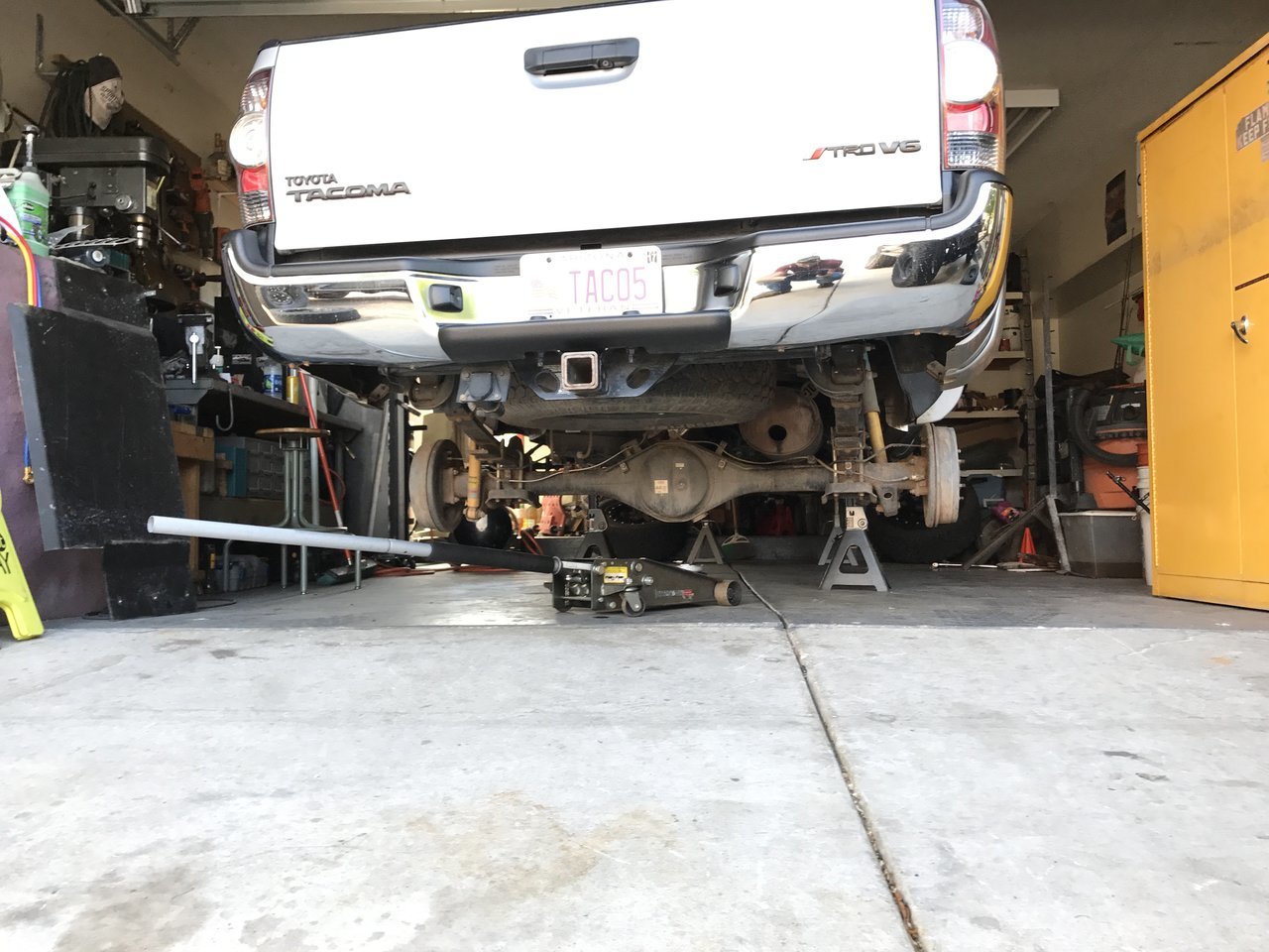

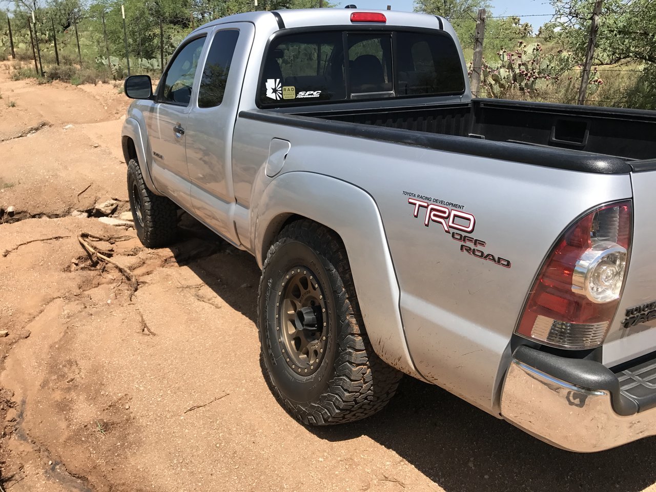

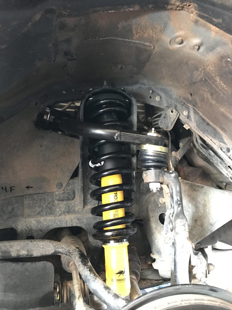

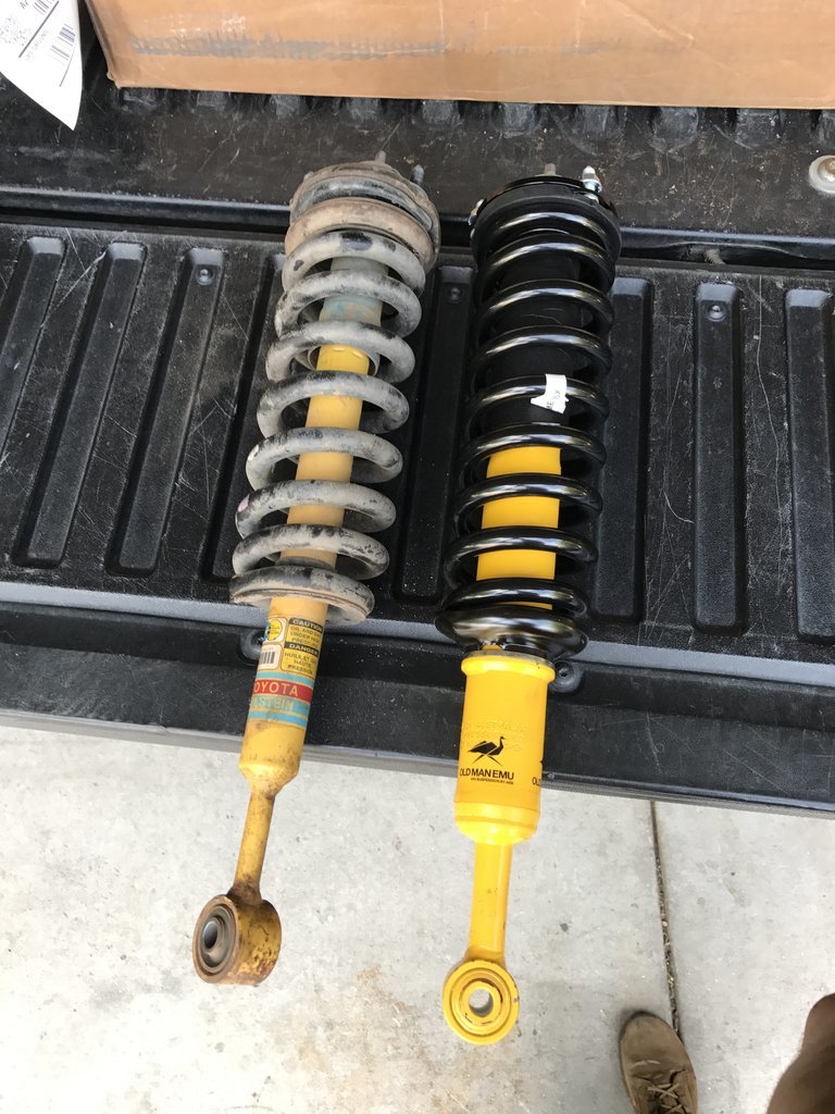

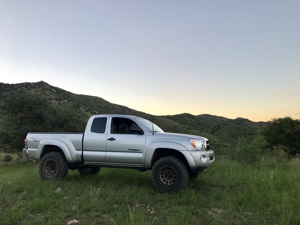

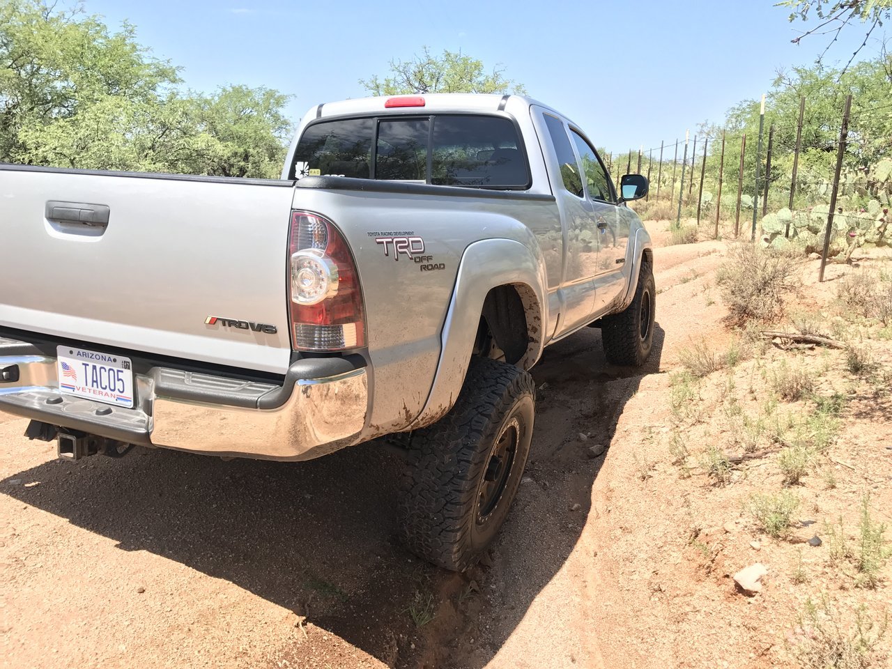

    The OME 3" is what I have installed and I love it. Everything was purchased from headstrong off-road for $1771 if I remember correctly. We basically have the same truck, so I can give you some pretty accurate insight. I went with 885 coils and the 1/4 top plate spacer, along with the drivers side 10mm trim packer to correct the "taco lean". For the rear I chose dakars, and in my opinion they greatly outperform the front lift. The rear rides extremely well and has more than enough travel. The front can be a little stiff (by stiff I mean slightly more than stock) over speed bumps but off road it hasn't given me any issues. As far as travel goes, in extreme situations off road at full lock and stuffed I do hit the cab mount, but I will be doing the cab mount chop to correct this soon. For me the travel is sufficient, ifs is not notorious for being flexible so I'm happy with what I have. I did install spc uca's and aligning the front end was no issue. I'm running 285/75-16's and I did have to do minor plastic trimming on the front (nothing noticeable) and remove the mud flaps. As far as install/time goes, I would highly recommend using power/impact tools. A buddy of mine and myself used his garage and start to finish everything took 3.5 hours (I would not expect this to be everyone's time frame, we are both helicopter mechanics). If you are a mechanic/mechanically inclined it should be fairly simple. Old parts come out, new parts go in. The most difficult part was installing the passenger uca as there is some bending/wire harness removal required to get the bolt out. If you do end up going with the OME kit, feel free to message me with any questions. Here are some pics of before/during/after the lift to give you an idea of what to expect:
    Before:
    During:
    After with some flex pics:
