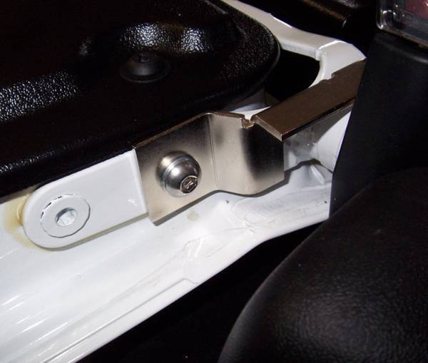

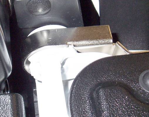

    I am lookin for that 10 sec tail gate stolen video posting here...dont find it...reason is i tried removing my tailgate and doest come off..dont see any clamp already in there...hence wonder how i can install the clamp if i buy one. !!
    Also anybody tried the above mod.........??????????
    by http://www.jimmijammer.com/GK description, 200810.htm

    open your tailgate about halfway and it will come off when you unclamp the cable.

    That clamp looks interesting. Do you have to drill anything or does it just screw in somewhere without drilling a new hole.

    I have what the OP posted in my truck, no drilling is required.

    the only thing i dont like about the one above
    is it doesn't go all the way around, preatty big opening
    so how hard would it be to just force it off?
    I would think its alot harder to break the Mcgard clamp.
    Doing both ????
    i would think it would be too much,
    would have to install the above
    and then put the Mcgard lock over it.
    maybe not enough room

    you'll destory the tailgate before bending the jimmijammer.
    You might be able to do the usual tailgate mod with the jimmijammer around it.

    Interesting. nice photo by the way

    Just installed the Gate Keeper. I tried to install it over a hose clamp but the extra dia from the hose clamp kept the Gate Keeper from seating and the mounting hole was slightly off . Looking at it I bet I could pry it off, but I won't try. I'll probably drill the hex out of the bolt to prevent the screw from being removed. One other thing is that stock screw was hard to get out. Had to put the tork bit in a 1/4 socket and use a rachet handle, when it "popped" I wasn't sure if the screw had come loose or if the bit had broken.
    I think one of those hose clamps with removable key would be just as good as this and those are 1/10 the cost.
