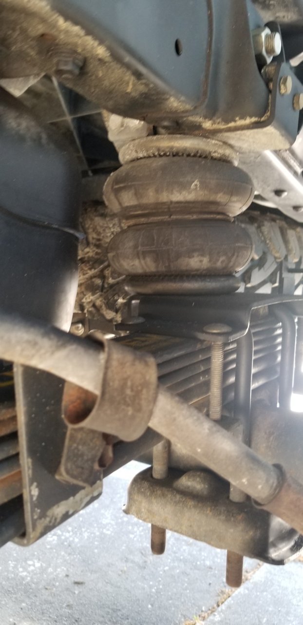

    SliMbo 4.0, my bumps stops appear to be fine and equally spaced from the frame as you and others have suggested. See pics. Also, the OME rear leafs appear in good shape as well.

  10. Apr 1, 2020 at 6:59 AM
    SliMbo4.0
    SliMbo4.0 Well-Known Member
    Dec 15, 2015
    #172322
    1,435
    Rick
    Colorado Front Range
    07 Tacoma DCSB TRD offroad
    BP51, BAMF hangers, BruteForce HC, SCS, Vagabond Drifter
    those look like air bags, not bump stops. maybe check that they both have the same psi
