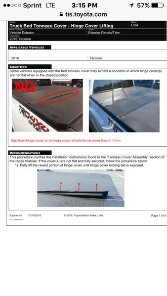

    Toyota also has a TSB concerning the rubber gasket that goes in between the folds of the cover. Might check with your dealer for it.

    No water leaks from recent torrential rain or car washes.
    Anyone have a TSB number or copy of the TSB mentioned in the earlier post?
    topher65001 likes this.
  19. Nov 2, 2015 at 1:25 PM
    #19
    Farmcat
    Farmcat Well-Known Member
    Jun 7, 2015
    #156935
    101
    Super White DCSB Off Road 4wd
    Doesnt really say anything about leaks. But here it is
  20. Nov 2, 2015 at 4:04 PM
    #20
    topher65001
    topher65001 Active Member
    Oct 20, 2015
    #167160
    32
    Denver, CO
    2016 Black Tacoma TRD Sport
    The top left photo is exactly what mine is doing. Looks like I need to be calling the dealer.
