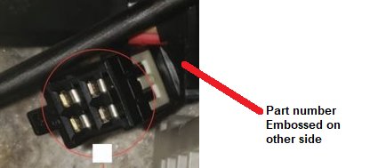

    If you find a way to get the part number to the connector, I could find a substitute one and you could de-pin it then add a mating set. It be four wires running from there to the bumper. The 2nd Gen has one but that square connector you have seems different. It might be the color.

    If you could fit a cell phone camera to verify the part number.

    I tried to get in there and get a picture, I may have to wait until tomorrow for daylight to get ones worth sending but the only number I could see on it was J4. But I will look closer with more light and less rain.

    Looking closer at the connector it seems a match to the 2nd Gen harness connector.

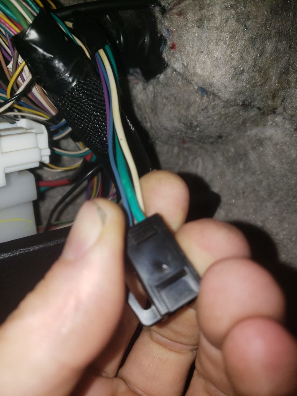

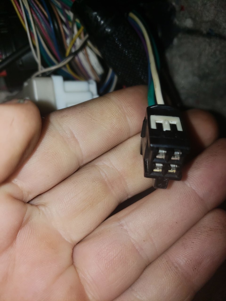

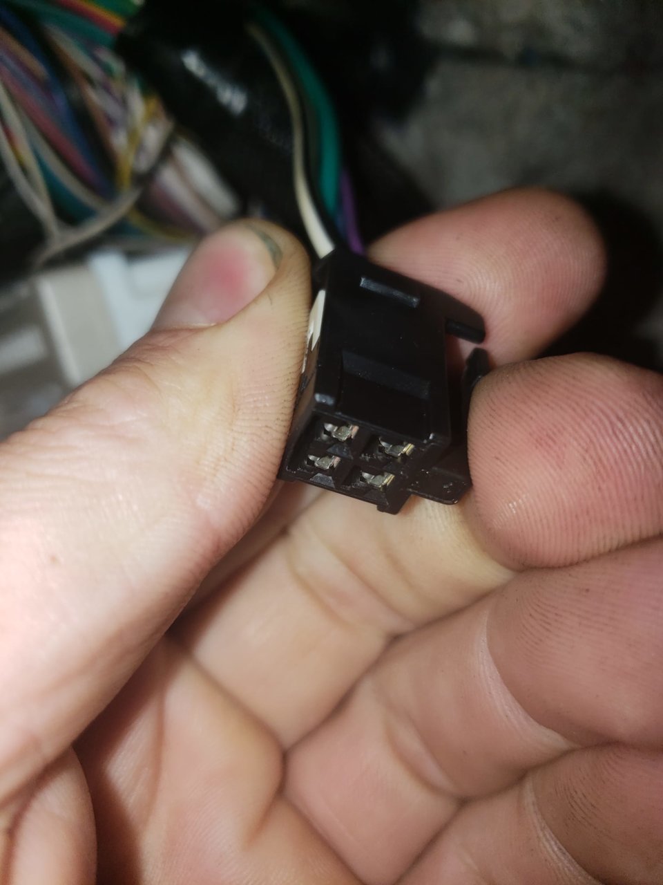

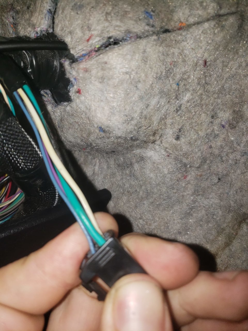

    sure that is my plan but what about the remaining 3 wires from the 7 pin. Also, I got a few more pics to help see if the 2nd gen harness fits.

    Damn, looks like no part number on it...:(

    I'd guesstimate that it is compatible to the 2nd Gen 4 pin towing harness...
    90% probable...

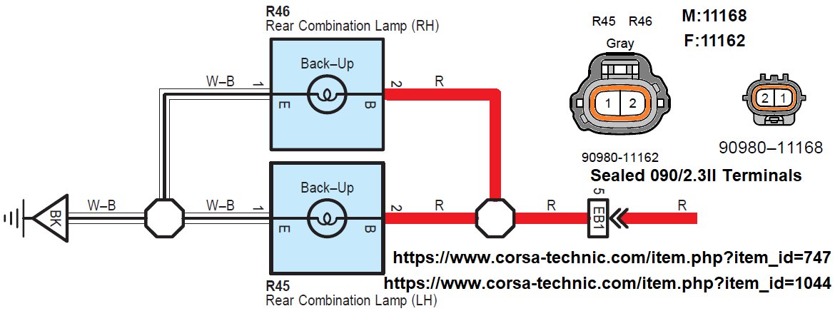

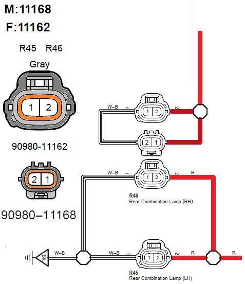

    Since it's not there and it has other circuits in it (DRL relay & Inverter relay) I would add a stand alone relay set. One to power the towing break, the other to power the trailer battery charger circuit. For the back-up (reverse) circuit, @daveeasa can sell you a modified harness that taps the rear lamp reverse circuit without cutting the OEM harness.
    Or you could assemble it yourself.

    Thanks caribe makaira for all of the great information. I may end up going with the Takonsha/ Curt Harness, the Reverse Lamp T-one from @daveeasa, then just install the brake controller with fresh wire. cheers y muchas gracias.

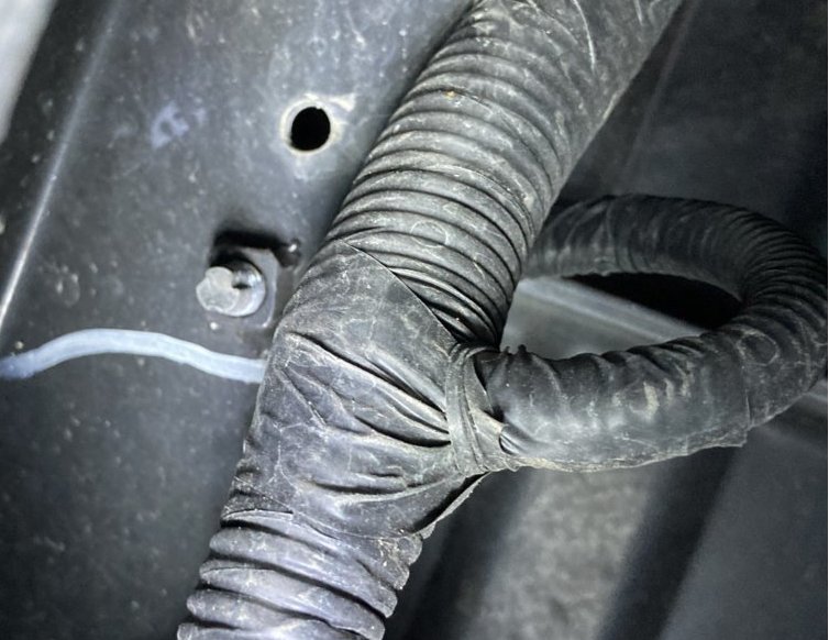

    Yes, it be easier to set up a pair of weatherproof relays on their own, then acquire the missing relay box and have that wired into the main relay/fuse box.
    There is a chassis ground point on the rear driver's side. There even is an extra hole where you could add an additional ground.

    So you'd only need one weatherproof relay added, and a hot fuse for the towing brake module.
    Towing Brake module requires ground, tails, battery fused power, brake input.
    T harness for the backup (reverse) lamps.

    @caribe makaira I have found the part number! I sure hope it will fit the gen2 harness!! looks to me like it is saying, part no. 11766 WhatsApp Image 2022-07-10 at 9.30.06 AM.jpg
    Also, is this harness something you would sell to me? I would be happier to make a sale with you over Amazon.
