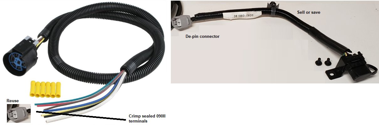

    Would you agree this is the same harness? Only, I see an extra part, is that a relay or converter?
    https://www.amazon.com/dp/B0057Y0WM0

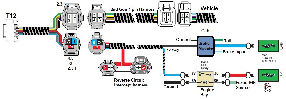

    Look what I found:
    I'd say get the Amazon one. If something went wrong years down the line, the 2nd Gen towing converter can be adapted to function if the Combination Meter PCB fails.

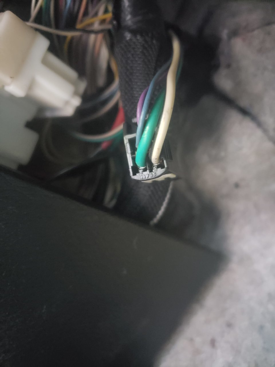

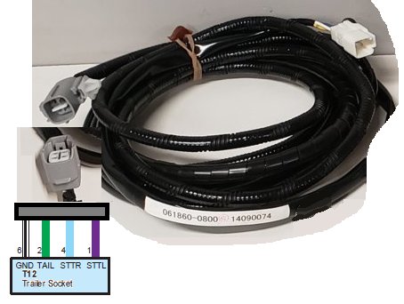

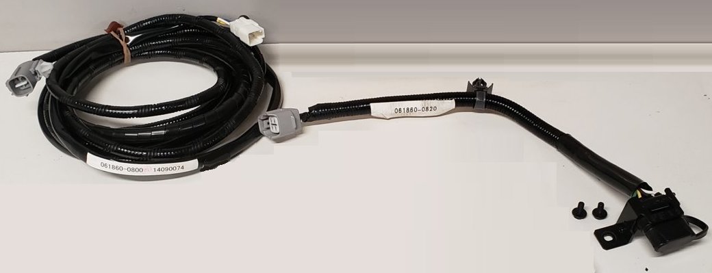

    So, we can confirm that the 11766 part numbers are compatible?
    The extra towing converter would not be necessary to use with the Tacoma's on board 4pin system?

    Nope, on the 3rd Gen it's integrated/part of the Combination Meter PCB.

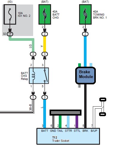

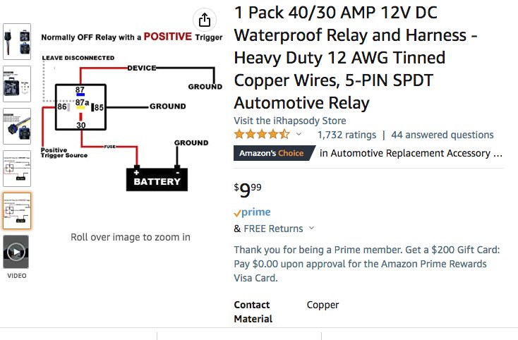

    Leading to another question/clarification,
    Is this needed inline to run 12v power to the 7pin? or will I use just an inline fuse(EDIT*) auto-reset breaker, 30amp? I am now feeling like I am overcomplicating things.

    This:
    which you posted as a part you'd get has the 4 pin integrated...one side is 4, the other is the 7

    For the Towing Brake Module, the power source should be a fuse.
    For the Trailer Battery Charger Circuit the auto reset breaker is fine.

    AWESOME! I have a 10 amp fuse on a fuse tap with my used controller, and the breaker is in the mail.
    I ordered this part and was hoping I could just use the harness and throw out the housing from said part curt trailer adapter.

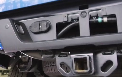

    The bumper can be cut (Plastic). If you look under the Taco you can see the metal has a hole where the OEM trailer connector would go.

    Suggestion on attaching, but whatever you decide. Keep it weather proof, loom the wires, secure from movement and chaffing.
