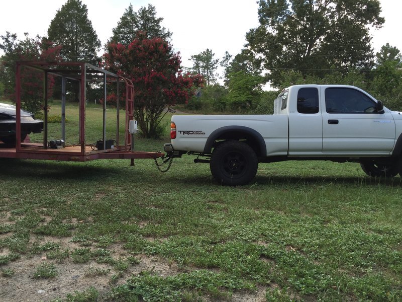

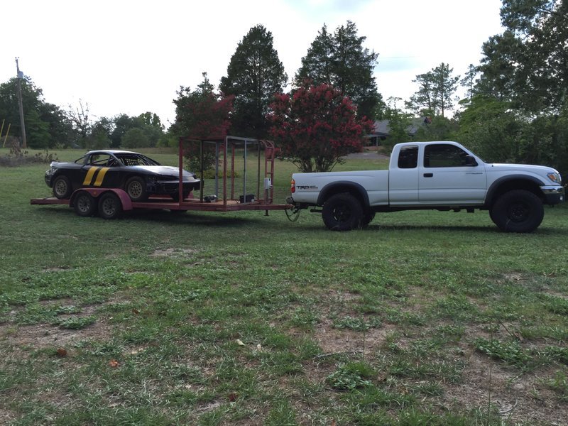

    Few pictures:
    The truck is on an incline and the trailer is on a decline so it makes it look worse in the first picture.

    I have both an 85 pickup, and a 98 Tacoma w/ V6 & 5spd. Niether one likes towing even weights down around 3K. I agree with the others, you will eventually kill the taco, if it's just a local track, it may take awhile but eventually you're going to want to go farther afield. Better option is keep an eye out for a full size 2wd 3/4T or so tow vehicle diesel preferably. I hauled a 3/4 t 84 full sized chevy 2500 miles withbtrailer behind my Cummins and averaged 14.5 mpg, and adequate power for any hills on my route.
