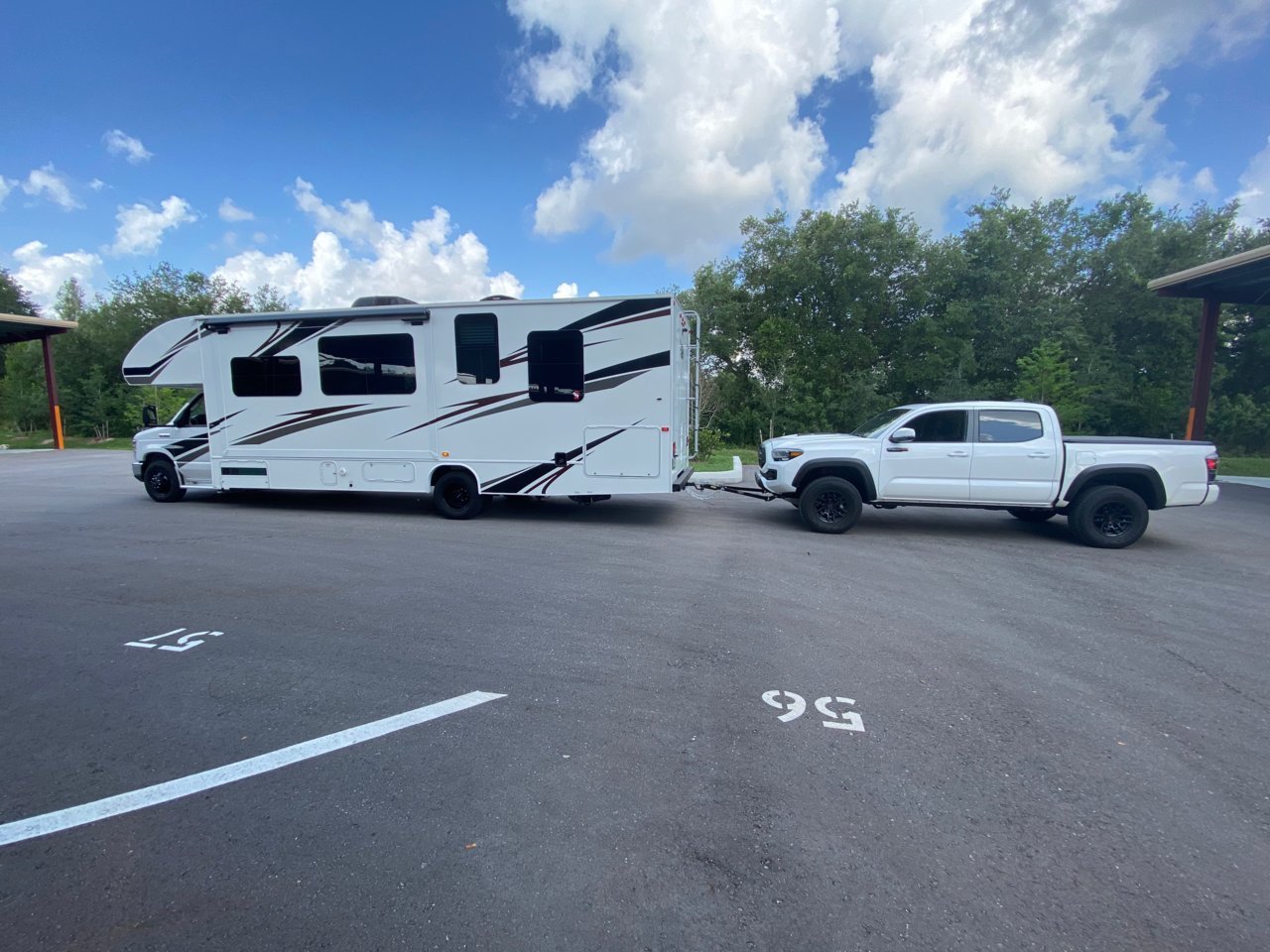

    I've gone in the opposite direction.
    Stuart762, Tocotwo, Junkhead and 2 others like this.

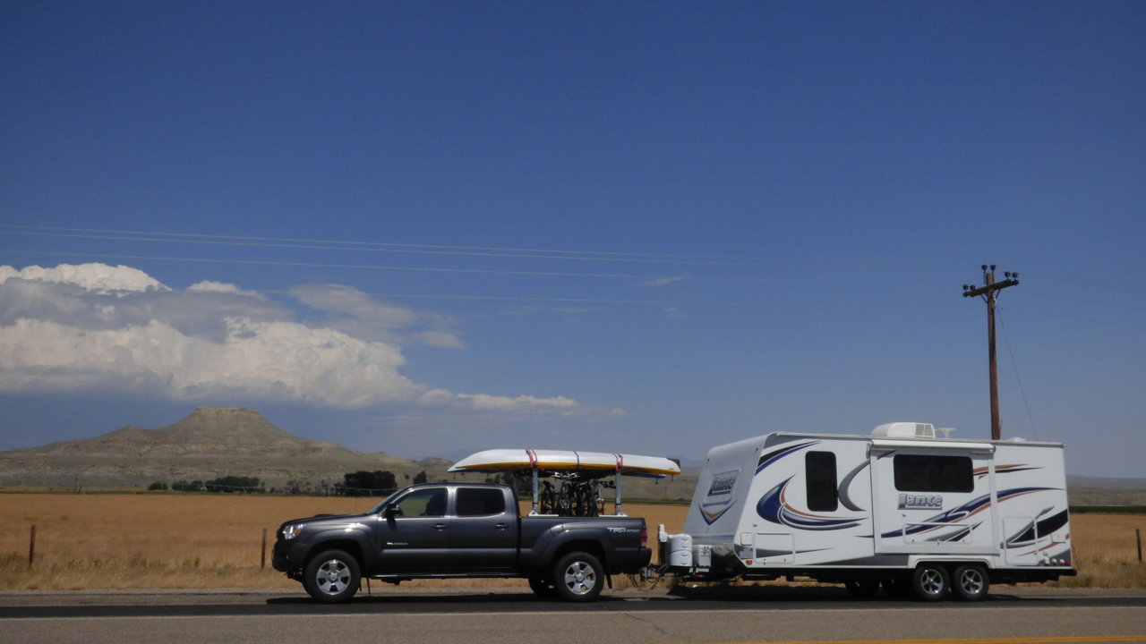

    P1040263.jpg My Lance is 4,200 lbs dry, probably add 1,000 lbs or so especially once the beer and wine are loaded. We do trips to New York Adirondacks and to Cape Cod which both involve hilly terrain. We also did a long trip trip out west traveling to Rocky Mountain, Grand Teton, Yellowstone, Black Hills. Over 4,000 miles and no problems with the Tacoma. When towing I always drive in 4. RPMs 3500-4500 going up hills, otherwise about 2500, maintaining speed of 65 mph, but slow down if there is a stiff wind. 10-11 mpg. Getting a 2021 later than month and planning on doing another trip this summer going back to Black Hills, Yellowstone and then to Glacier. Will post how the new Tacoma performed when I return.

    @KnobleOne
    What is your setup? Wdh? Break controller? Suspension mods?

    Andersen WDH, Prodigy break controller, Firestone air bags (inflated to 50 psi)
