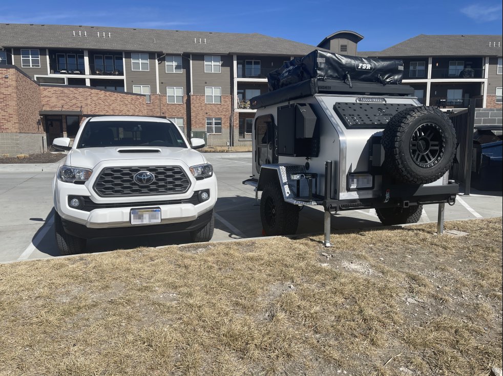

    The truck will most definitely do the job. I regularly tow 3500# off-road trailer. My recommendations:
    • A trailer brake controller - I use Redarc's Tow Pro Elite since they make a plug and play harness for the TRD tow package. This is necessary as every state you will be driving through (IIRC) mandates trailer brakes for your size load.
    • An OBDII monitor like the scan gauge two to monitor your trans temps (TP1 coming back from the cooler and TP2 going out of the Tq converter) - this is optional of course but I wouldn't want to tow without being able to see, in real time, how my temps are changing as driving conditions change
    • Drive in S4 and with ECT PWR mode to change the shift points. On the freeway be cautious of S5 and S6 OD gears as temps can get dangerous real quick -- read the towing bible linked below for more on this
    Please leverage the search function, a derivation of the question "I'm looking to tow ______, will I be able to?" gets asked every couple of weeks. Threads that may be of interest:
    My rig: 2022 Vorsheer XOC (3500 GVWR - 2800# pictured here)

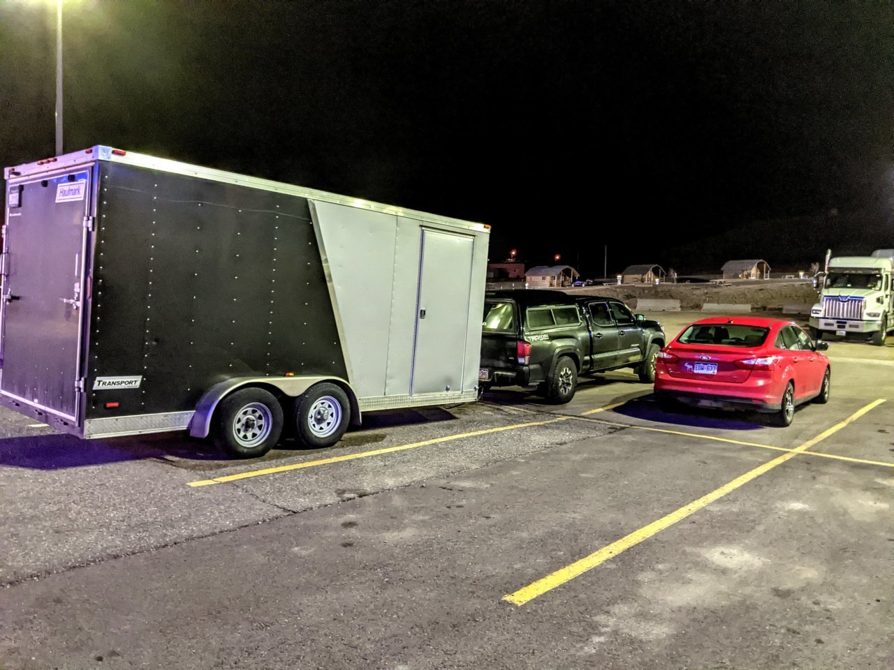

    I towed a 5,000-ish pound trailer from Colorado to Alaska. Drive smart, and you should be fine. I'd recommend two things though:
    1) Install a brake controller if the trailer has braking capabilities. It's pretty simple. I installed this one, and it worked just fine: https://www.amazon.com/Reese-Towpower-8508211-Proportional-Brake-EVN/dp/B01M59QRWK/ . You also have to get a relay to plug the controller into an existing plug in the truck.
    2) Get a quality tune. My favorite one, especially for towing/hauling, is Overland Tailor; but really any good tune will make a huge improvement.
