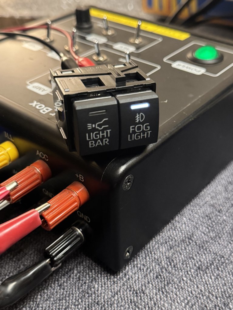

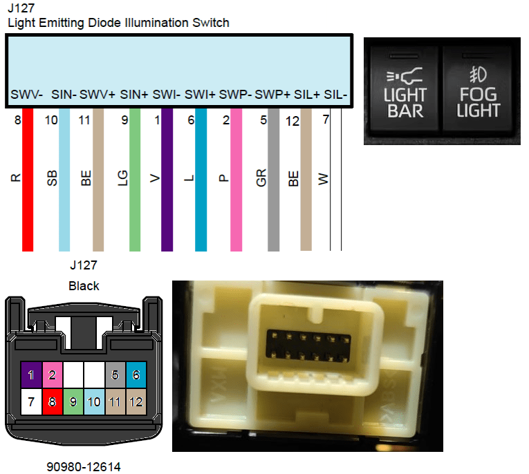

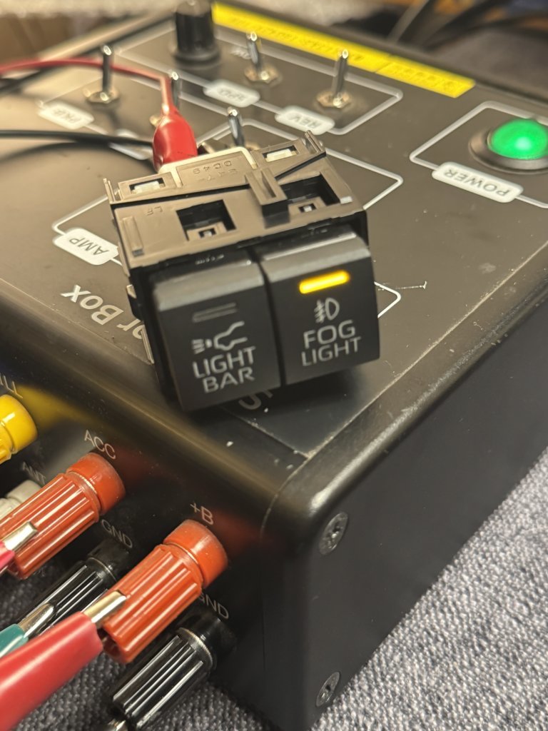

    With some bench testing, color switches when reversing polarity PIN 1+6

    Can’t figure PIN 3 and 4 yet

    3 & 4 not used.:rolleyes:

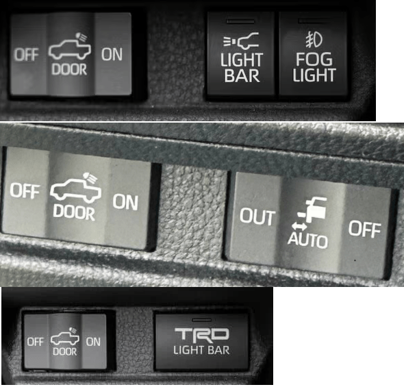

    @Siblue do you have the part number for the Trailhunter switch in your photos? I thought it was PT45A-35240-TH but that got me the single lightbar switch from the Pro instead.

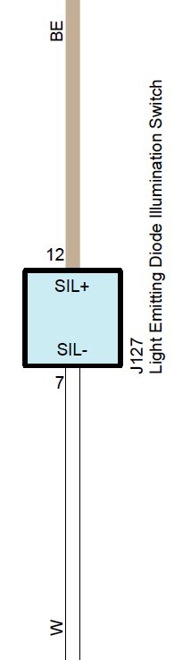

    I found 7 and 12 to be white backlit illumination

    Toyota really screwed up the PN translation.
    PT45A-35240–PR is the Trailhunter switch

  12. Feb 8, 2025 at 1:49 AM

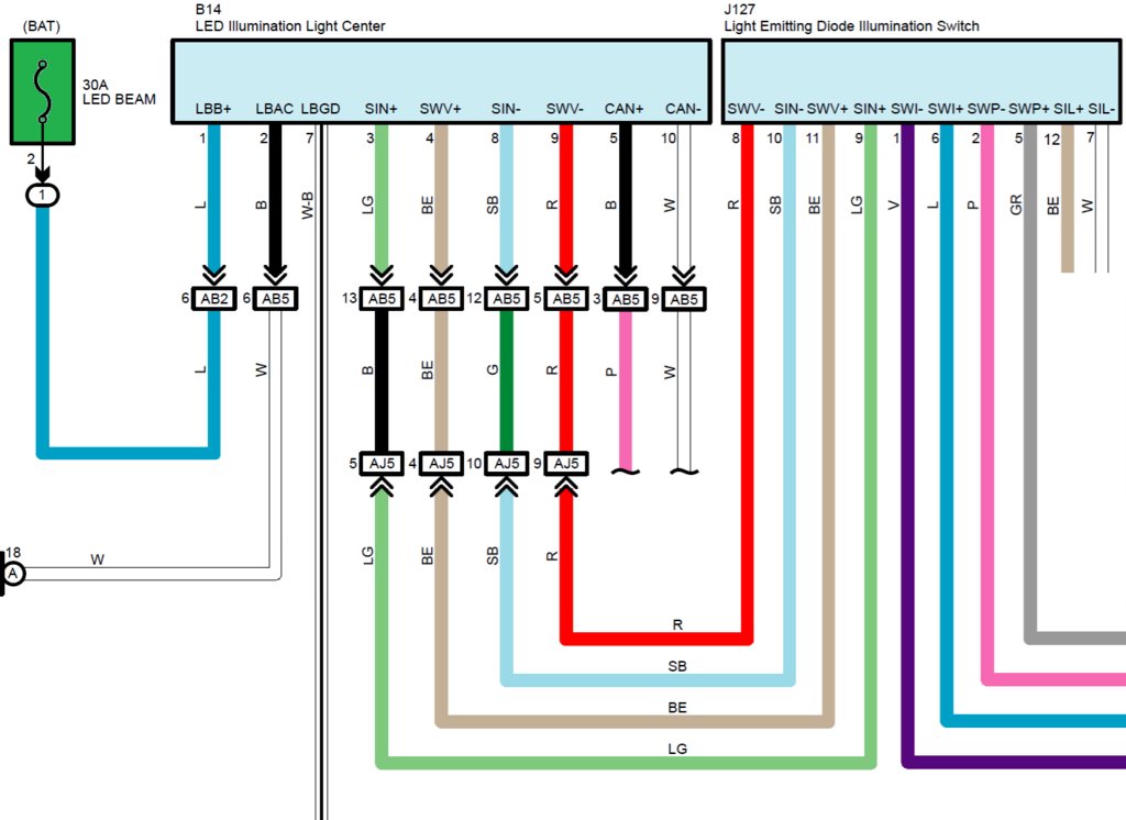

    Yup, got to update the pin info drawing, thanks!

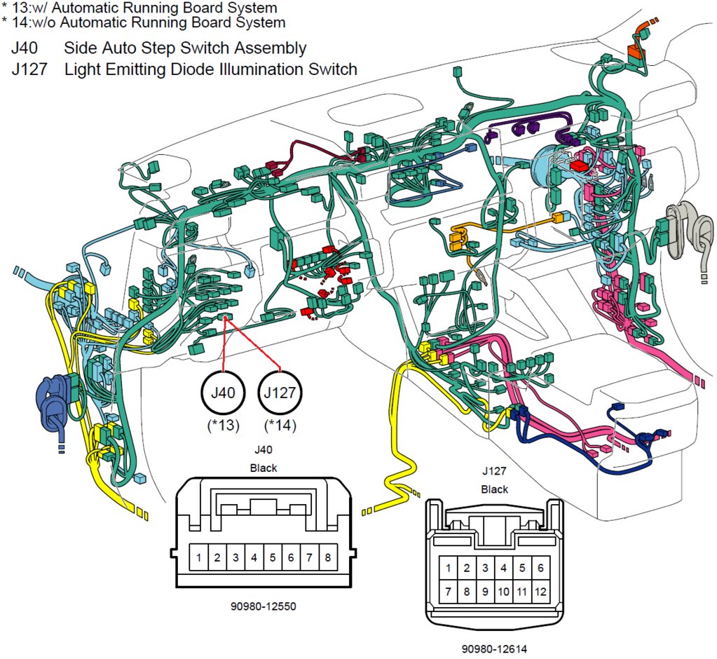

    Had been one of my hopes, but on the Limited trims, the automatic step rails occupy the same dash spot and there are no unused doubles.

    And if Taco has one it does not provide for the other:
