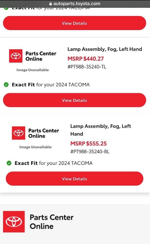

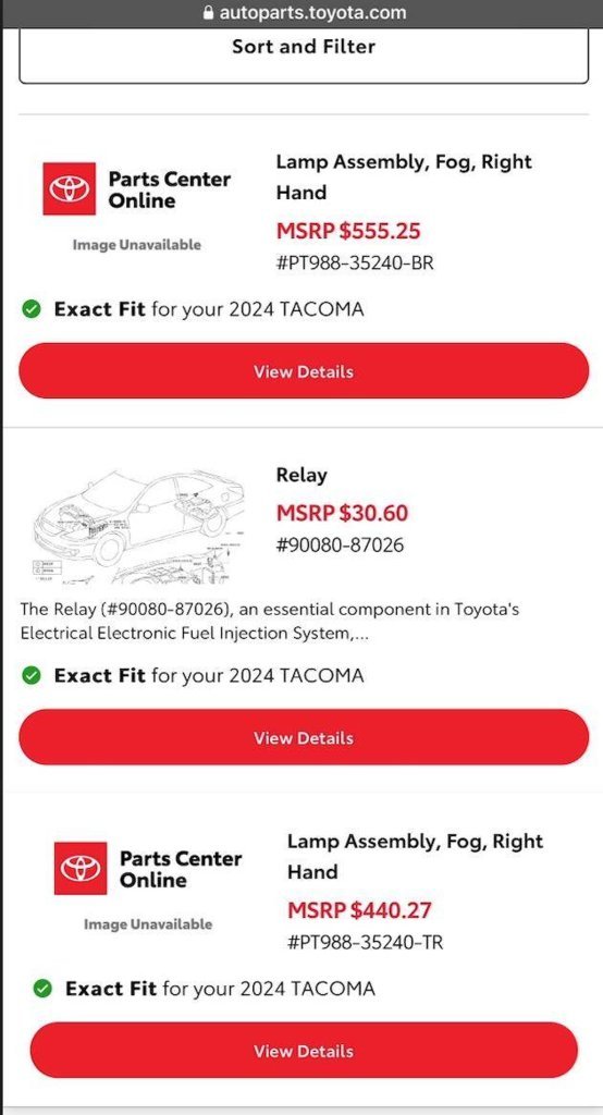

    So here's a small bump for the thread, I was in the parts department at my dealer and asked for the part # for the fog lights in the TH. They gave 81220-YY030 left hand, and 81210-YY030 right hand. Now here's where things get interesting.
    In another thread a TH owner said they had two options for foglights when looking at the app, part #'s were pt988-35240-br and pt988-35240-TR
    So with that info we are left with a 50/50 chance guess and who knows what the BR and TR stand for, could order both but cannot test the switchback function without the proper wiring and remove the front.
    But there's more!

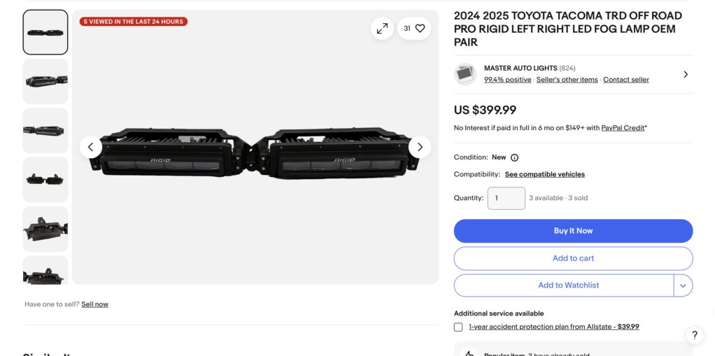

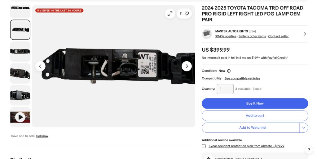

    I searched on eBay and found the part #pt988-35240-br, which are the OEM rigid lights BUT they are showing part# 81220-YY080 and 81220-YY070
    But I asked the seller if these were the switchback versions a they said yes. Again not something I can easily test without the switch or taking off the bumper.
    So this leads me to where I stand, part # pt988-35240-TR MAYBE the switchback foglights, but cannot tell without ordering and testing. The easiest way to confirm would be if a TH owner took a photo of their foglights when their bumper is off and we could confirm.
    Also have to find the wiring for this, for models that came with non Rigid fog lights from factory.

    Using autoparts.toyota site you cannot select a 24 or 25 Tacoma Trailhunter or pro.
    However, you can select a 25 4R TH and part numbers ending in TL and TR will populate.
