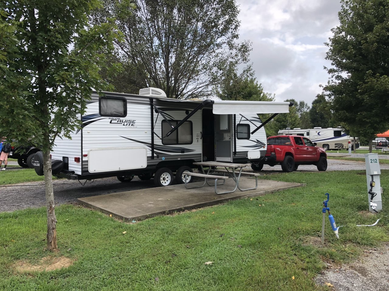

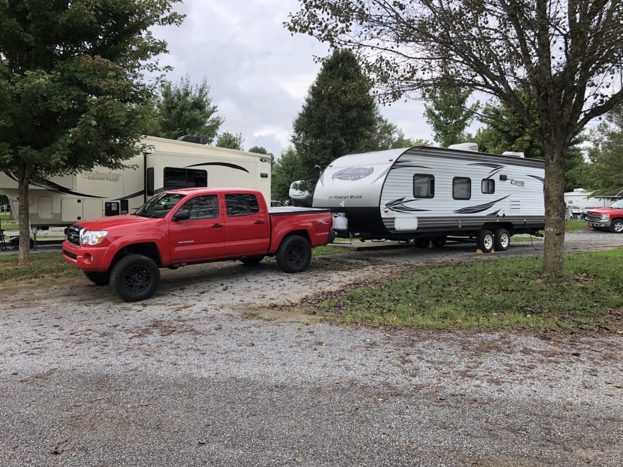

    Well the first time i used my Taco to pull the camper was due to my 6.0 Powerstroke being at the shop and we were just going to the local state park (about 10 miles away). I didnt take the time to adjust the weight dist hitch and the truck seemed to struggle.
    This time the 6.0 is down for repairs again. RME! We went from Jacksboro to Sevierville, TN (about 66 miles). The Taco, of course could not accelerate like the 6.0 and it seemed to sway and porpoise a bit more than i was comfortable with, but we arrived with no issues. Hooking up this morning to head home, i decided to tighten the bar chains one more link and it made a WORLD of difference! The porpoising and swaying is gone! Granted, i still got some of the sway from passing semis, but the 6.0 F250 experienced that too.
    All in all i am feeling alot better about towing with my Taco. I figured this may help someone else.
    My truck is an 05 dcsb 4.0 auto trd or. Ive got a Mobtown Offroad rear bumper and LOVE it as well. It has the hidden (behind the tag) reciever. The camper is a 26’ Salem Cruise Lite by Forest River. Aprox 6000-6500 lb rigged out (as towed). I held 4th gear most of the time and maintained 60mph fairly easy. Some of the hill lost speed to as low as 45.
    All in all, if i were to add a set of Firestone airbags and flip out towing mirrors, this truck would be just fine. A supercharger would be nice too, but not really a “need”.

    Seems like you might be on the edge of the Tacoma's towing capacity with a tow package. 10 miles may not be a problem but would not do that size trailer on any long trip.

    So many people here claim the Tacoma isn't able to tow more than 3k lbs safely but the reality is, it is more about the comfort of the driver. The Tacoma is fine right up to the tow capacity with a capable driver.
    Our setup is about 1k lbs lighter than yours but we drag it on long trips all over the eastern Sierra. You just can't be afraid to make the truck work.

    I'd refer to your trucks specs for Gross weight for truck and tow ratings ECT, hit a nearby truck stop, weigh both your truck by itself then with camper and see where your at. It's simply for the safety of yourself and others.

    There's a bit more to it than simply driver confidence...
    There is a large difference between a truck being able to competently tow a load, and the truck simply being able to "pull it just fine." I was using my 4cyl Tacoma for a landscaping truck all summer. Even with 1 cu.yd. of mulch in the bed (estimated 400-800lbs based on moisture content), the truck would squat a concerning amount. Rear squat down, and front nose would raise a bit. Brand new leafs from Toyota in March, btw.
    The 4cyl motor would pull no problem, but the brakes were significantly underpowered.
    I also pulled a small 5x8 utility trailer for the last ~6 weeks. One time I made the greedy mistake of putting 1yd mulch in the bed, and 1.5 yds in the trailer.
    so 2.5yds x (400-800lbs) +350lbs trailer weight. Any way you cut it, it's still under 2500lbs and the 4cyl has a towing capacity of 3,500. The truck was quite sketchy at this point, and I kept visualizing (Final Destination style) of some dumb car cutting me off, and not leaving me enough room to brake.
    I had to change my driving style significantly to mitigate unnecessary risk. I stayed 5-10 below the speed limit at all times, I had very diminished braking capacity, and my steering was affected.
    Additionally, the shorter wheelbase you have, the worse the truck will tow.
    I'm very inexperienced with towing, but I still can't imagine adding 1000+lbs to that trip, to push the 3,500 towing cap. of the 4cyl.
    I also can't imagine doubling (or tripling) that load with a v6 truck. 6,500lbs is far more than the truck itself weighs, mind you.
