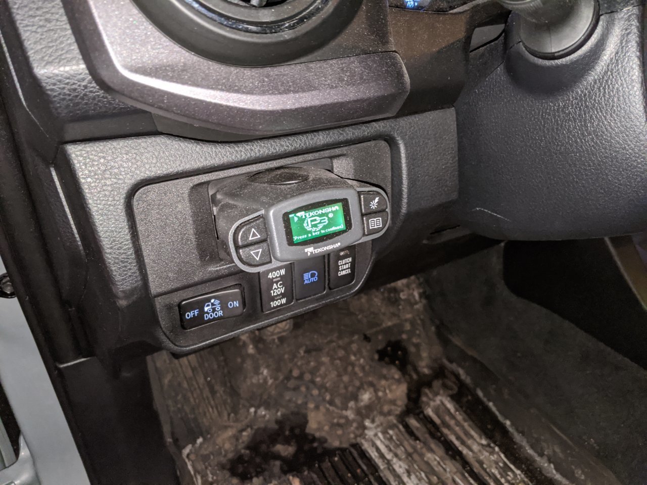

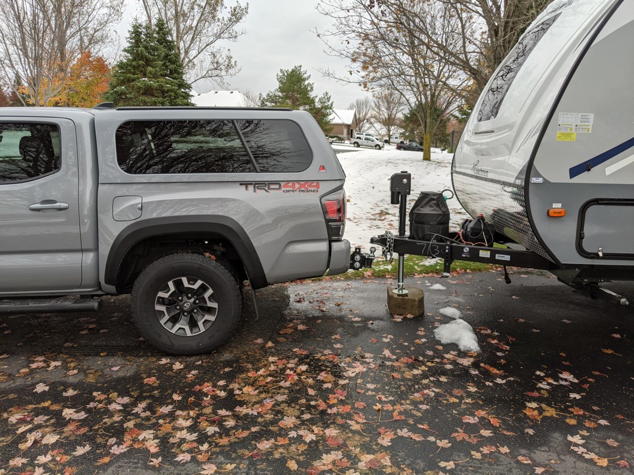

    A bit of background before I start this post... I previously had a 2019 Sport with a Tekonsha P3 brake controller. I had the Toyota dealer's vendor install the Tekonsha P3 when I bought the truck and not only did they cut the wiring harness out and direct wire it, but they did it wrong! I found that out when I picked up my new camper (Apex Nano 208BHS) in the spring of 2019 and hooked up the trailer electrical connection. The P3 got REALLY hot and didn't recognize anything was connected. Like burning hot! Luckily the guys at the camper dealer also sold that controller, so they took a look, saw the bad wiring job, and were able to fix it for me. It looked like everything was working from that point on, as it recognized the trailer connection and didn't get hot, but it didn't really seem to do a whole lot in hindsight. Also I had AirLift airbags put on the truck by the same Toyota dealer vendor and they never really worked, didn't really hold air well, and completely failed before I even got to try them with my camper. So while I technically had them on there, for all intents and purposes they weren't and I just had stock suspension.
    For reference, here was the Tekonsha P3 in the 2019:
    Fast forward to this year, I now traded in my 2019 (because I didn't want a truck with the above and other screw ups) for a 2020 Off-Road. I, myself, have installed two components I'll talk about here.

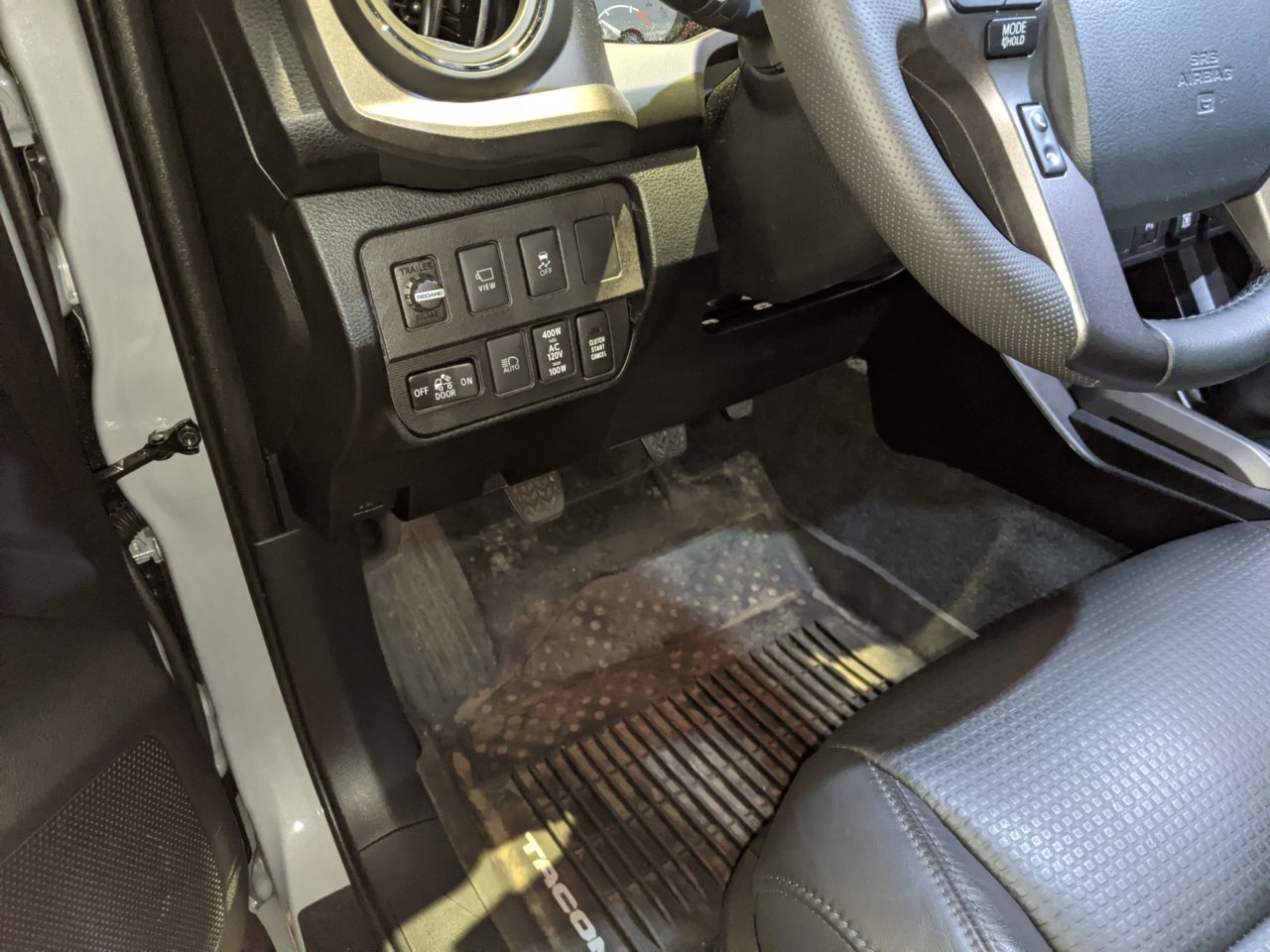

    First, due to the left side panel changes on the 2020 (added the buttons for traction control and 360* camera where the cubby used to be), I couldn't fit the P3 anymore and so instead of moving it to the new truck I got a Redarc Tow-Pro Elite and put it in. (The Redarc also looks much better, in my opinion!)
    Here is the Redarc in the 2020 (using a @MESO custom panel and a special mounting plate made for the Redarc):

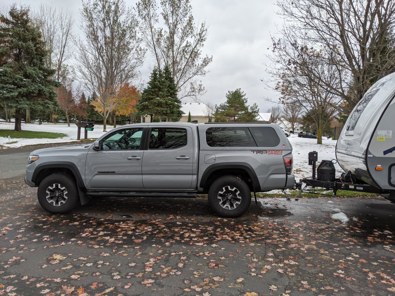

    Second, I wanted something low-to-no maintenance and with no worries of leaking, so I went with the SumoSprings black 1000# bumpstops. I figured with a topper (the previous 2019 had an OEM tonneau) and the trailer, I wanted a little more than the blue 500# ones, so went with 1000#.
    So, due to covid and other crap this summer, we only made it out camping once this summer and that was back when I still had the 2019. So I hooked the Apex up on Friday, for the first time with my 2020, to bring it over to be winterized. While hooking it up I wondered how squat would be affect by the SumoSprings, so I tried it with and without the weight-distributing bars hooked up. In case anyone else is interested on their effect on squat, here you go!

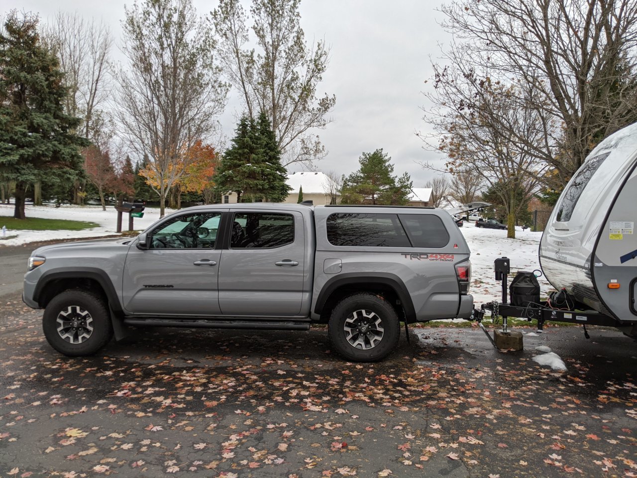

    Just before hooking up. Only weight on the truck suspension is the topper:
    Hitch connected with full weight, jack retracted off ground/brick, and no WD bars:
    As you can see there is a bit of squat in the rear, but not nearly as much as without the SumoSprings. On my 2019, the rear end would be bottomed out and the front way up when I did this of course.

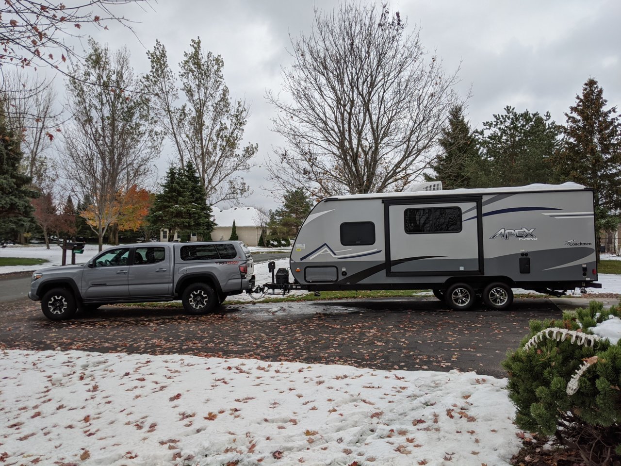

    For comparison, here it is hooked up properly with the WD bars on:
    If I was really on the ball I would have measured it as well. I have to hook it up next week and bring it to winter storage, so maybe I'll try to do so then, if there is any interest.
    Of course with the weight of the trailer I believe it is engaged with and solidly sitting on the SumoSprings (it very nearly does with just the weight of the topper), and I have to say I think it helps with drivability. It doesn't feel as squirrelly since the back end can't shift around as much, or at least that is how it feels to me. Not that it was that bad before, but I think there is a definite improvement!
    Circling back the to the brake controller thing, I also noticed MUCH more engagement with the trailer's brakes. When I hit the brakes I could really feel the trailer slowing down and pulling on the truck! I never really could get that with the P3, even turned all the way up, and now it is making me think maybe the bad wiring fried the P3 and it might have never really been actually working properly.
    I know some people are against towing much of anything more than a wet fart with our Tacoma's. While I thought it was OK with my 2019, I could see why some weren't comfortable with it, especially a brick wall like campers tend to be. But with the improvement of the SumoSprings (or bags if that is your thing, I think they'd be similar) assisting the suspension and what seemingly is a much more functional brake controller, I feel totally confident in my Tacoma pulling this ~4000lb trailer!
    Really hoping we can get out for many more trips next summer, including some longer extended ones!

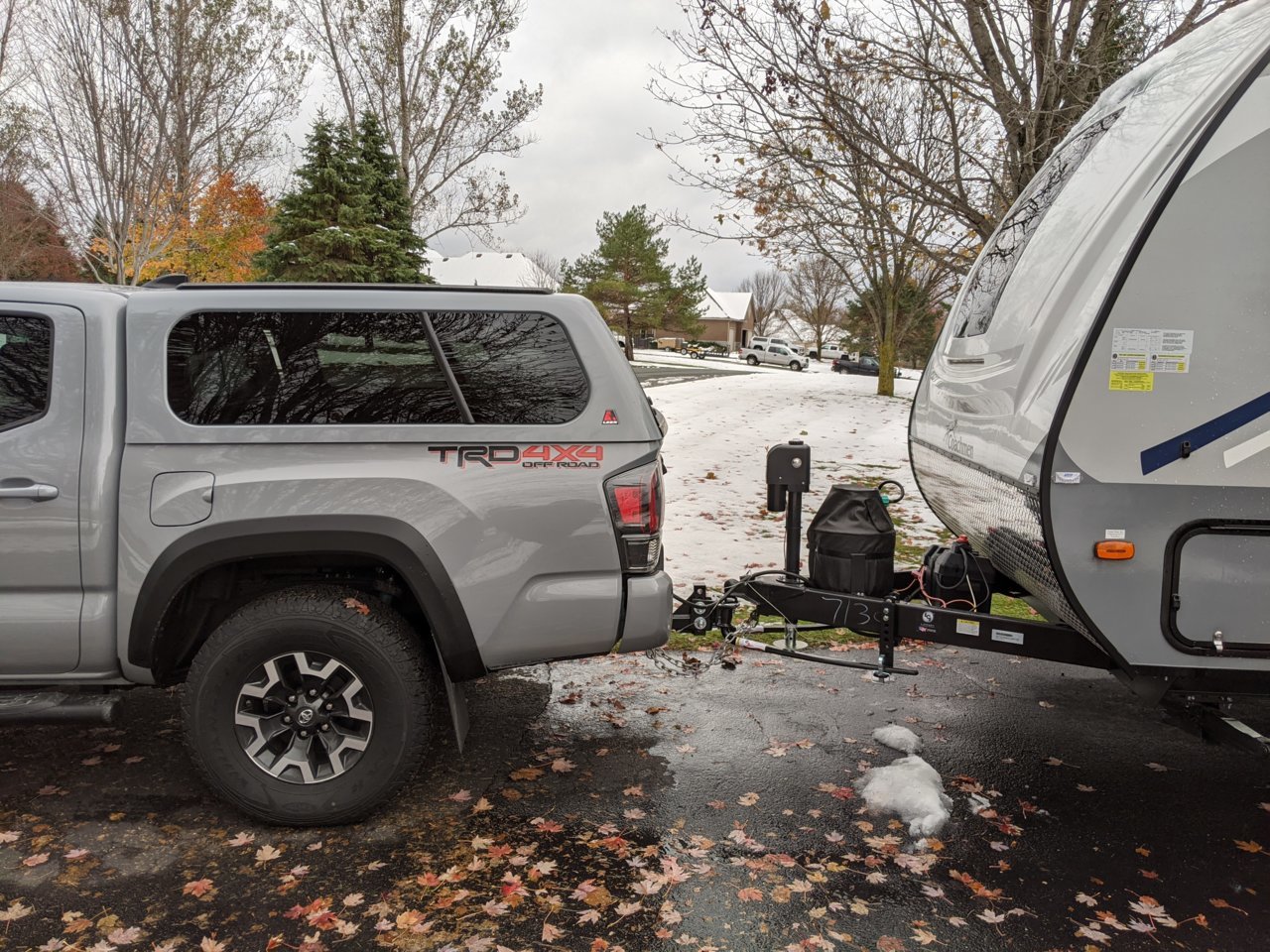

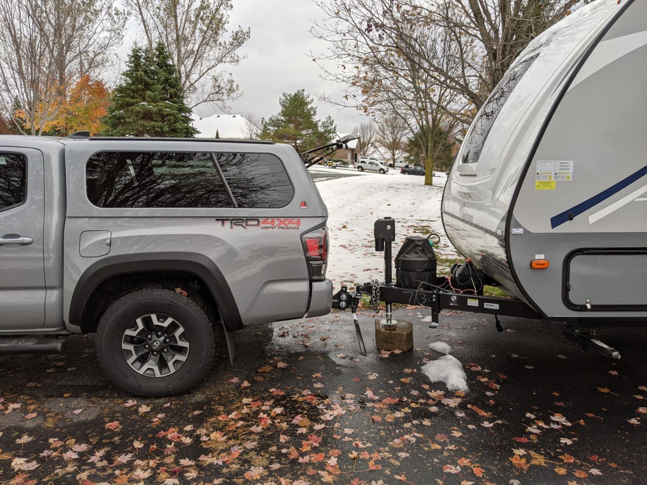

    Brief update if anyone is interested... I pulled my camper to storage over the weekend (technically Friday) and remembered to measure as I was hooking it up this time!
    You can see in my previous post, but just a reminder I have a 2020 Off-Road with stock suspension, SumoSpring bumpstops, and a Leer 100XL topper. With just the topper on it just barely is NOT on the SumoSprings.

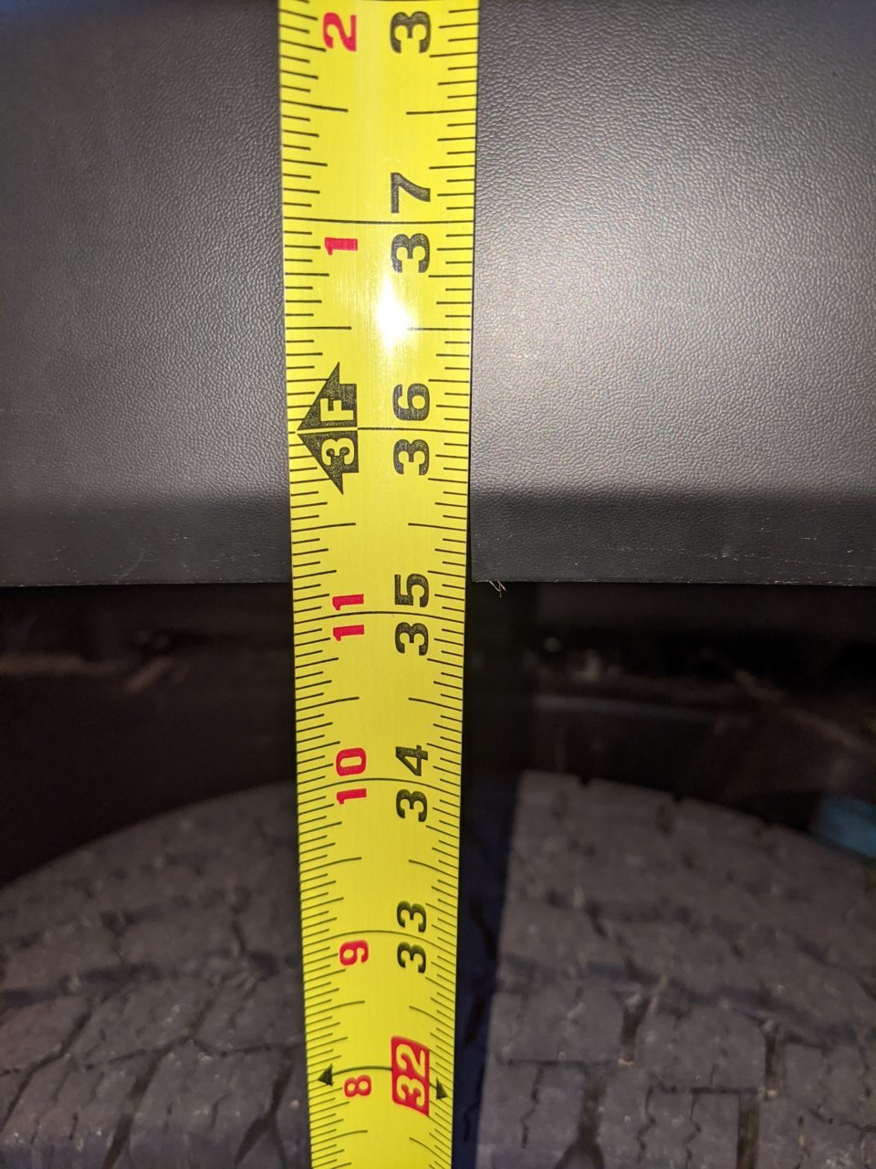

    With just the hitch in the receiver but no trailer weight on the truck, I measured at 35 1/4":

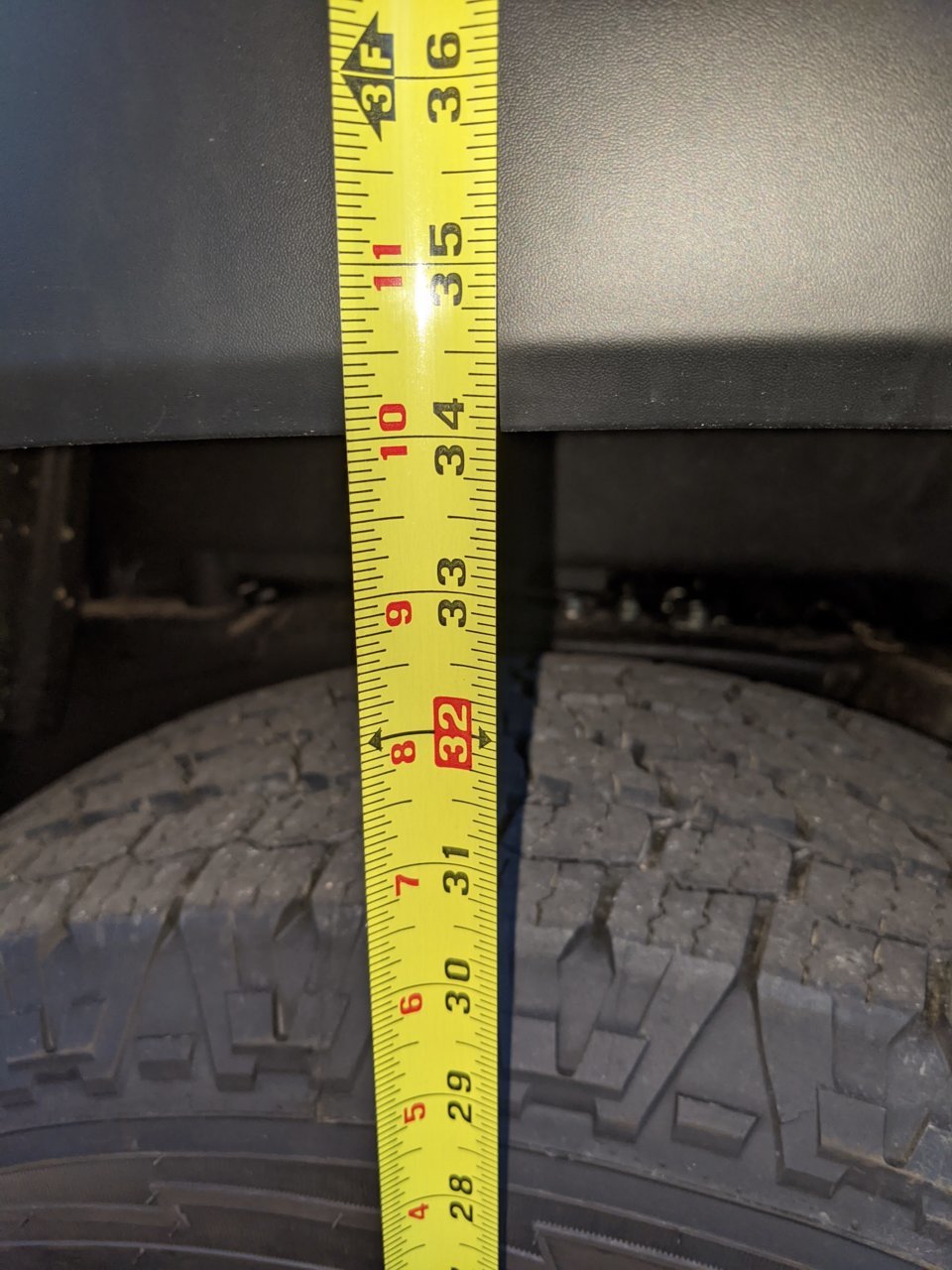

    I put the trailer on the hitch but did not connect the weight distributing bars and raised the jack until it was off the ground. So this is on the stock suspension + Sumos. It measured at 34" even:

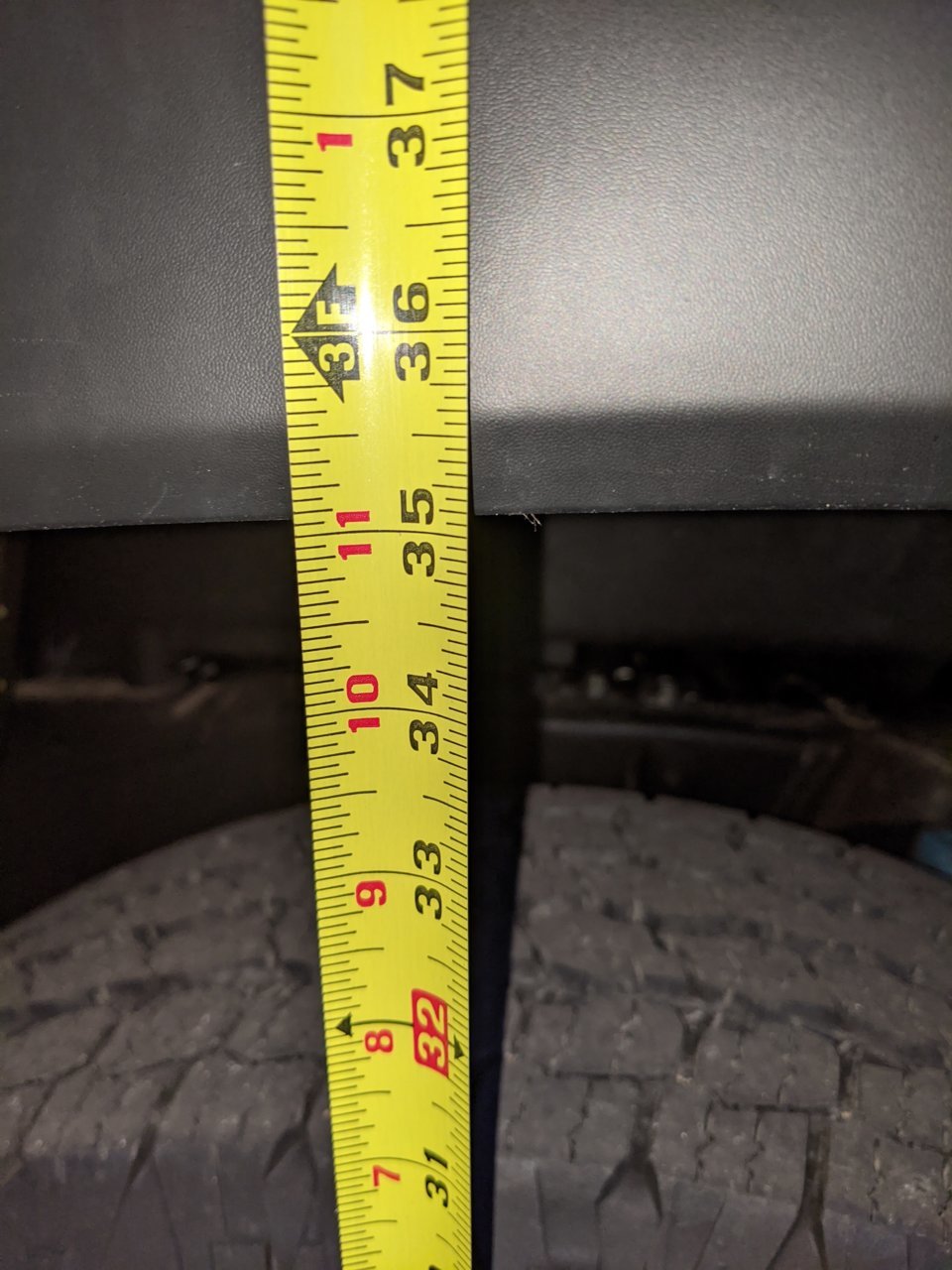

    I jacked the trailer back up and reconnected it this time properly with the weight distributing bars. Again after it was hooked up I brought the jack up off the ground so the weight was fully on the truck. With that configuration I measured it at 35 1/8":
    So there you go! The WDH still makes a very big impact, even if you have something like the SumoSprings installed. I didn't expect them to be a replacement of course, but they do help I think in a couple regards. It feels like it gives more stability on the road, possibly because it is a more direct "connection" between the frame and the axle. At least that is what my butt dyno tells me. Also, it does help some with squat when not using the weight distributing bars, such as when I'm backing it up since I generally remove the WD bars for that if any significant turning is required.
    After it was hooked up I brought the camper to storage. See you next spring!

    @deusxanime, I wonder if that 1/8 inch difference between the measurement without the trailer and the one with the trailer and WD hitch was just tire deflection? If you measure from the center of the hub instead of the ground it will give you a more accurate look at what the suspension is actually doing.
    I measured when I was setting up my hitch and I was exactly the same for unloaded and with the trailer hitched and WD hitch set once I had everything adjusted.
  9. Nov 2, 2020 at 10:32 AM
