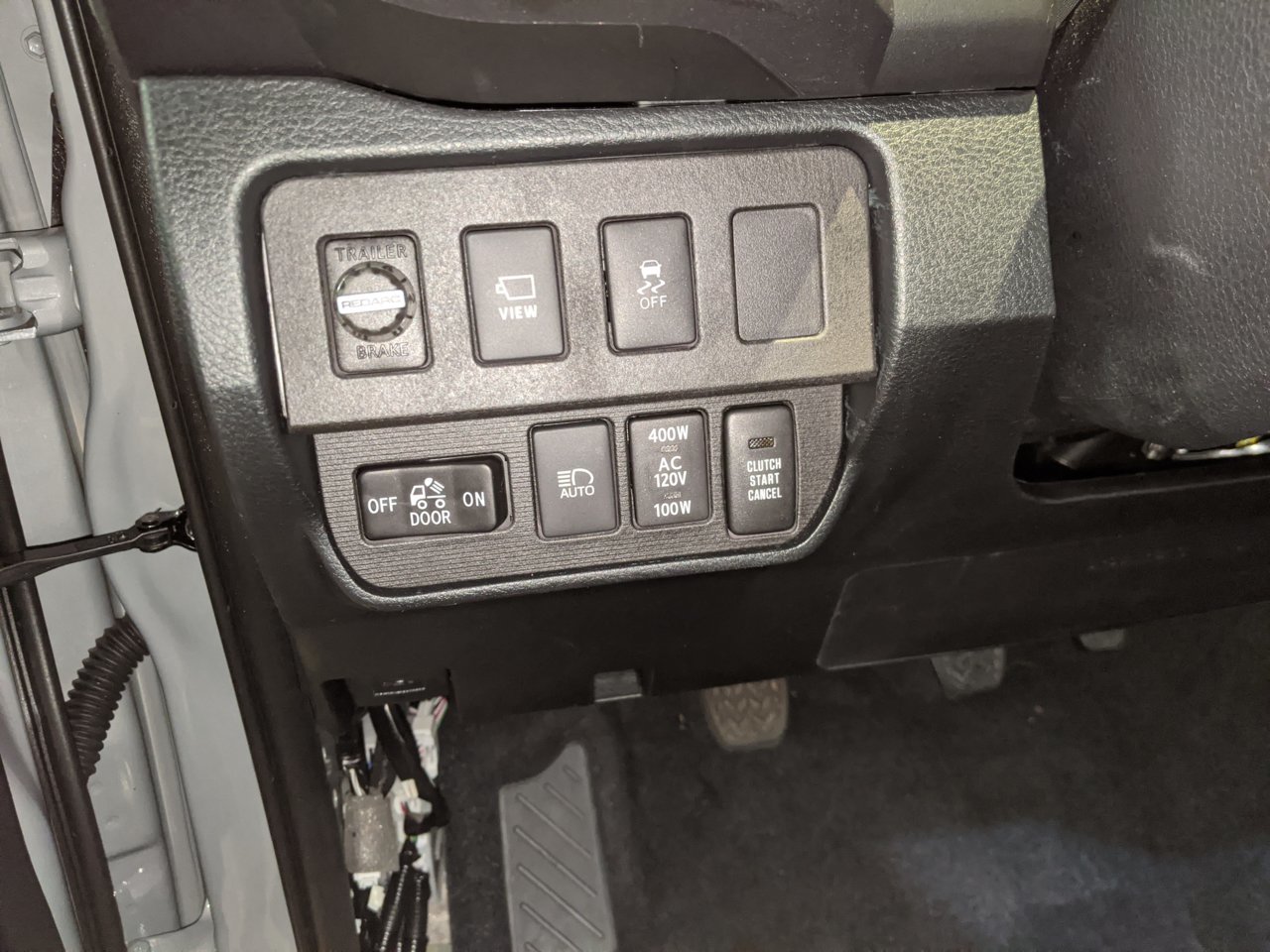

    The wiring is there, but you need a device to actually run it. There is a harness behind the driver's side kick panel you can plug one into.

    Yep.... prewired for a controller, but it doesn’t come stock like some of the big boys. My favorite is the redarc, super clean install if you get the right parts. Tekonsha is another really popular controller.

    I went with the Tekonsha Primus IQ. Install was super easy, just needed to order the harness for my truck, and now I just need to get the settings entered.
