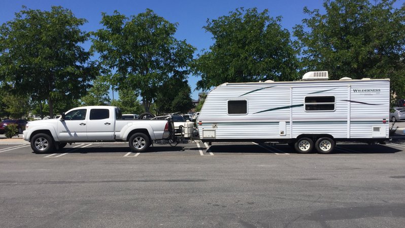

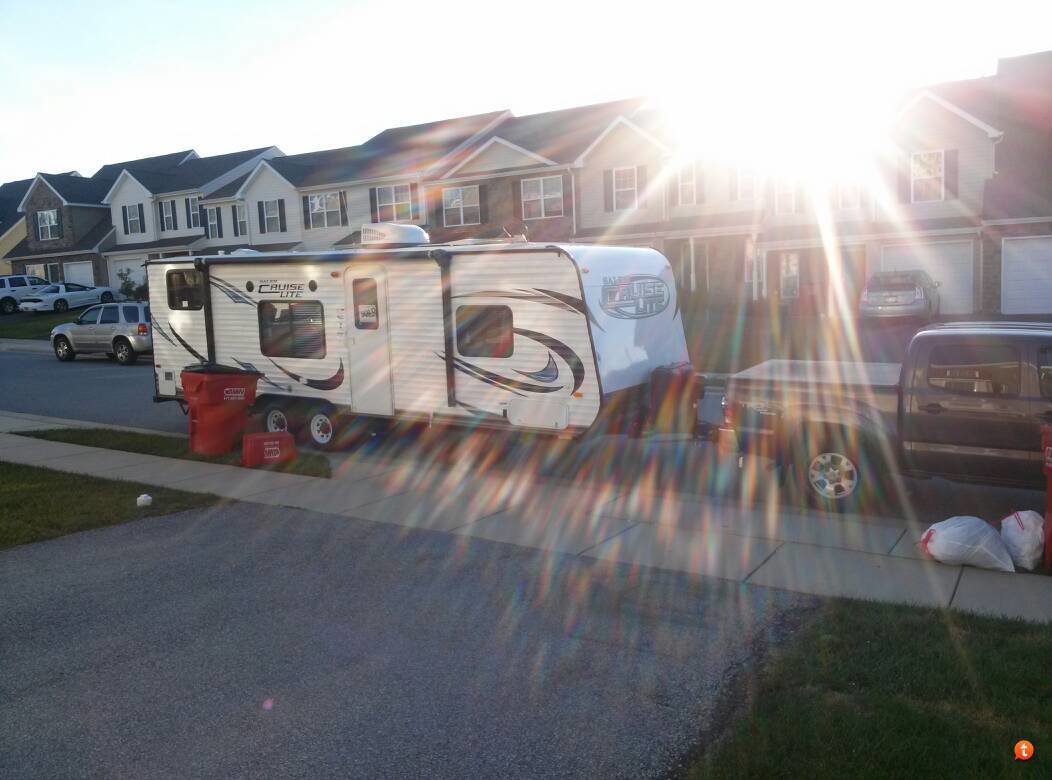

    IMG_20151010_121137958_HDR.jpg I'm pulling a 2201DS MINNI 4800# dry, behind my 2010 Tacoma. It pulls great, as long as you're not trying to push it in the hills. Interstate driving is fine even on the big hills near me in TN, I'm able to shift into 3rd and maintain 55-60 with no issues. The winding 2 lane roads with steep grades leave you wanting more but it pulls without complaining. As long as you have a good WDH you should be happy with your choice.

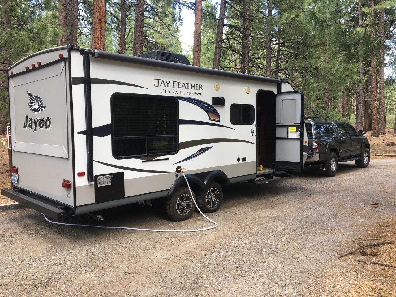

    From my last trip 2015 Lance 2285 and 2015 Taco Prerunner
    campingalan, TacoManOne and donny like this.

    I use my dad's 25' TT which is 4,600 lbs dry. The WD hitch is a must. Tow mirrors are also a must. The hellwig air bags really help (TSB springs), but I find that I only need about 30psi to level it out perfectly. Nice cushy and supportive ride. She doesn't like steep hills but can maintain 45mph in 3rd.
    I have another trip to Humboldt Co. Crescent City this summer to see how she does on long trips. If she struggles too much, I'm probably upgrading to a used 5.7L Tundra before taking the bigger trip to Zion, Bryce, Capital Reef, Yellowstone and Gunnison.

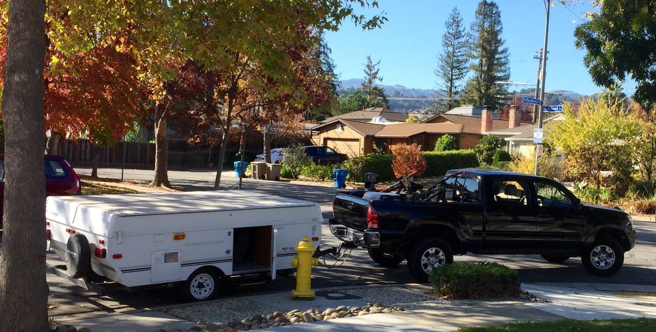

    I tow this thing all over the state like it’s not even there!!!!35C0D006-E1AE-4C40-AFD7-1F332A65870B.jpg

    OK I know it’s there
    But doesn’t slow me down much
    I’m actually looking at a hard side
    It’s a Camplite 14 footer @ 2900 pounds.
    Little more than I want to pull I like to stay close to 2000.

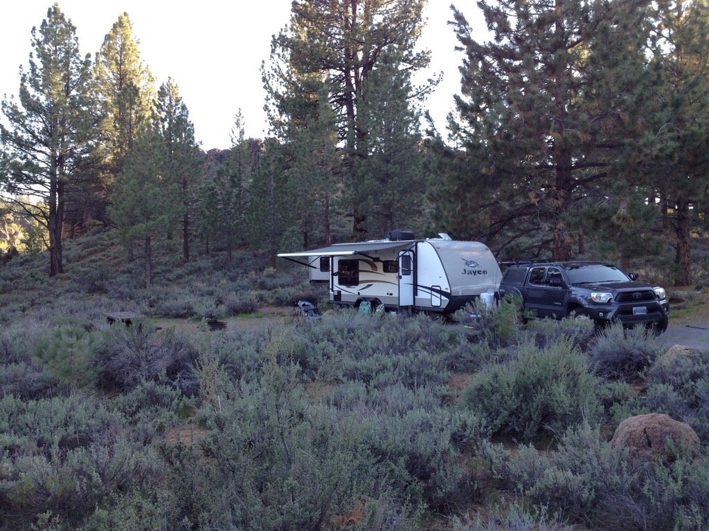

    I drag 5,000lbs around behind the Tacoma in the Sierra Nevada Mountains......not going to win any races but it'll maintain +55mph if you're not afraid to make it work
    A6AE5784-6688-4845-AAE0-C56112E6C5E0.jpg FDF75B4B-14B4-4FE2-BB22-91CA74114016.jpg
