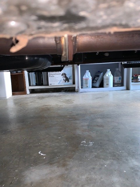

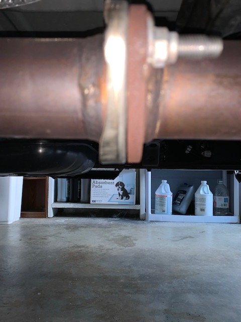

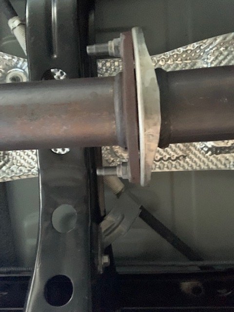

    Hello question for those who installed the trd exhaust on there tacoma. I installed a trd exhaust on my tacoma but I have a good size gap between the exhaust flange and the y-pipe flanged pictures are attached below. Brand new gasket was installed and both 14mm bolts are tight. I dont have any exhaust leaks yet. I sprayed soap around the flange and gently shoved a rag in the tip to see if any bubbles and none. But do you folks have the same gap or any gap?

    Not a issue , looks just like mine

    You could hit it with some RTV just to be sure, but you’d be able to hear it if you had a gap.

    Looks perfect. If flanges touched, that would mean inside may not. Then you would possibly have a leak. Inner is making contact, that's what you want.
