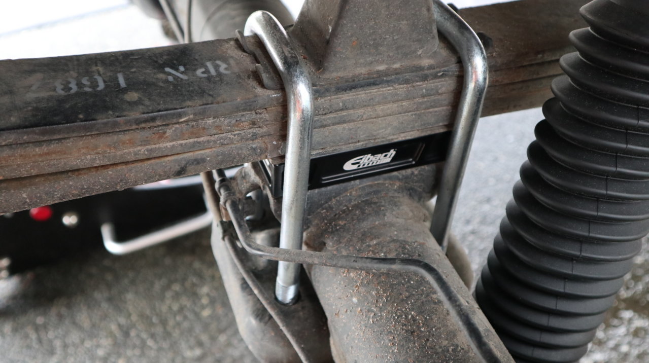

    Here is a picture of the shim, should it have been kept under the block?
    Update i swapped tires and rims and the vibration is very minimal now, my passenger side seat still shakes but might be common?
    I have the emu carrier bearing spacer in right now
