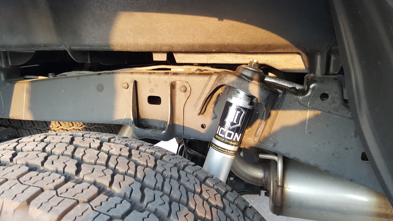

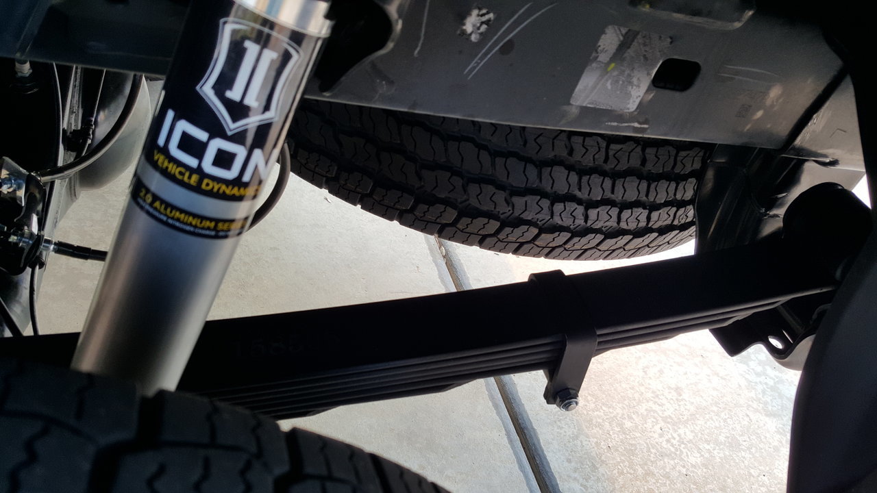

    I’ve seen your mentioned you ran the “full” Rxt pack, so I can be clear you added the extra leaf spring and did not remove any, correct ?

    All added, nothing taken. Also added the 3* wedge shim to readjust the pinion angle - at that lift height you need one.

    FOX are OK but non adjustable!. Also rear leaf suspension is junk. Wanted lift and rigidity and went with Icon RXT leaf full pack and 700# coilover on a stock truck. Love it.
    Next - soon - will install the W1 Add oil catch can but what's holding me back is the bracket (or lack of it) to install it.

    Did you have vibrations? Did the shim take care of it ?

    No vibrations, all OK now, BUT since I got E rated tires and have them inflated at 70 PSI I feel the road a lot...

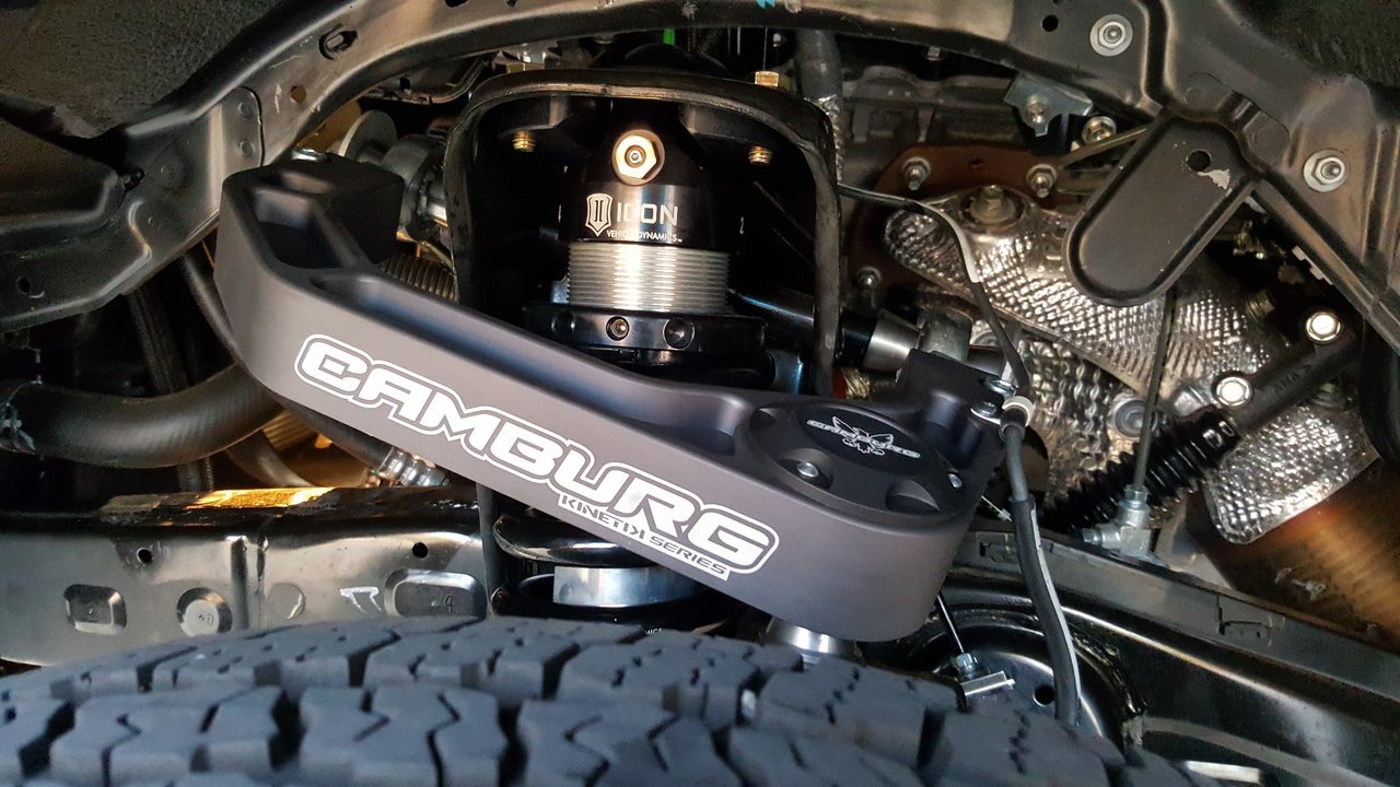

    Rathdrum, ID
    2017 _TRD Off-Road DCLB 4X4 Tech Package
    King 2.5 ext travel, Camburg uniball UCA, SCS Ray10 wheels, 285/75/16 Cooper STT Pro's, CMC , MBRP exhaust, K&N cai , OVTune 1.05 , T-rex billet grill, Rigid DS Pro ditch lights, SDHQ ditch light brackets, Leer 100XQ Shell, ShmellFab Sliders, Victory 4x4 Roof rack, LED headlights. SOS Concepts bumper, Smittybilt X20 Winch, Nitro 5,29 gears, ECGS clamshell bushing.
    Dude, how the hell did you slide that UCA bolt out without even bending that fender well? Looks like you did not even touch it. I had to bend mine, and cut some to get the bolt to slide out.
