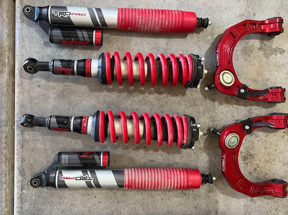

    Hi, I found someone selling trd pro fox suspension came from 2022 tacoma for $400. It was used for 60k miles. Is it worth buying? Good condition.

    Great backup if you're running aftermarket performance shocks that need rebuilds.

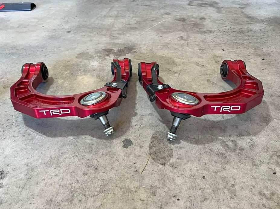

    You could probably sell the UCA's for $400 alone.

    Contact fox directly for a quote. Cost to rebuild is roughly about what these are selling for. I think they have centers in El Cajon California and Baxter MN.
    https://www.tacomaworld.com/threads/will-fox-rebuild-the-factory-trd-pro-fox-2-5-rears.782313/
    https://www.ridefox.com/service.php?m=offroad
    https://www.tacomaworld.com/threads/replacing-original-trd-pro-fox-shocks.703540/#post-24946751
    Otherwise, this...
    https://www.tacomaworld.com/threads/trd-pro-shock-rebuilding-available-now.807018/
    Those uca's are pretty pricey. For $500 I'd buy the set and rebuild them.

    That's a great deal, send them to FOX for a rebuild. It'll run about $150 each. I just had mine done for my 2017 TRD PRO with 58k miles. It's definitely worth buying IMO as a backup.

    I would buy just for the A arms alone. Jump on that.

    I’d buy the set for just the UCAs and then sell the rest for $800 easy.

    Definitely a good deal even if you make the reasonable assumption they'll need a rebuild, the comment earlier giving $150 is about what I think I remember coming up with in my research as well. If you don't need the UCAs for your build you should be able to get some decent money back selling those off; they've had clearance issues with some wider tires so somethign to research before you consider install.
    Lift on the front over a stock Tacoma is 1" on a 2020, I can't recall if that's the same or the front lifted a bit more in the coilovers in 2022-2023. Rear shocks can handle some lift as well, I've run mine on a 2" leaf pack lift for a while without issue, you just will have a less down travel the more lift is on the rear.
