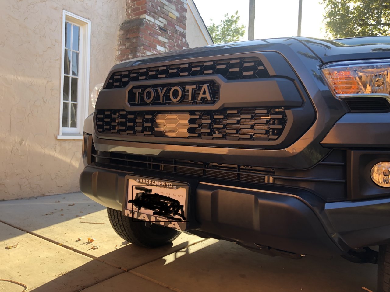

    Save yourself a bundle and get the knockoff grill and get as little from the stealership as possible. I got this one for $100 and spent the leftover for paint and 3mEA9F519D-8BBF-422A-9BCE-6F5FFD506B28.jpg

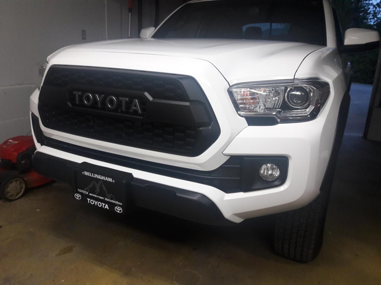

    58462214_10156647048057600_6593572001124_c94a1b9f9d3717e7d8b3fff83ed90da7617056d2.jpg

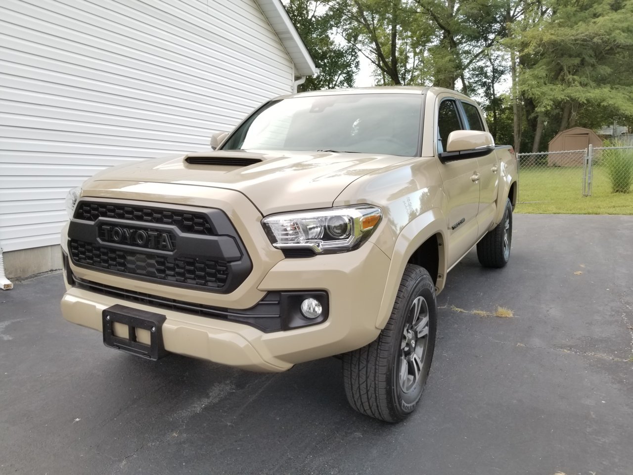

    Got it installed folks. Was pretty easy and looks way better than the old stock grille.

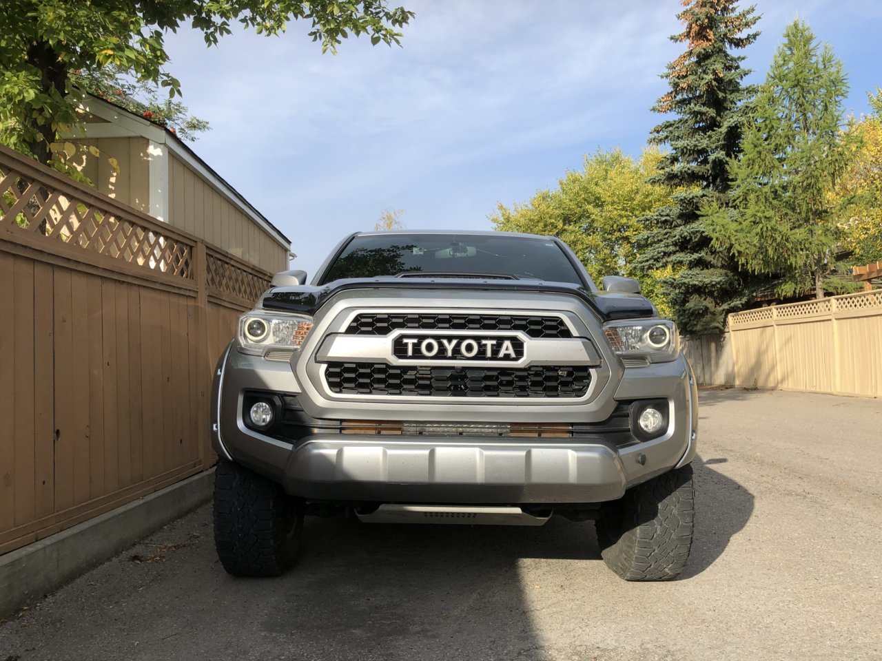

    from taco garage 2019 TRD OR
