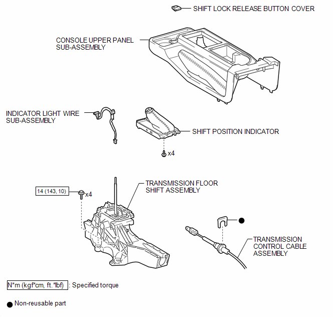

    Fyi, I checked mine this morning in a parking lot. It didn’t take much pressure to flick the lever from D to N. I can totally see this happening if it is out of spec.

    Ask for the best Toyota Dealer for Service in your area (We have four dealers, one excellent, two OK, one I wouldn't trust with a lawn mower).
    Call the best one and make a service appointment "fails to remain in Drive, often noted downhill coasting, it pops into neutral"
    The shifter is a big plastic assembly and a shifter cable. Easy swap out. If you have after-market skid plates, I will remove them so the tech can get to the transmission.
