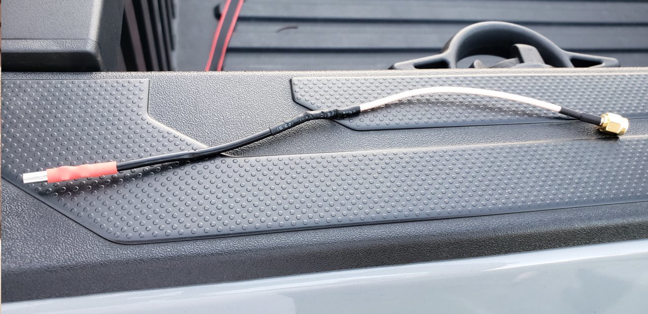

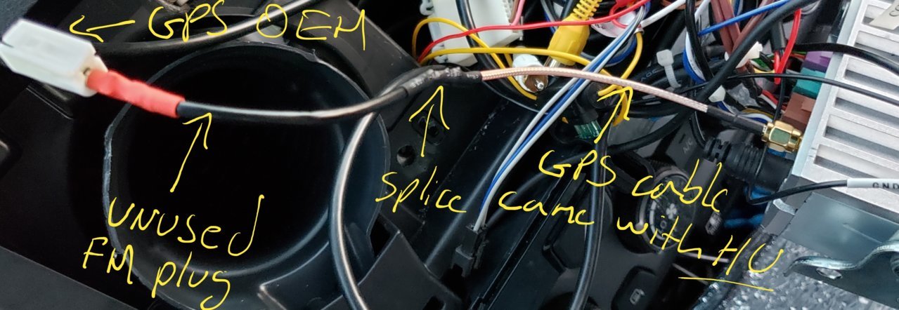

    DIY, GPS plug. Using the connector of the extra harness that came with my unit(other brand, I guess is the same with Dasaita), made a cable to use the stock GPS antenna.

    Any noticeable difference in performance? Saves one less thing to mount up that's for sure.

    Nope, works exactly the same way. As you say, one less cable to route. I was parked at the carport at that time.

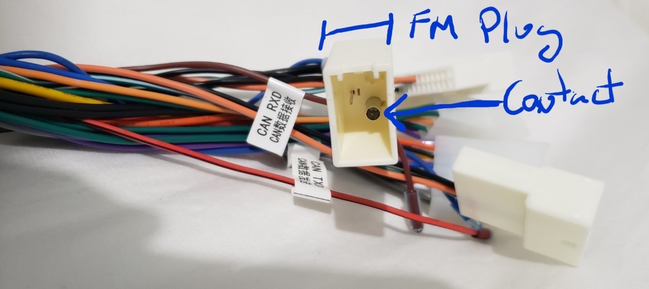

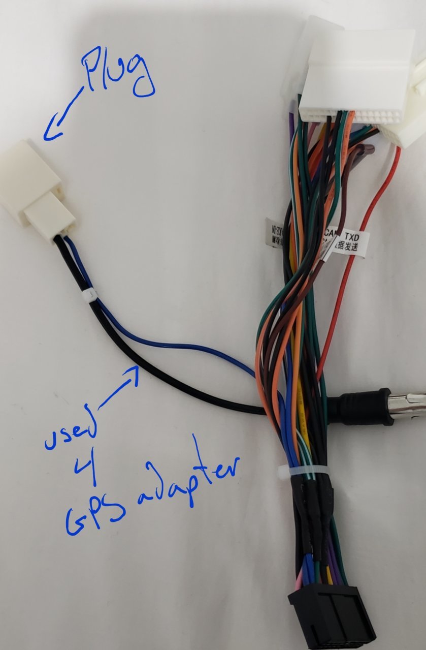

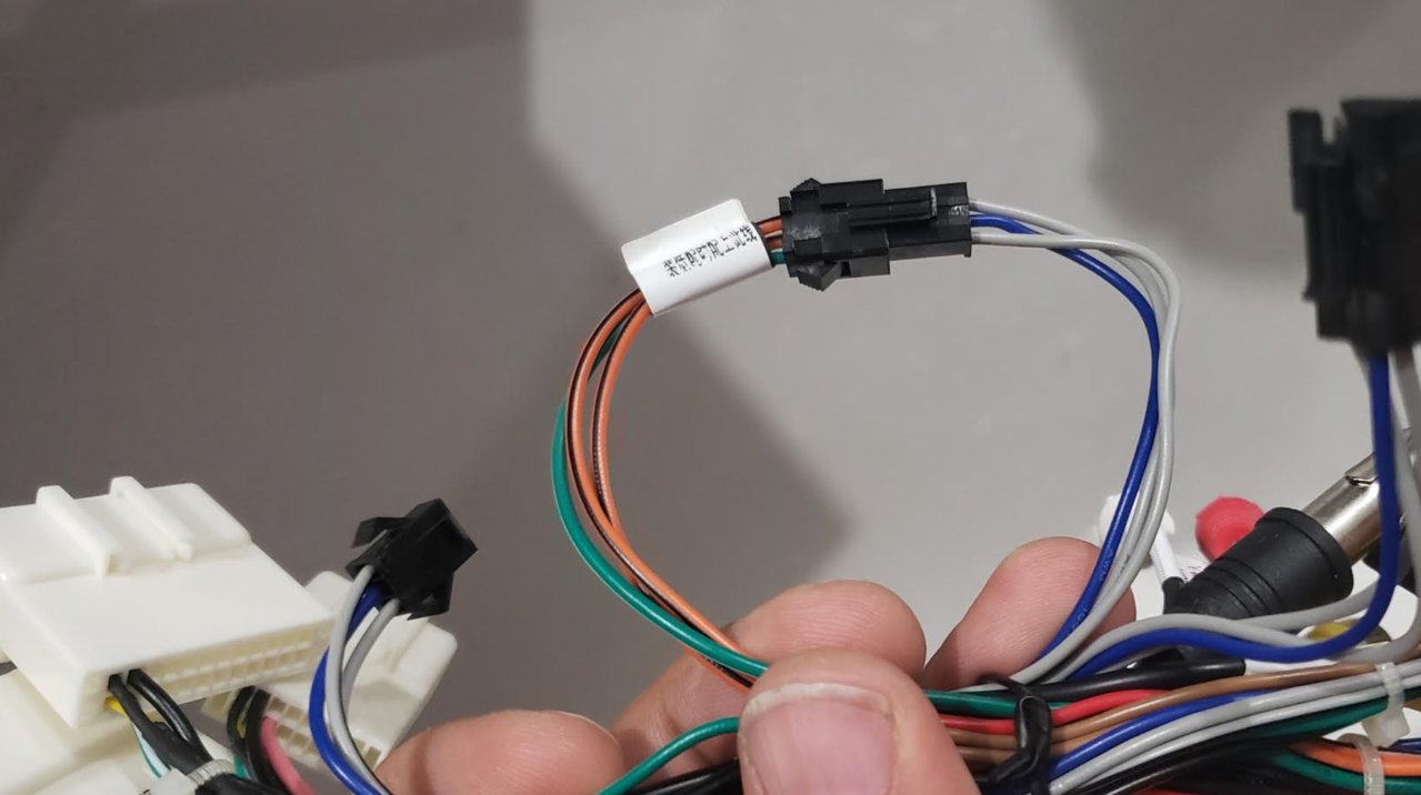

    Extra wire harness pictures.

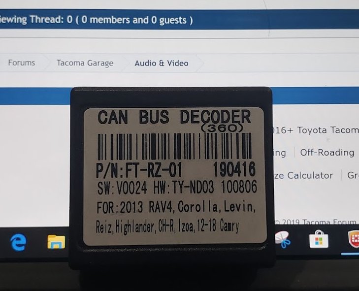

    This is what I did to avoid the change from Miles to Km. I removed the CAN BUS unit completely and connected the cables as shown on the picture. After that reprogrammed buttons using steering app. Now if I manage to crash the head unit, nothing changes on the center info panel.
    What changes? The carinfo app does nothing(I never used it anyways) no TPMS and fuel range etc on the app.
    Hope this helps.

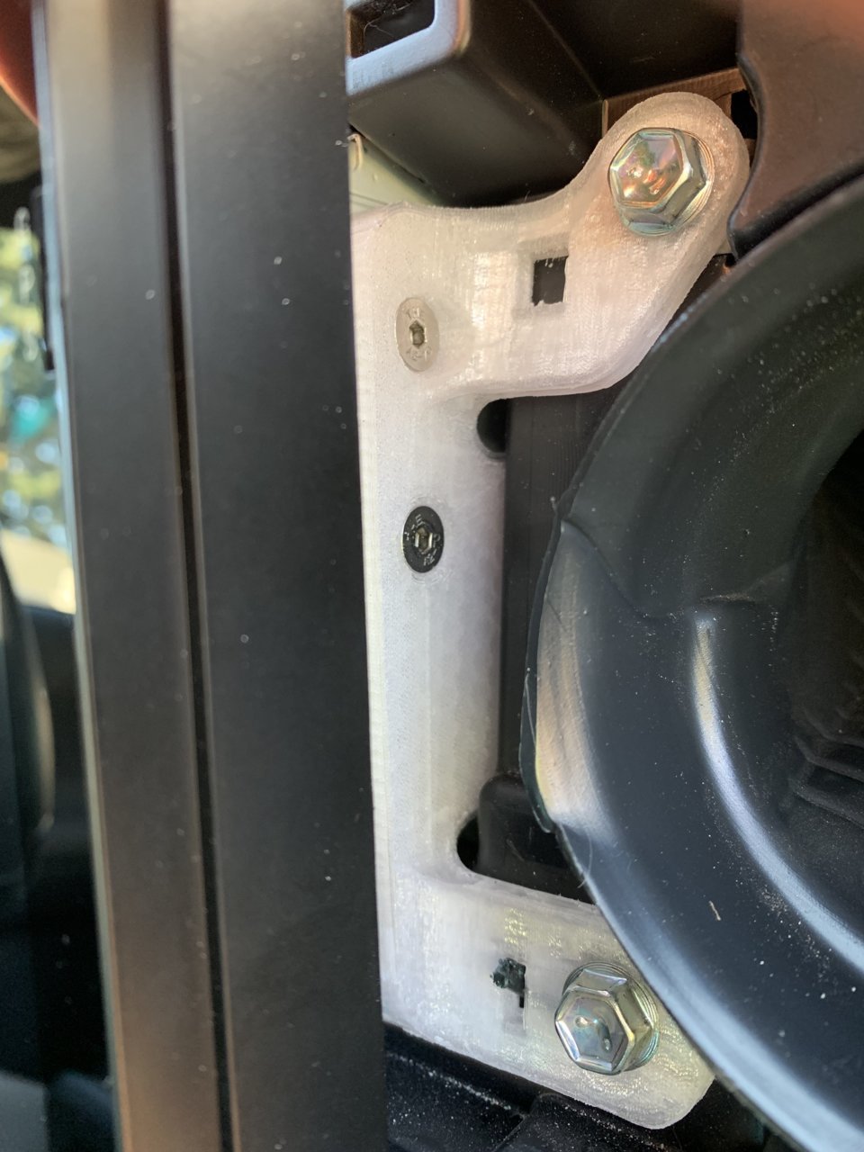

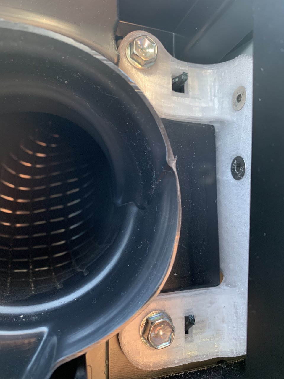

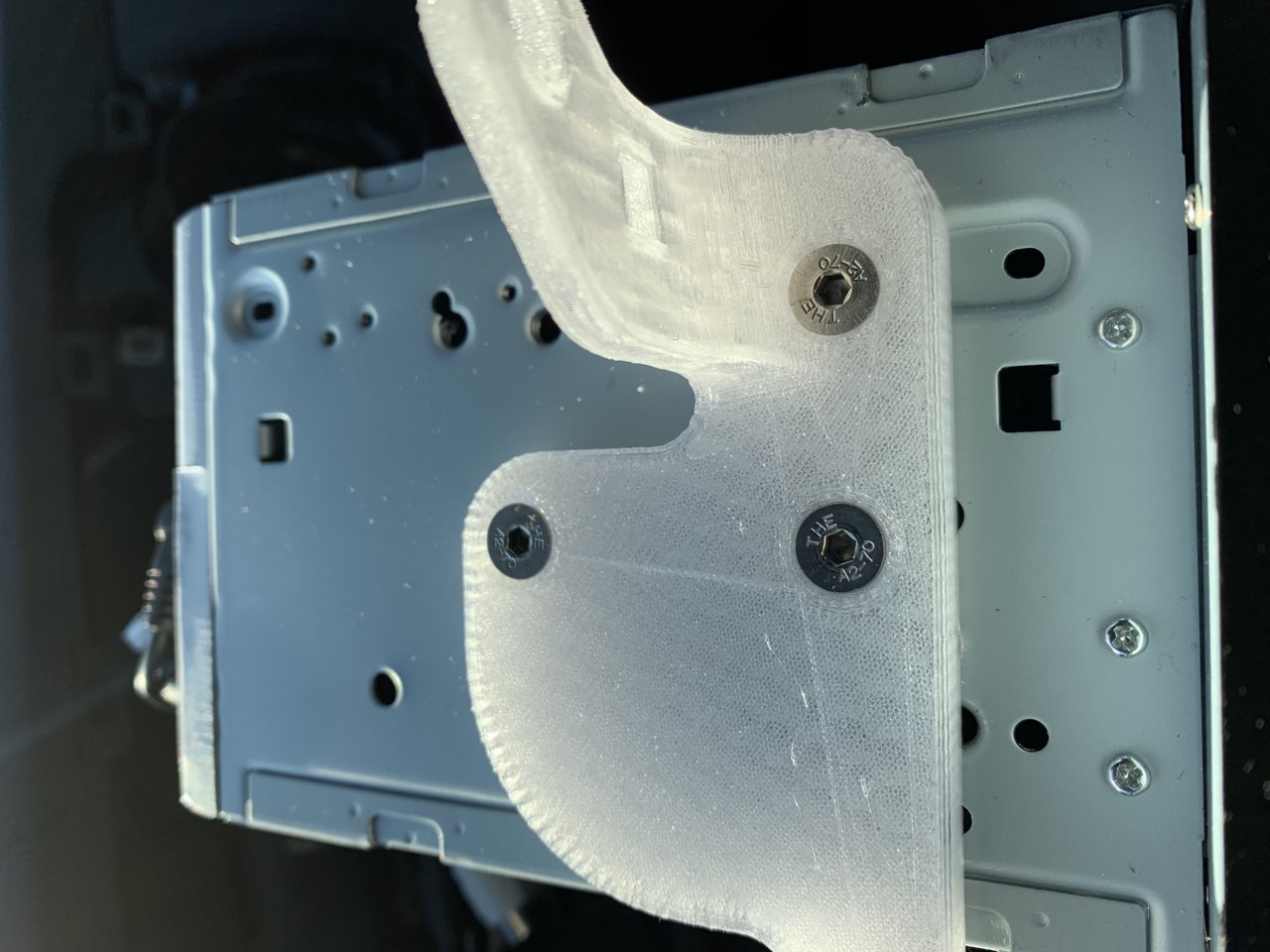

    @benkitesurfs - I ordered these via ShapeWays and have used them before for my other 3D printing. Super thanks for creating these and lucked out that these were found deep in this post. Do you know if these will fit the latest Dasaita PX6 radio? I am having the exact problem. Bezel keeps popping off and it looks like its a very small adjustment but the brackets can't be adjusted. I will let you know if these work. I will also repost some of this over in the Dasaita thread - https://www.tacomaworld.com/threads...e-carplay-wireless-and-oem-audio-plus.620897/
