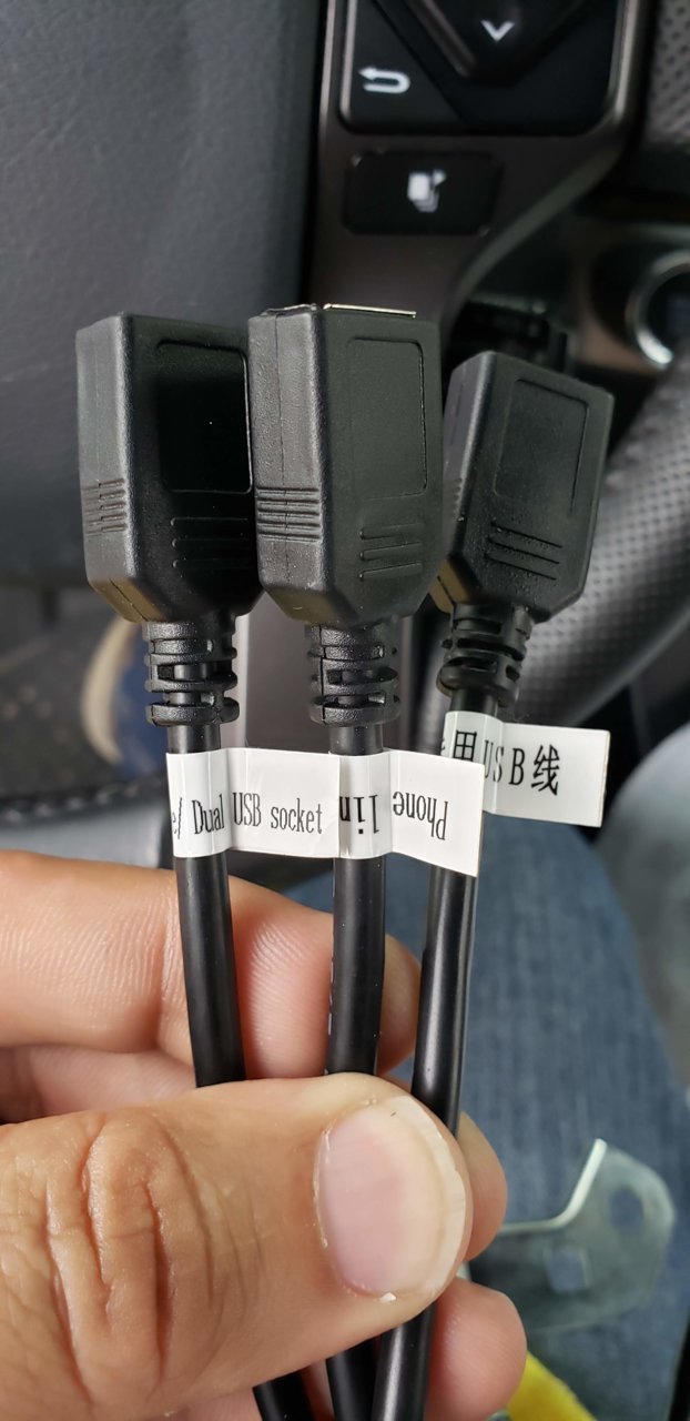

    2. The unit includes a cable that allows the unit USB to be plugged on the stock position. Looks like this PAC USB-TOY1. No splicing whatsoever. In addition you have 2 more UBS ports.

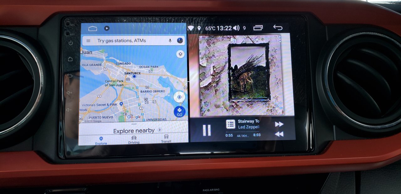

    20190708_132303.jpg Poweramp+Google Maps, looking awesome.

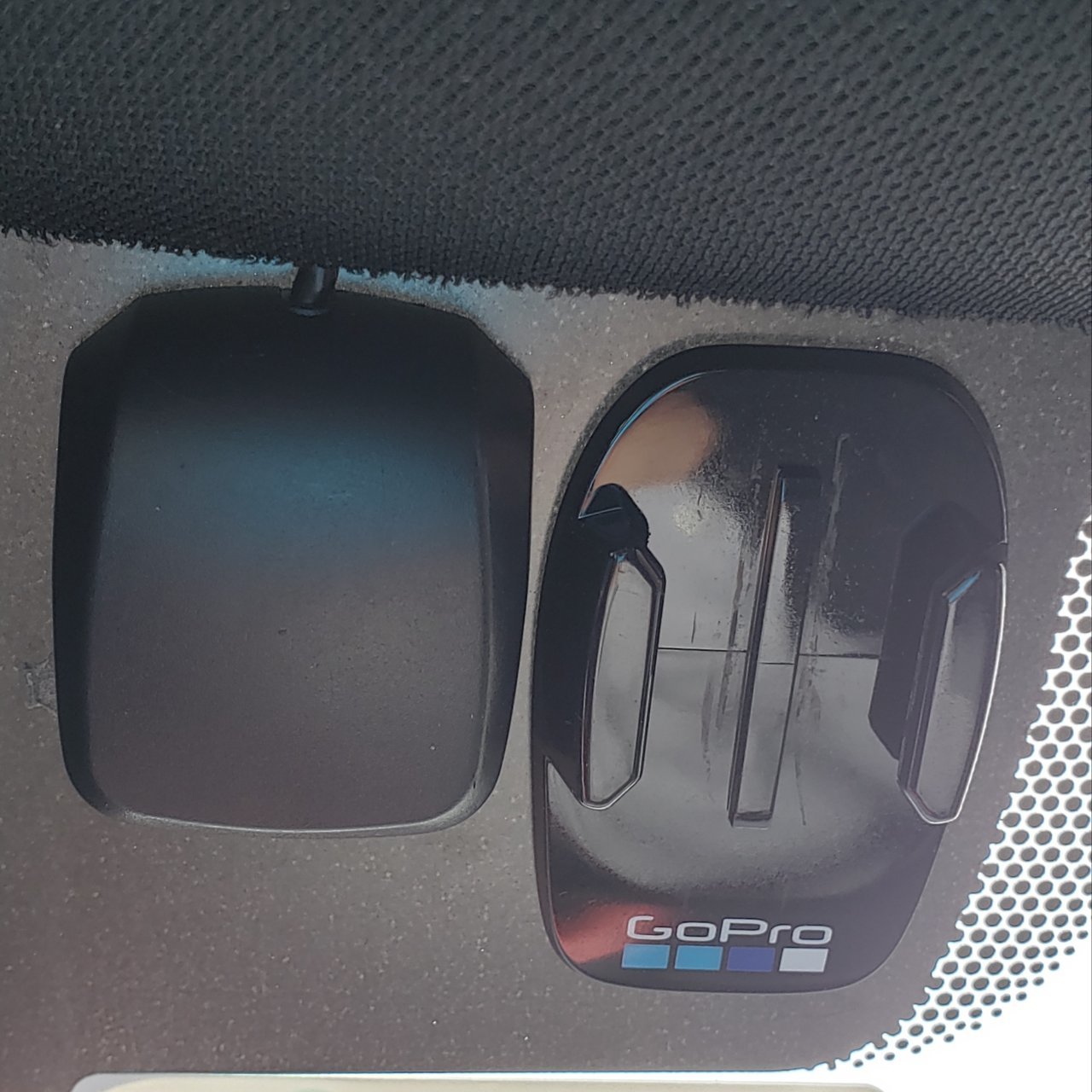

    I was wondering, where did you end up placing the wifi antenna?
    I was thinking of hiding it within the HU enclosure above the HU but not sure if signal will be heavily affected by this, my guess is, it shouldn't.

    You meant GPS?

    Yup that was a typo lol and that's a great location

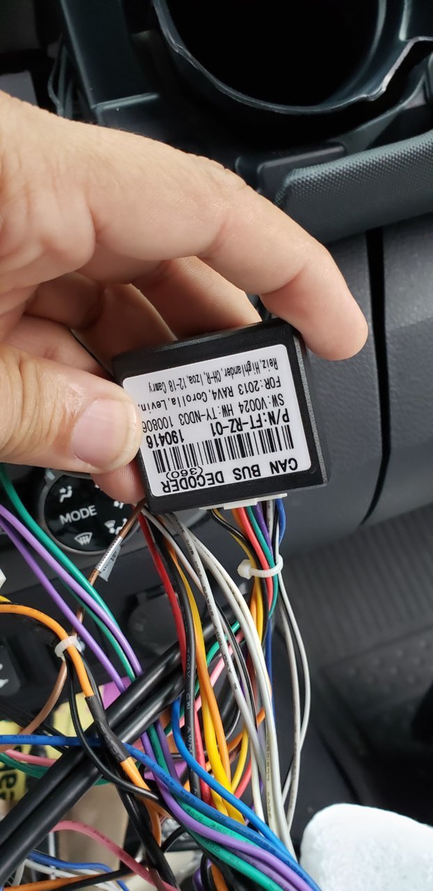

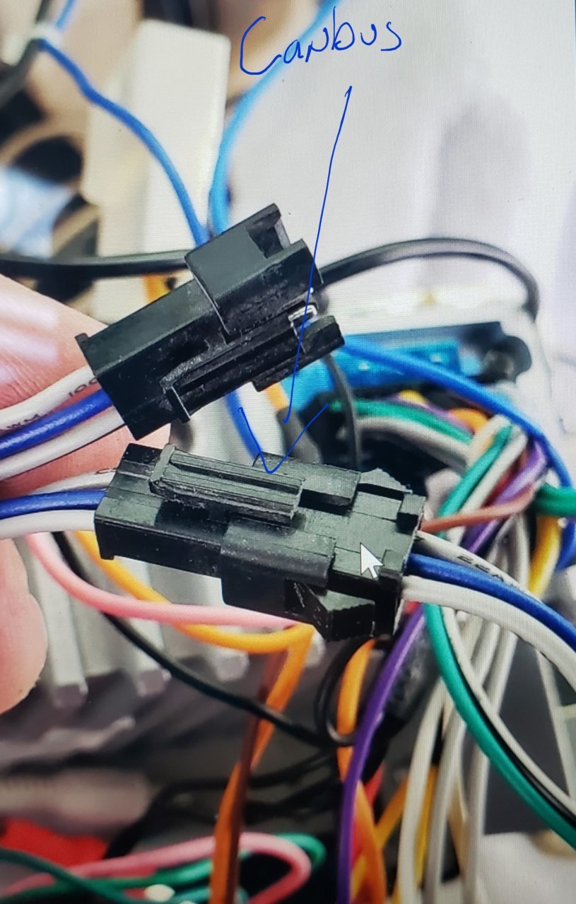

    The only things I am trying to figure out before I put it all back together is the steering wheel controls, the setup says to hold the steering wheel button for a while, then select it from the ones shown? Nothing is happening though.

    Steering: Did it came with the Canbus? If yes make sure this plug is connected. Have you set the canbus type? Can you control the volume?
