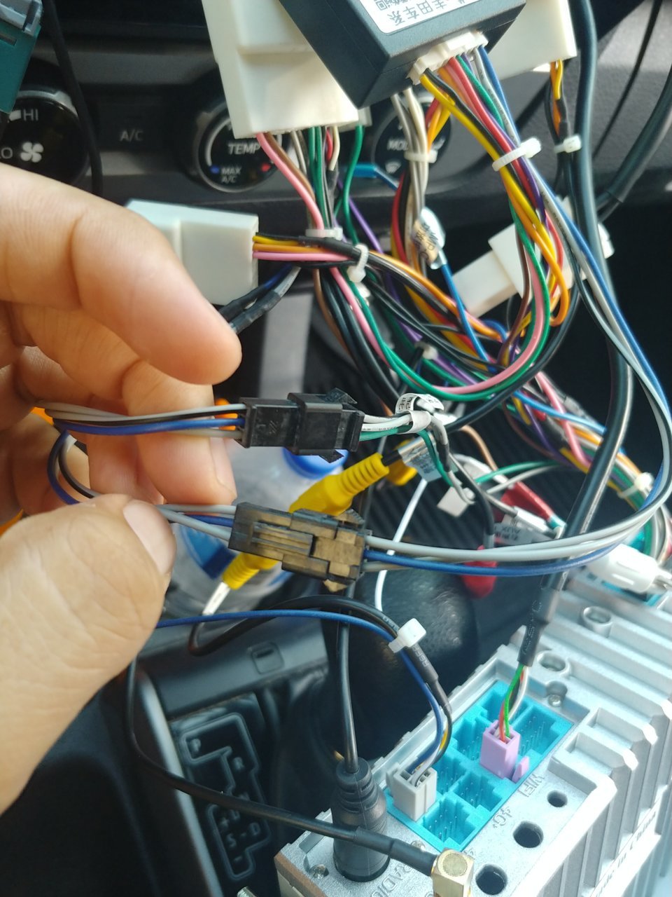

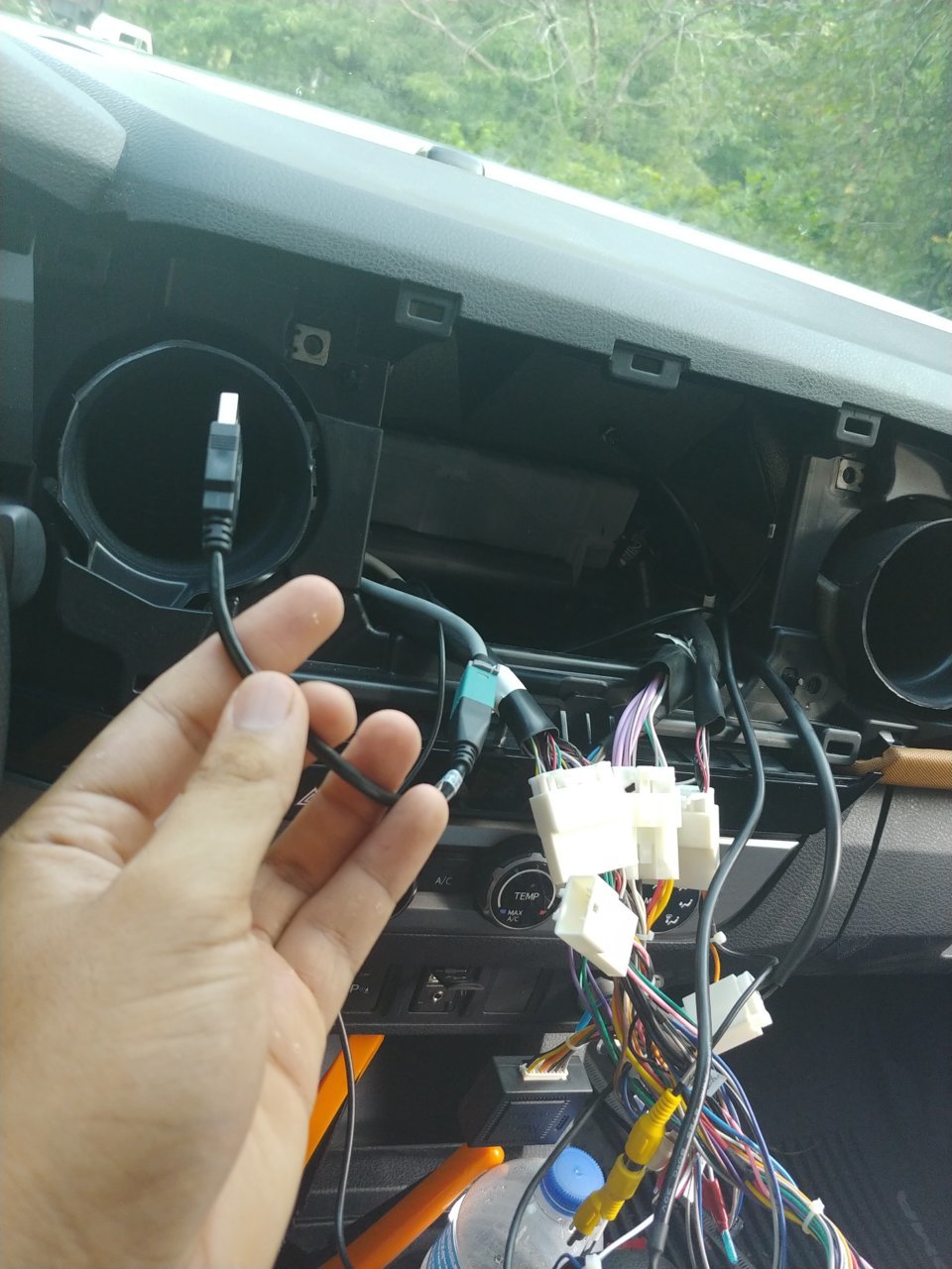

    So I was able to find those plugs but we have 2 sinilar ones, does the order matter?
    Also for the z link connection(carplay/auto) that ends in a usb port, are we connecting the phone directly there or are we connecting it to the tacoma's green harness through the usb adapter? I'm guessing it's theater since it would make the usb port on the tacoma functional as the android auto connection.

    Yes, it has two that are exactly the same. It doesn't matter which one.
    For convenience test what USB cable works with your phone and map that one to the oem plug. The other two I left them hanging through a spare position in front of the shifter. I will eventually order a plug that fits the dash on ebay.

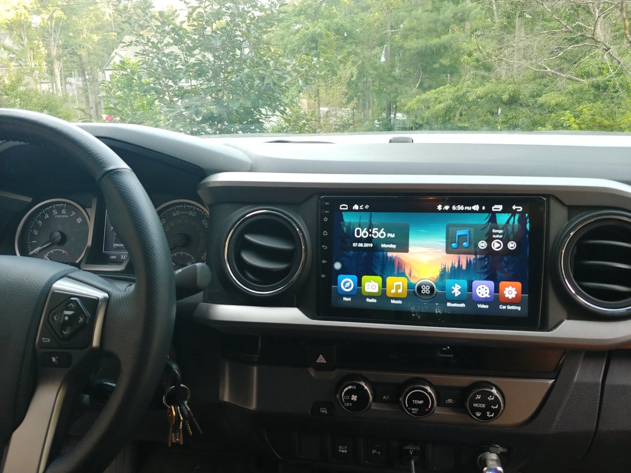

    Just to report back, the HU is up and running now, took it on a little trip earlier and it's working great!
    One thing to note is that reversing track reversal made my reversing track literally backwards so maybe the newer units are calibrated correctly from factory.
    Overall the installation wasn't that bad but the lack of instructions in the box made figuring out a couple of these connections a not so easy task, really gotta thank @delonix!! This is exactly what I was looking for, an android capable HU that looks OEM and the best part is that it's optimized for Toyota!

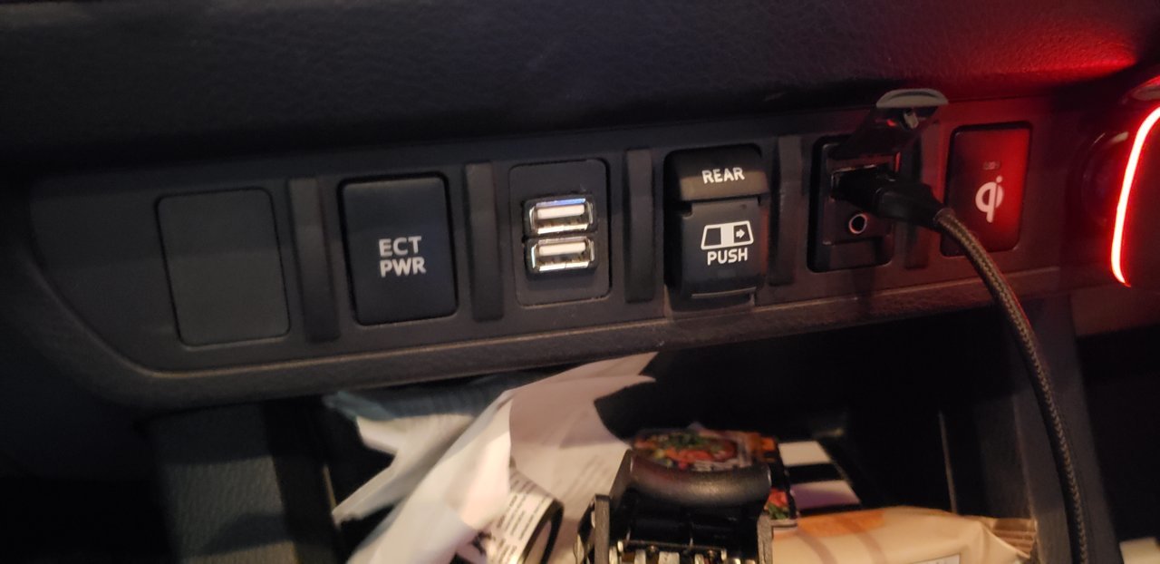

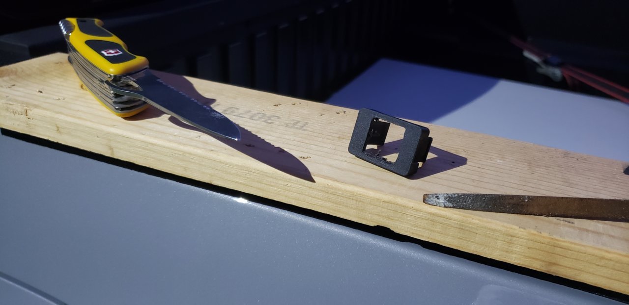

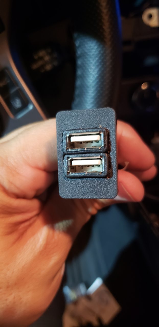

    Finally did something with the hanging USB ports @Crimson Flam3s. I swear, I have a dremel. Just don't know where!

    I ended up buying the one you linked since I probably didn't need 2 but i might put my dremel to use and do this as well lol.
    What did you use to attach them?

    Hi, so far so good. You can't get the plugs wrong, every plug has only one place to fit. You can look st the pictures of the posts if you have any doubts. Also if you have any questions feel free to ask.
