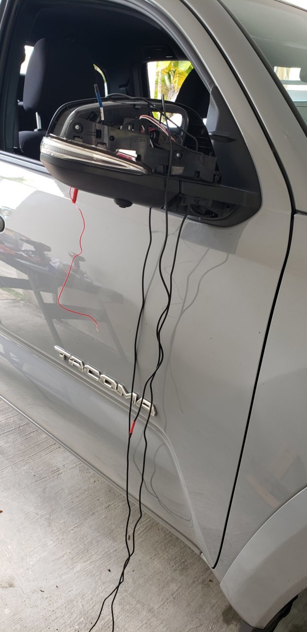

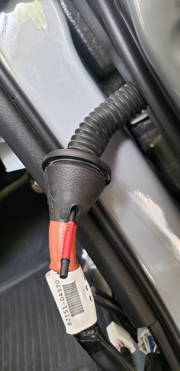

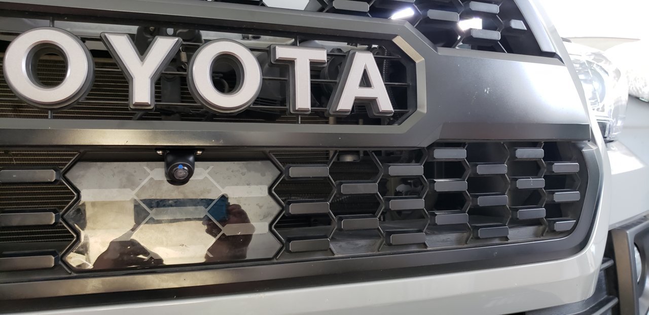

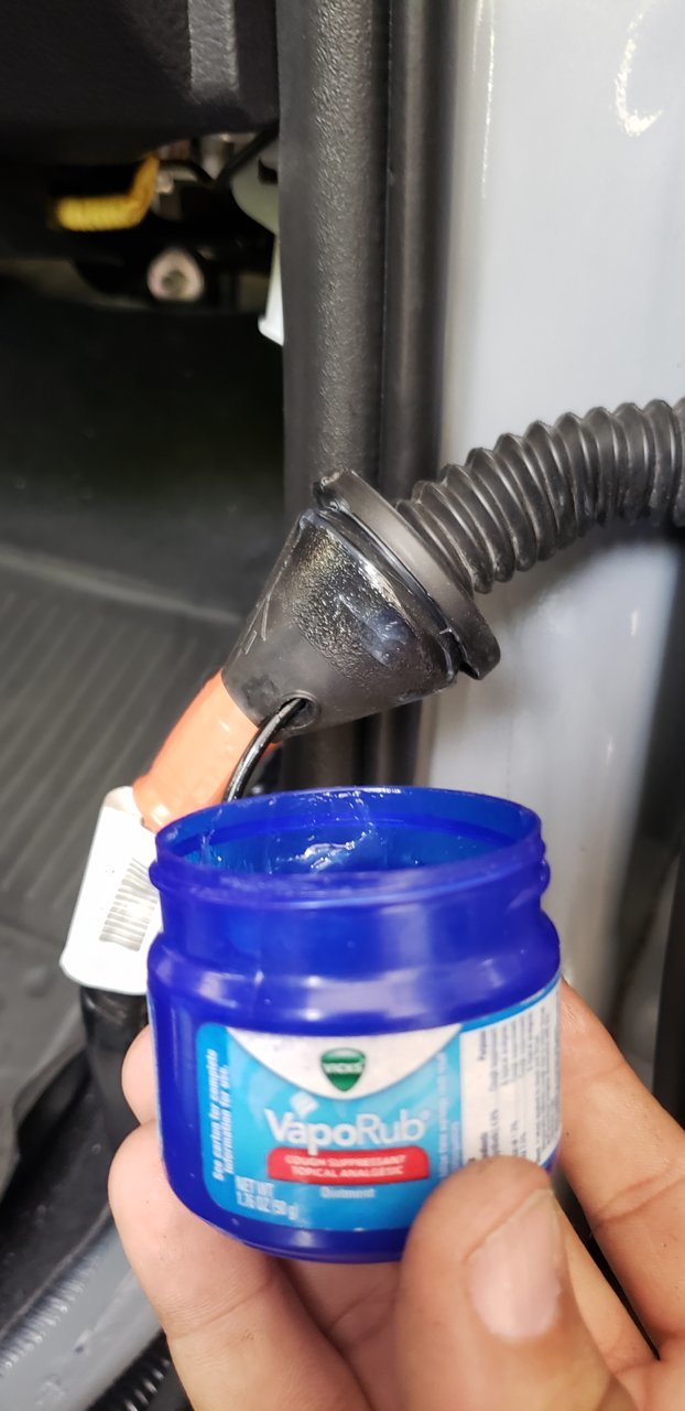

    20190818_160653.jpg Now the horror of routing the cable from the door to the cabin.
    Finally!
    Front camera.
    Getting there. Still missing rear camera and calibration.

    Well..., kinda.
    Crimson Flam3s and benkitesurfs like this.
  8. Aug 18, 2019 at 2:04 PM
    #128
    DoubleD.17BlazingBlue
    DoubleD.17BlazingBlue Well-Known Member
    Aug 8, 2019
    #301592
    102
    Derek
    2017 Blazing Blue SR5
    Little lube never hurts LOL
