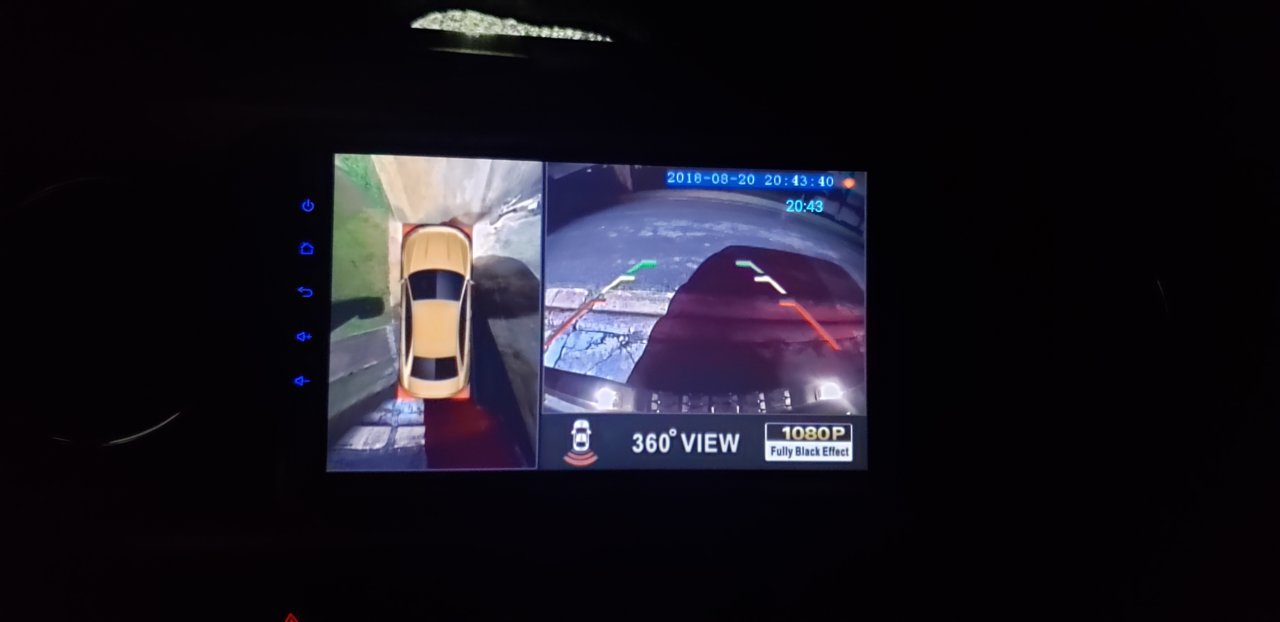

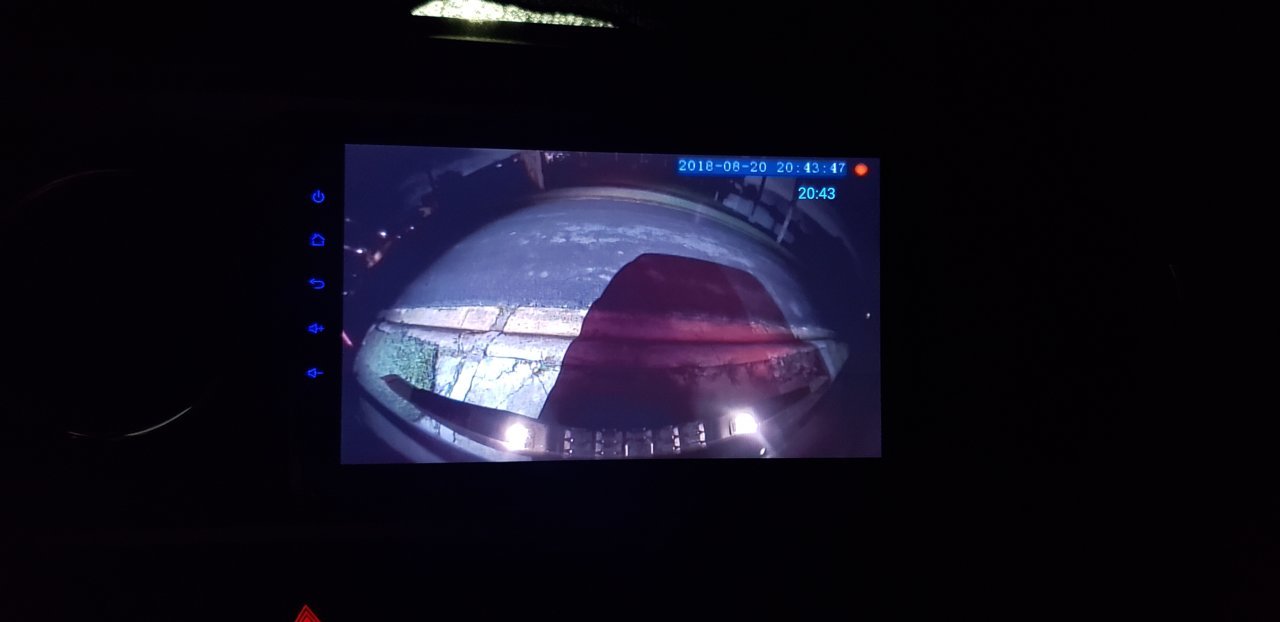

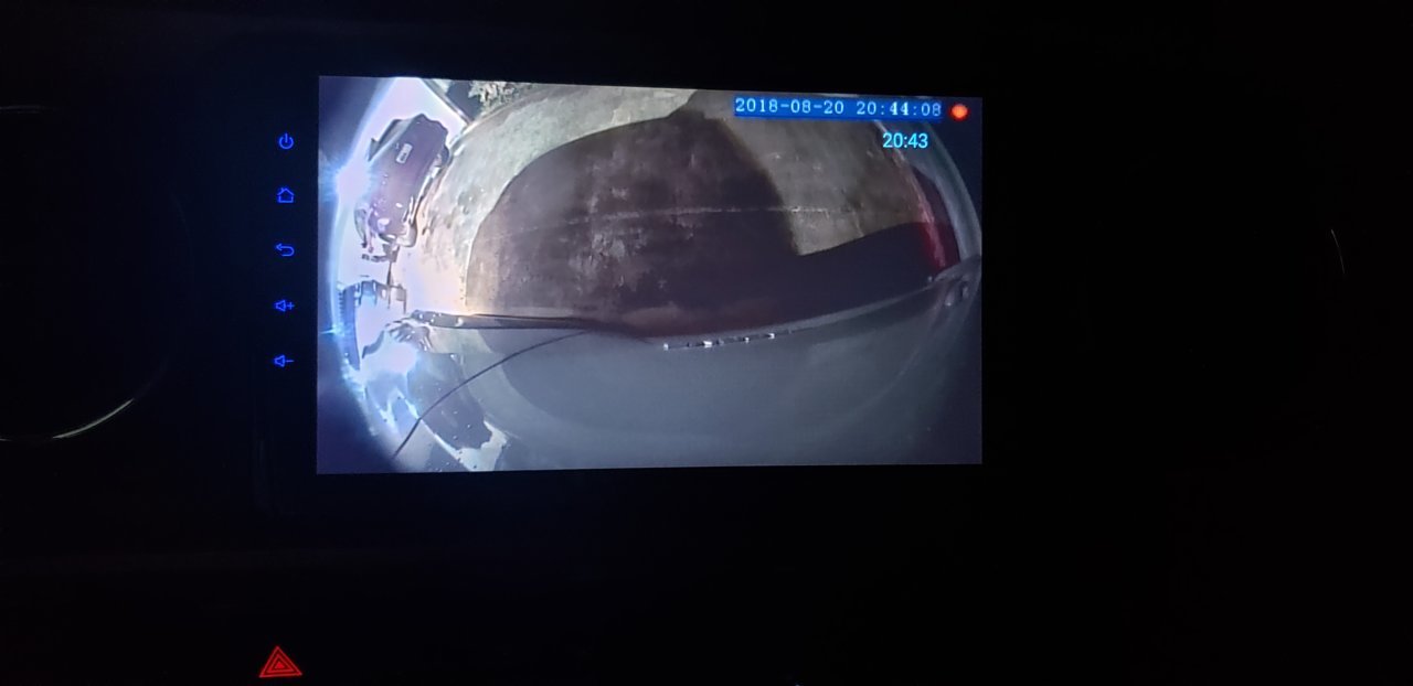

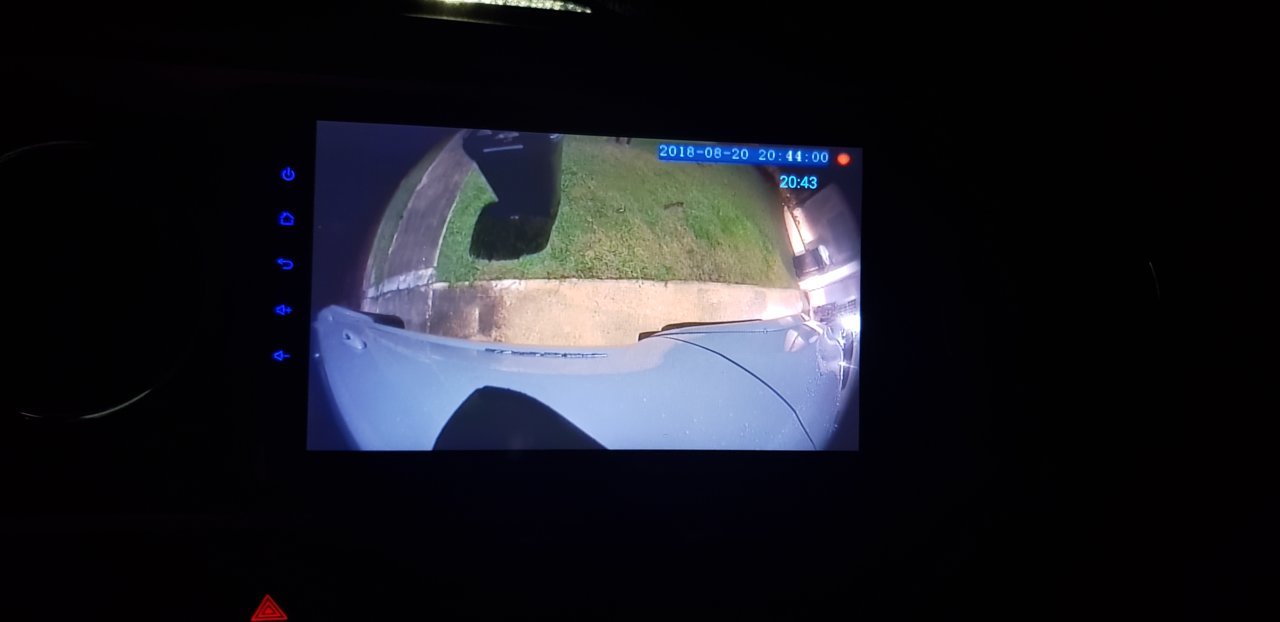

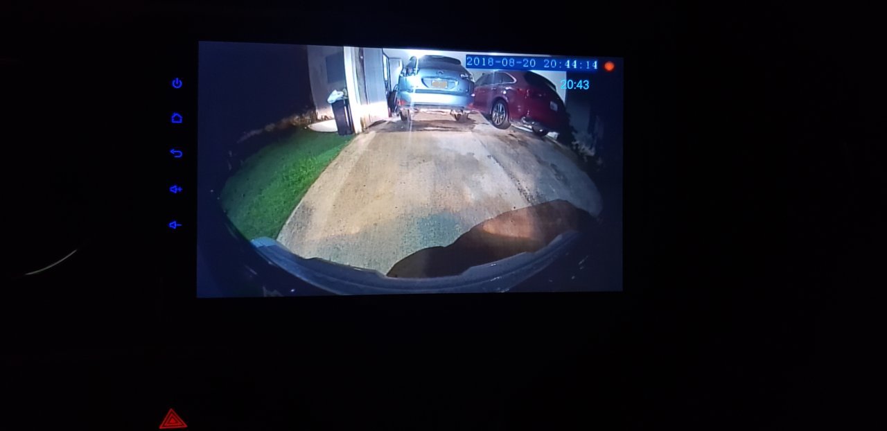

    360 Camera quick demo. It is not calibrated yet.
    Some pictures of the views.

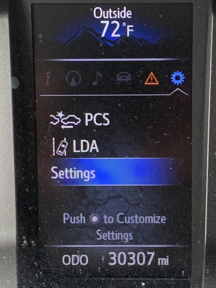

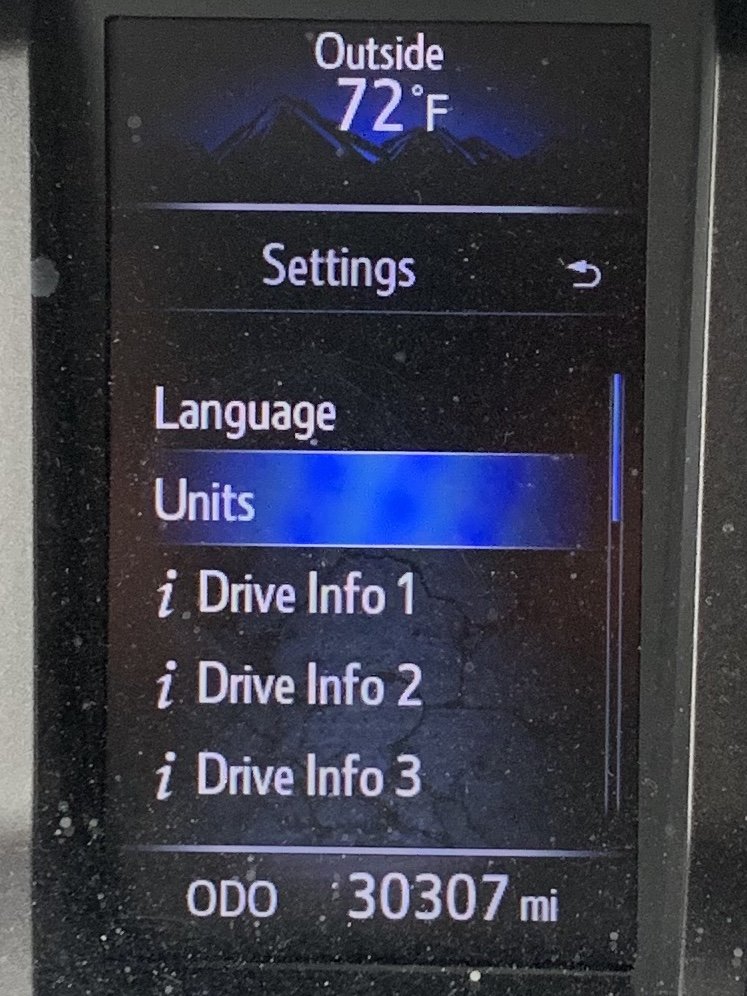

    Public Service Announcement:

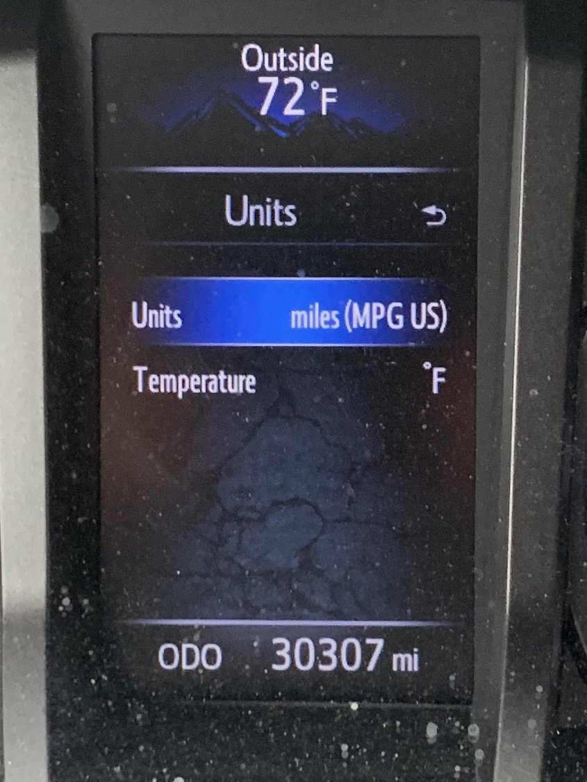

    You can change your odometer units from the screen on your dash with the steering wheel controls!
    I was pulling my hair out because I installed Carista, connected to my OBD2 adaptor, and Carista can change every setting in the book except units :annoyed:
    Fortunately it’s not necessary

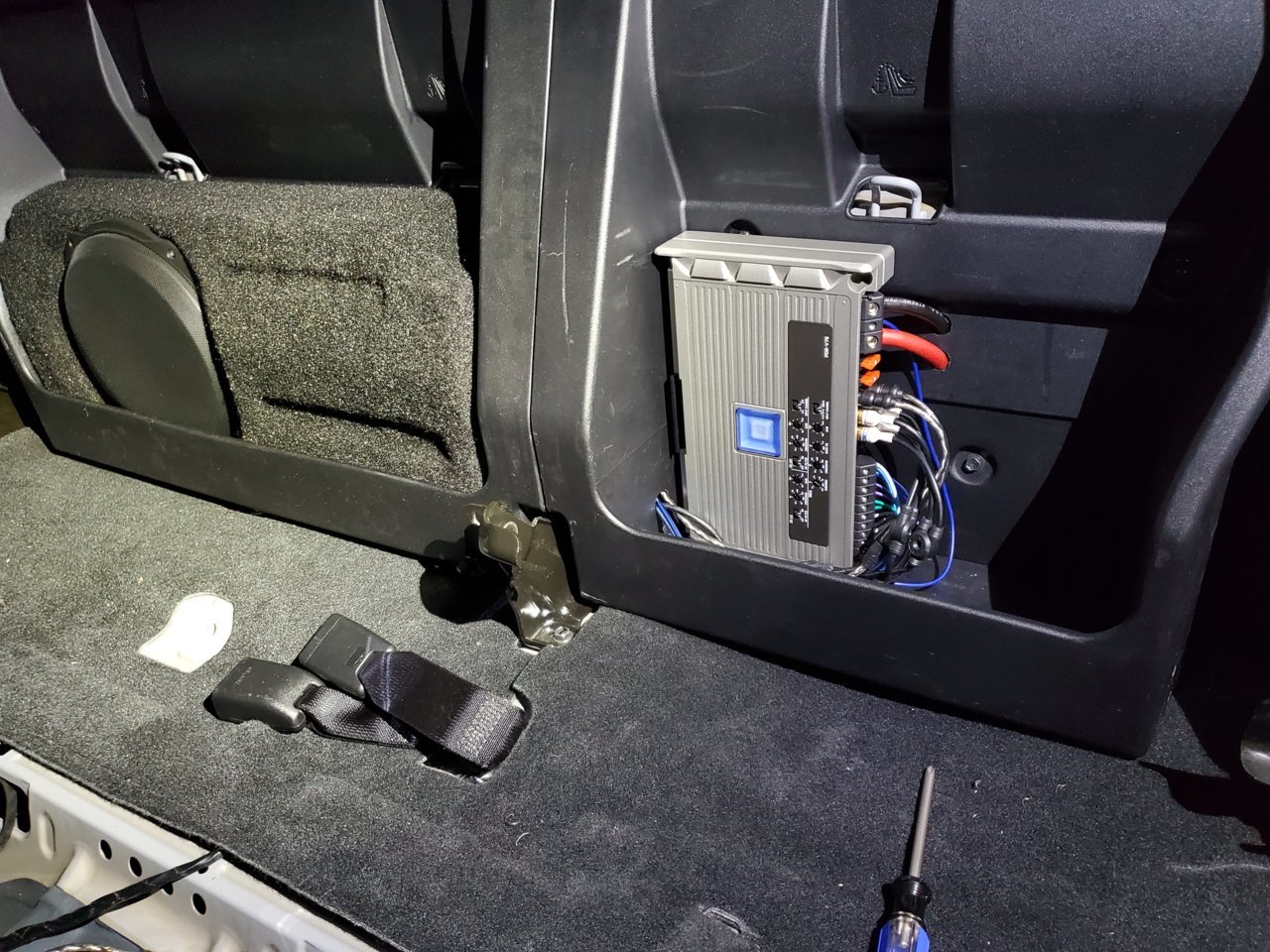

    Ok...thought it was just me. I'm up and running. The DSP of the headunit is nice with a good set of speakers. Since I was already invested, decided to install a few more items :D

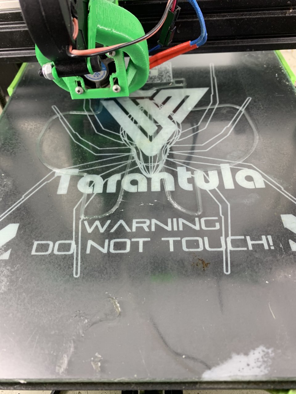

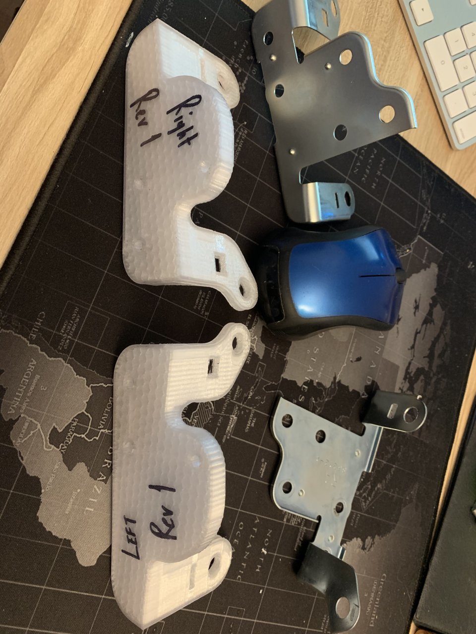

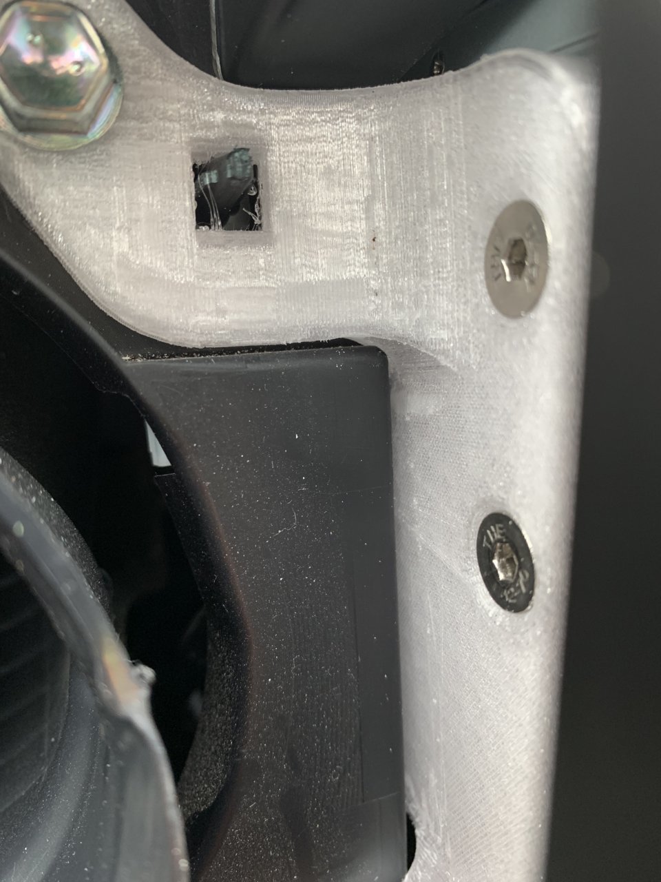

    So I was annoyed with the bending of the stock brackets, so I 3D printed my own. I’m still tweaking the design, but when it’s done I can link the .stl files in case anyone else wants to print them/have them printed rather than bending the stock ones.

    _gray_knight_
    _gray_knight_ Well-Known Member
    Aug 10, 2010
    #41508
    1,705
    SoCal
    '18 Mall Crawler
    Just washed
    That's awesome. I didnt have to bend it that much but it sure wasn't PNP for that part.

    BTW, awesome bracket solution!
