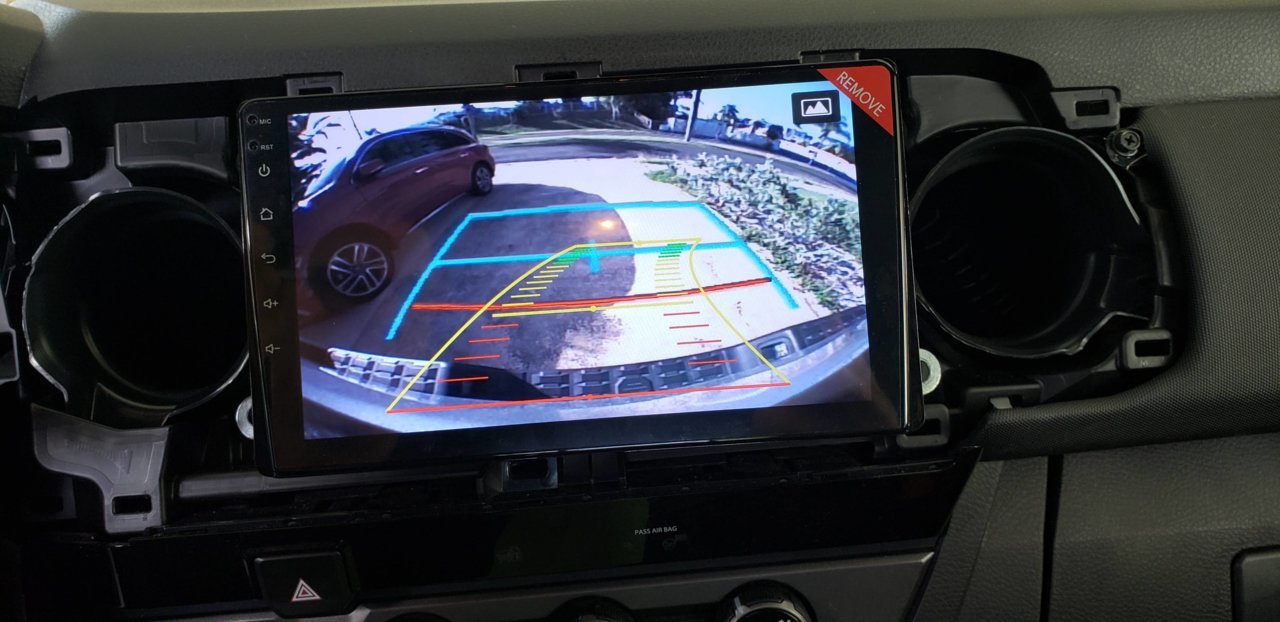

    Reverse camera now shows trajectory, but is inverted (maybe a setting is missing) -Fixed, can be corrected via Settings->Factory(pass 3368)->Original Car Agreement->Reversing Track Reversal=On

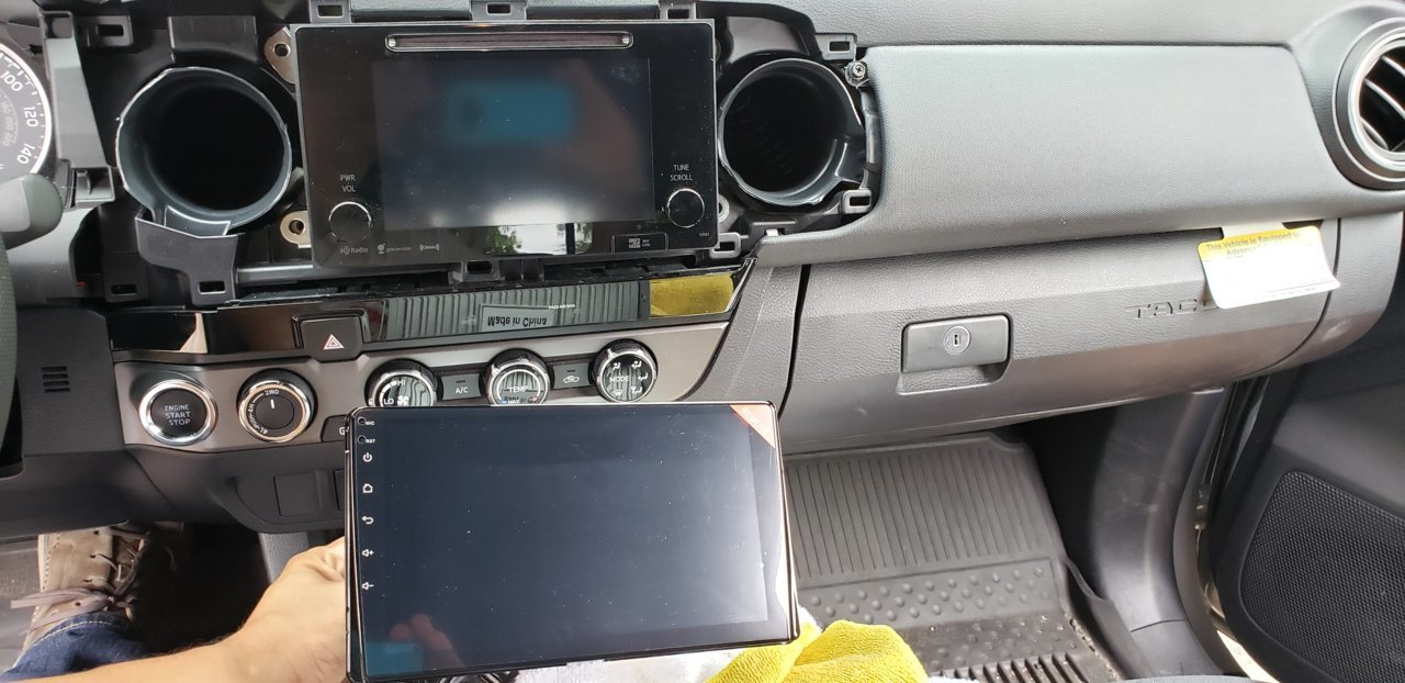

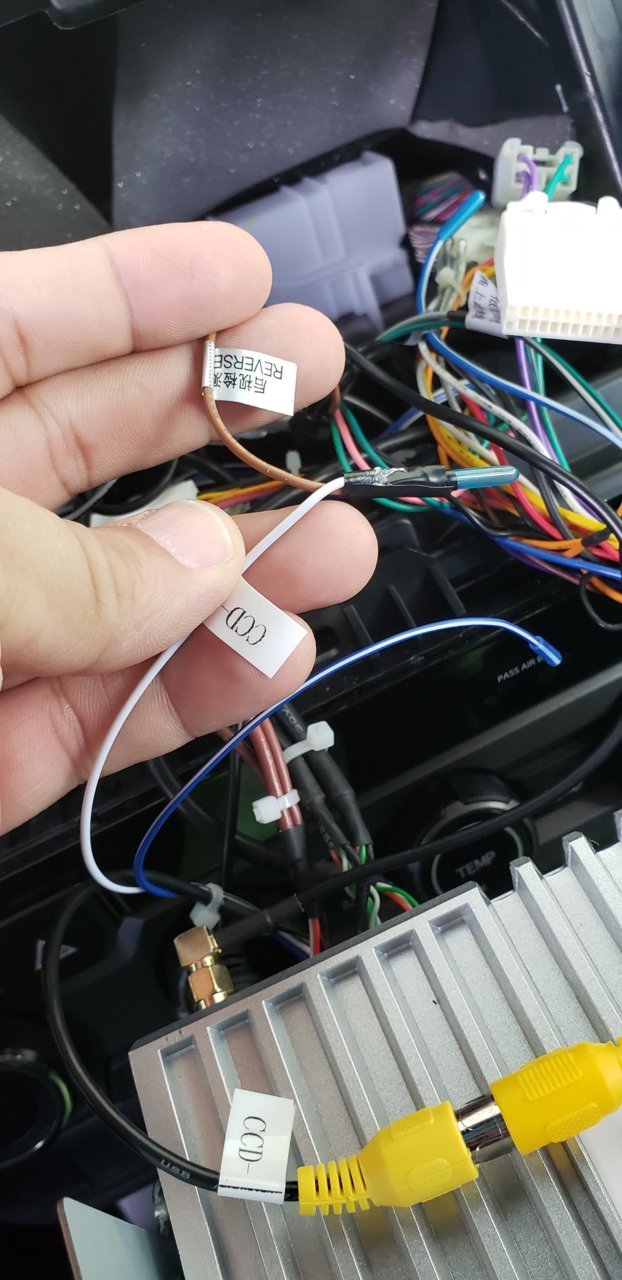

    Some more pictures of the installations. I will be posting a video showing the flow of the interface later.
    Reverse camera plug (ccd-v) and cable(cdd-c) splice:20190514_075938.jpg
    Trajectory lines guides:

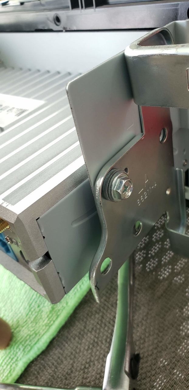

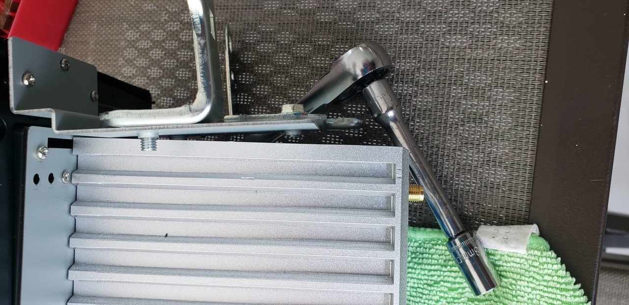

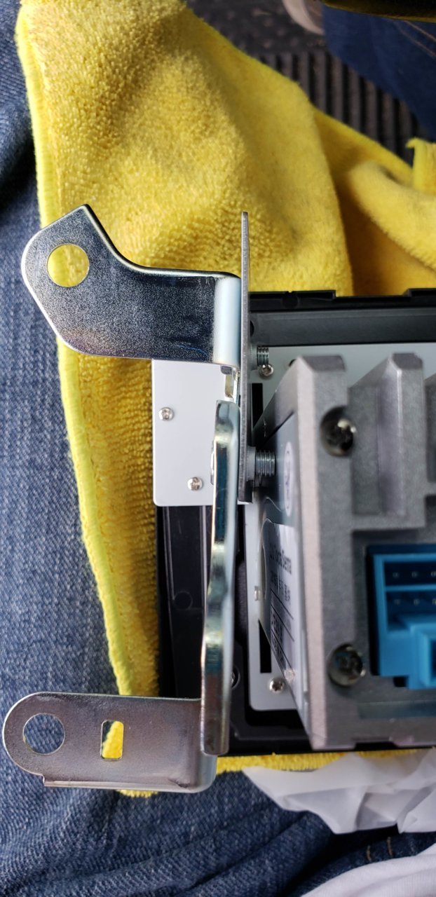

    Installations issues:
    I had to improvise with some washers in order to improve the fit of the stock mounting brackets to the unit.
    First try:
    Second try:

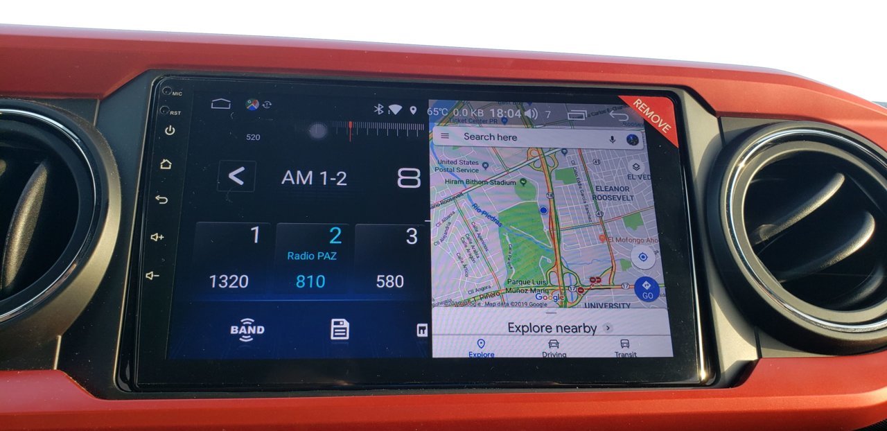

    Just to have a better perspective.
