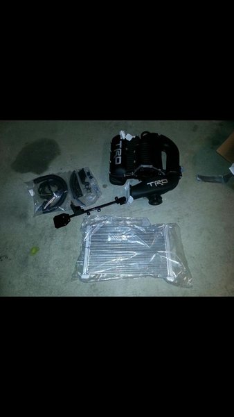

    im trying to buy a trd supercharger for my 2010 tacoma 4.0 v6 and i found one for really cheap. The guy mentioned how he only has the blower. and then later he said oh i have the fit kit as well but he says its missing some parts, so im kind of wondering whats going on here he says its brand new never used. I told him to send me a picture of everything he has so im going to post it here. please let me know if its missing anything and how much is the stuff thats missing and where can i get it. Thanks guys

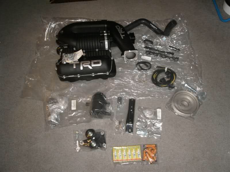

    Looks like a few parts are missing, here's a complete set.

    yeah does anyone know what parts they are or any information on them.

    So far I see missing injectors and SC belt tensioner. May bee more to but that's what I see off the top of my head.

    You have what is called a supercharger "fit kit" which are only the outer parts. That is useless without the bearings and other stuff. I'm guessing the price is between $700-$900 for the one your looking at
