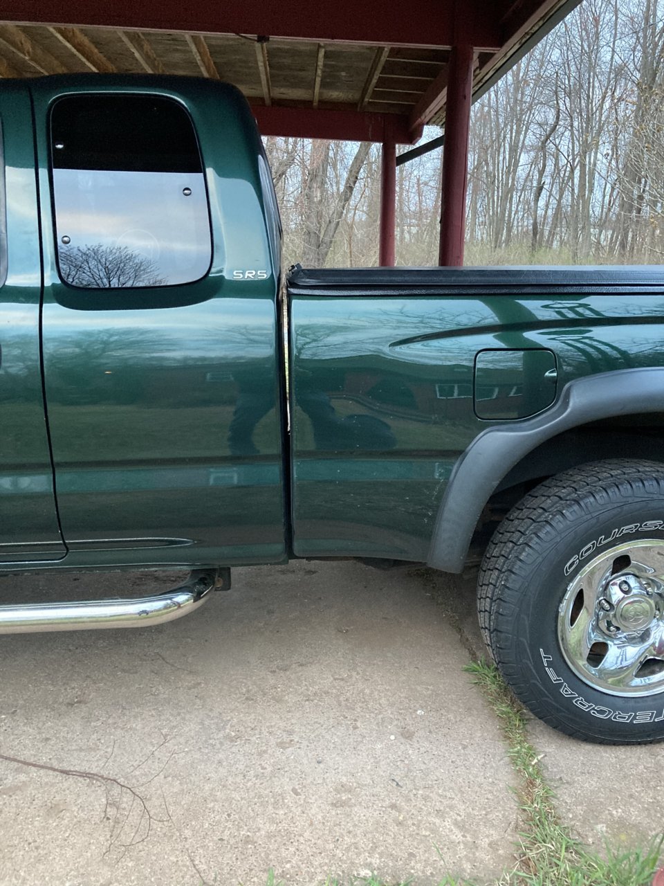

    Hello,
    I have an ‘03 Tacoma TRD. The bed appears to have tilted away from the cab. Please see the photo. The gap is wider at the top and it’s tilted back. Anyone ever seen this? Ideas? Thank you!!! Mark

    There are a few things it could be, your bed mounts, the bed itself is twisted, or your frame is bent in some way or another.
    If you’ve ever replaced the bed, been in an accident, had a body lift then or replaced the mounds then this would cause some misalignment.

    I'd guess if you've not done anything abnormal with it (improperly lifted, extreme off roading, etc) it probably has something to do with the bed mounts or bed mount bushings before I'd believe something is up with the frame. Unless of course your frame is crunchier than a bag of chips.

    A couple months ago I had two rust holes in the frame repaired over both rear tires. So it was on a lift quite a while for that work. Wonder if they did something with the mounts? The truck is pretty cherry fir a 2003 with 81,000 miles. I’m thinking something happened when they fixed the frame. The holes were small but rusted through.

    Mine is like that from the pallets loaded on the rear of the truck ans pushed front over the years.
    It does not hurt to get under and look for any major failures .
    Loose bed mount crushed frame etc.
    Good luck!

    If they repaired the rust on the frame more then likely due to heat of welding the frame is tweaked downward in the rear. You can shim the rear of the bed up to correct that misalignment. Honestly, if they used a level when they did the repair between the front bed mount and the middle bed mount you probably wouldnt have this issue.

    Depending on how the repair was done and how bad the rust was originally, if that rail was dropped even an inch at the most rear point it would cause this gap issue. With as flimsy as the rear of these frames are if they were just burning foot long sections in at a time that's the problem. Hard to really know without having any pictures of the bottom side of the truck.

    break out Ur tape measure & levels
    the frame prior to repair might have been tweaked/weakened
    while up on lift the repair might have overlooked the ‘ square ‘ of frame & bed
