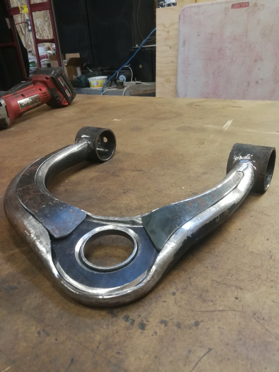

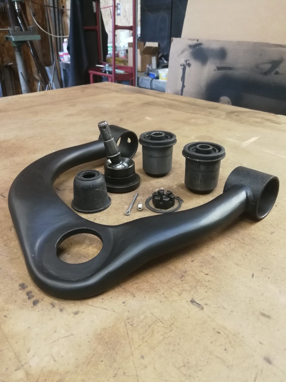

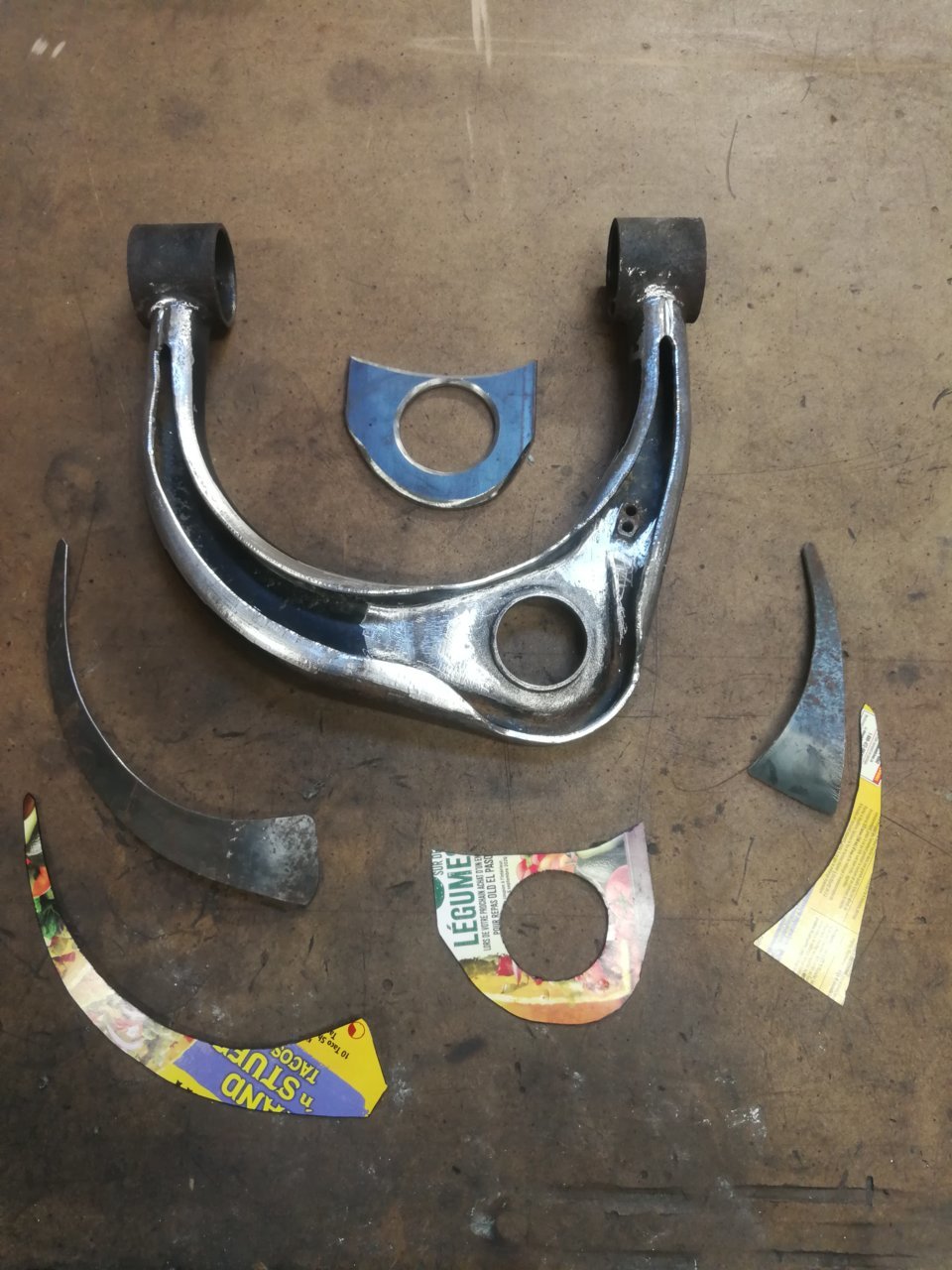

    Hi everyone, I've done a quick fix to make my steering more stiff. When I lift my truck and force the wheel left end right a saw the upper control arm twisting. Instead buy new expensive control arms, I tried to reinforce my stock arms.
