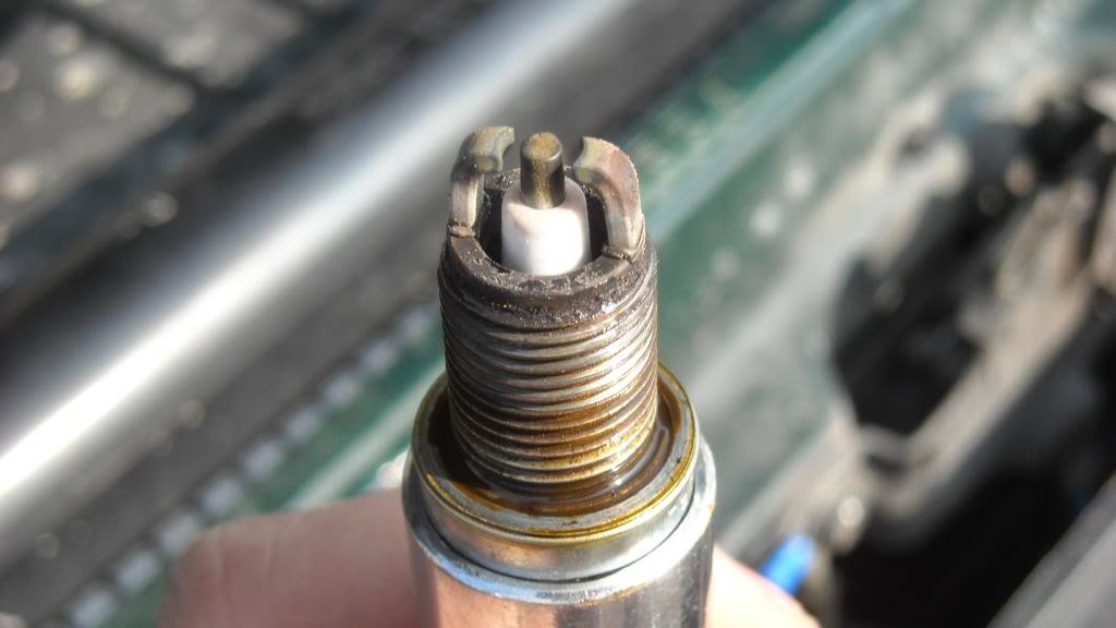

    Any chance you could take a good pic of the tips of the plugs?

    Sure tomorrow, anything in particular your looking for?

    I want to get a good look at the electrode tips, especially in the area of the white ceramic.

    Looking for all sorts of stuff. Coolant residue, improper burning, signs of lean/rich condition...etc

    And Bama Toy here is one shot of one of the plugs, they all look the same.

    Looks normal to me.

    Those are some strange plugs, also why is there oil on the spark plug?
    Also, they look normal, but I would just get some simple NGK or some Densos pronto, how can you gap that?

    That's what came from factory, I just replaced them all with the same ones. Not sure on the oil, or I dont remember the residue.

    They actually look quite clean, and in good condition. Minimal signs of outside arcing. I don't see any problems there.
