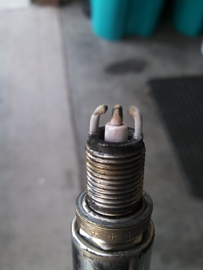

    Glad I stumbled on this thread, I have the same problem. I replaced water pump, timing belt, tstat(Stant 170), radiator (2 core), lower radiator hose, about 10 flushes with distilled water, 2 flushes with cleaner, new spark plugs, and seafoam. I am at the point where I think it is the HG. I have been using green coolant, because Toyota red is too valuable to diagnose a problem with, it seems to come out "murky" after being ran for a while. There is also "sediment" in the overflow reservoir after a few hundred/thousand miles. If I am running around town the truck runs between 190-210, on the highway for short trips it runs at 230. The interesting thing is the only time the dash gauge moves up is once the temp hits 240. If I turn on the heater I can get it to 220, or if I downshift I can get it all the way to 180. That fan clutch has me thinking, I want to get the coolant chemical tester before I buy anything though.
    Here are the old plugs
    I bought this truck because the engine was "in great shape," guess they left out a few things!
    Thanks for any help!
