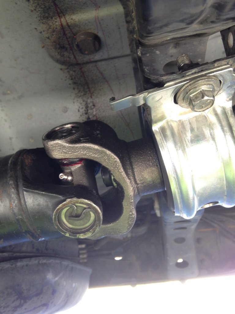

    I am going to drop my truck off Friday morning to have the driveshaft balanced, a brand new carrier bearing installed and all 3 U-joints replaced. I installed the CB spacer kit and it helped a little but not enough. As I installed that spacer, I grabbed the driveshaft and could move it around fairly easy and the rubber in the bearing seem to be pretty weathered. Maybe this is causing most of the vibrations? Here is what I have checked so far hunting this down.

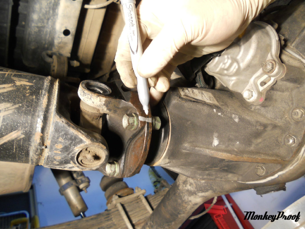

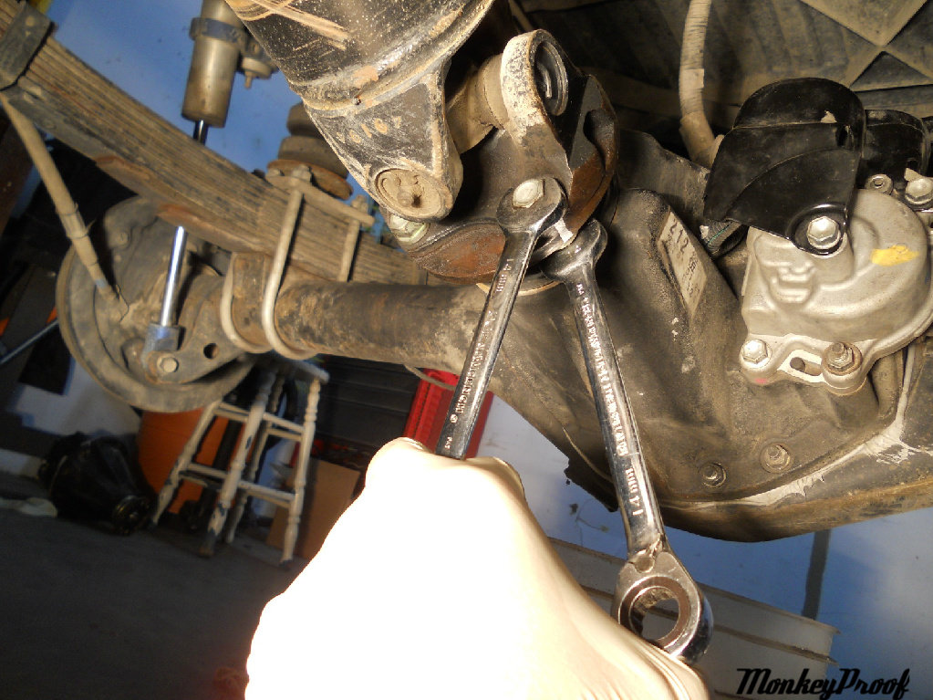

    First 2 pictures courtesy of @MonkeyProof
    Mark a spot on the drive shaft and pinion flange like so using a paint marker:
    34e9phi_7e5ecf73d1fd691bc97c6399d1e575bed12dab6f.jpgUsing (2) 14mm wrenches remove the 4 bolts that secures the drive shaft to the pinion flange:
    Remove 14mm bolts holding carrier bearing

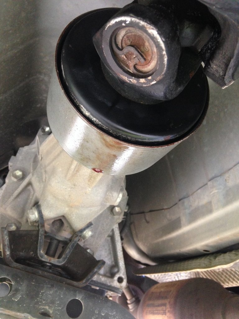

    Slide entire shaft out of transmission output shaft housing.
    03624F1D-2D3B-4662-BC95-1A90E1E2C034_zps_c1f8081e6d8ed9301cb3362c7cc56bc121d3762f.jpg

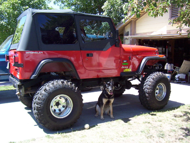

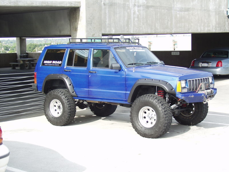

    Tom Woods 1 piece. Have them in all 5 of my current lifted vehicles and many from the past. Here is a highly lifted Jeep with one, solved all of my problems for $350 bucks. Good luck.

    What makes a lift highly?

    Springs over axle, crazy DS angles, likes to roll over without any notice.

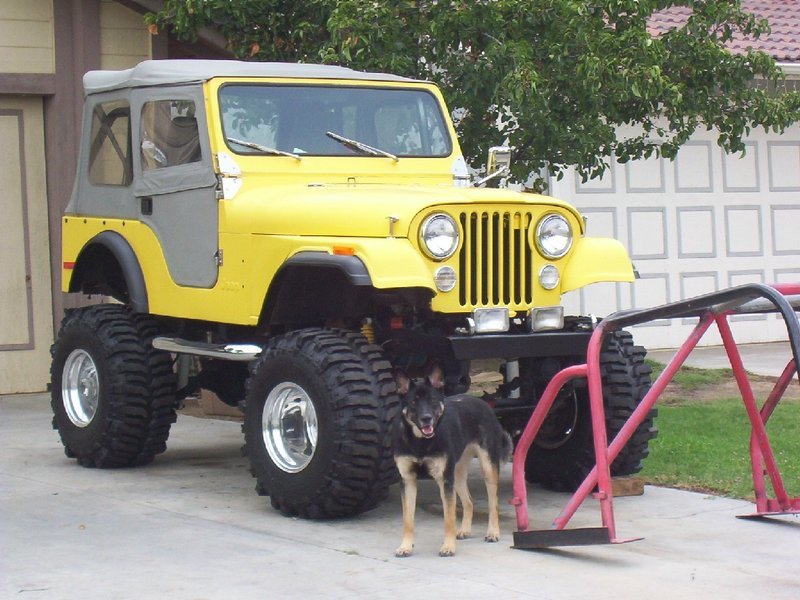

    Here is another pos I built.
