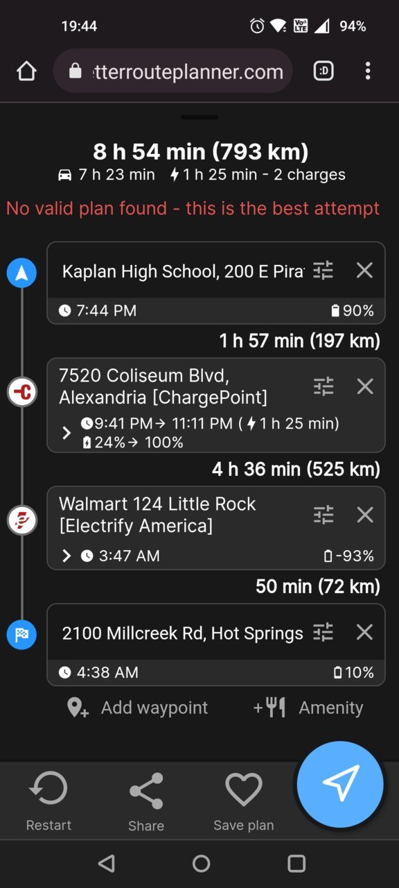

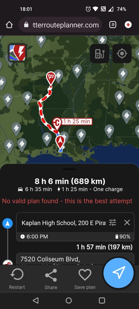

    I utilized this website. Honest question...
    It shows -32% charge when I arrive at the 2nd charge station.
    6hr 35min drive, 1hr 25min charge, arrive at destination 8hrs 6min with 11%
    Does this mean what I think?, Majority of the route is red dashes.
    I could be using this wrong. I simply picked 2 vacation spots we went on in 2022.

    What vehicle did you use for this route?

    Rivian R1T

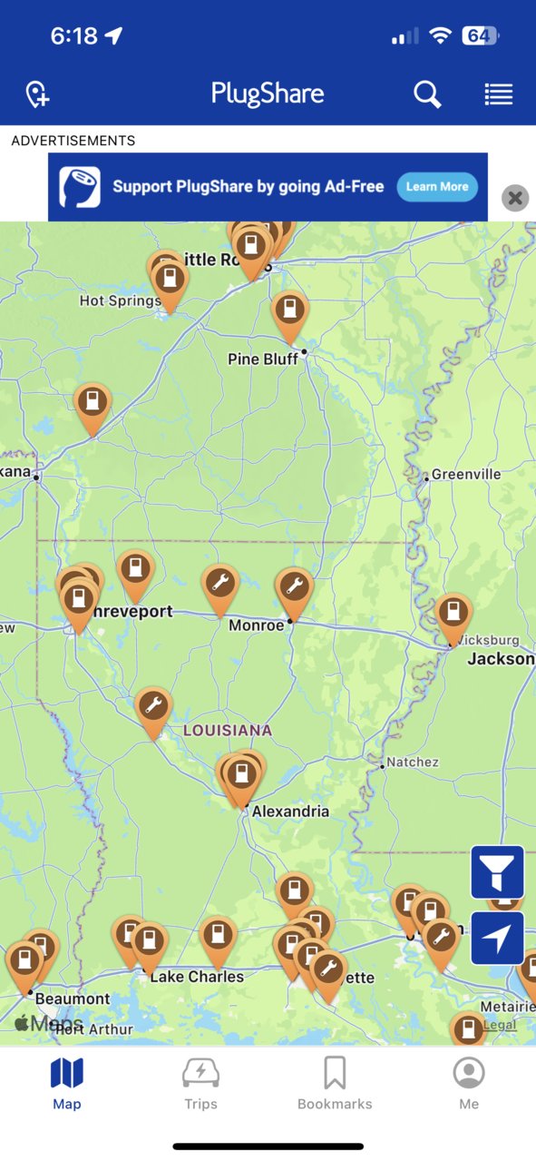

    Looking at PlugShare the trip is absolutely doable but there aren’t good options for actual fast, fast chargers. Several are pretty slow 24kwh DC chargers that will certainly work but are well slower than ideal.

    I don't have an account there so I can't simulate. But that's the point, doable but very inconvenient.
    Kaplan Louisiana to 2100 Millcreek Rd. Hot Springs Arkansas. That's a 6hr 36min drive for me in the Tacoma, granted there is 1 fuel up required so under 15min added so call it 7hrs total.
    VS the EV route
