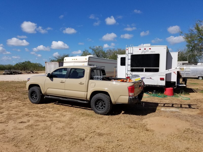

    I had 750 lbs of deer corn, 100 lbs of ice, a heavy toolbox and two passengers and it did just fine. That puts her near the max weight (1420 lbs) but rode and performed just fine. Had a bit of a Bro lean, but nothing bad.
