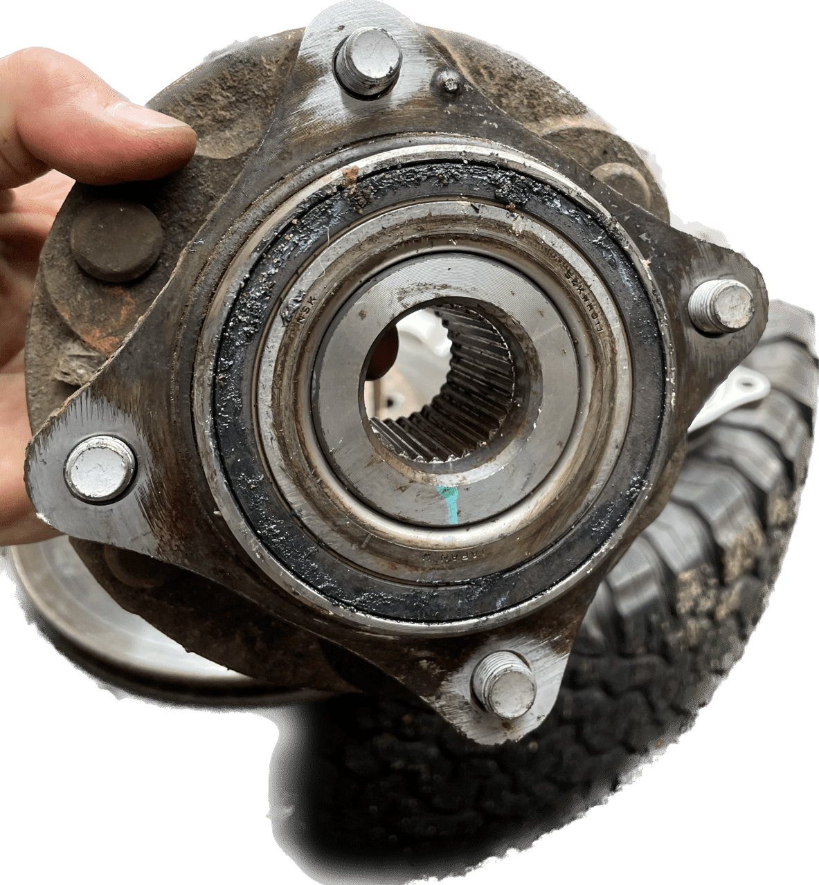

    Im replacing the front wheel bearing and hub on my Taco and I ordered a full hub/bearing pre-pressed assembly.
    When it got delivered it came with what Im assuming is an extra metal ring/seal, but it was damaged. Im wondering if this is actually an extra part and I dont really need it right now...see the photo below, thats the ring. Anyone know for sure?

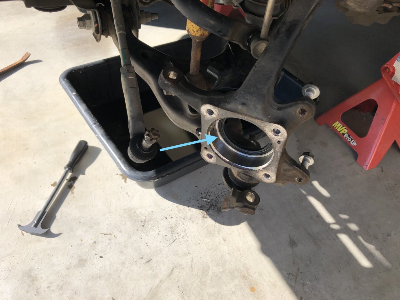

    That’s the seal on the back of the knuckle between it and the cv.

    You should have gotten that seal and a large O-ring.
    The o-ring goes on the hub. And the metal seal goes in the rear of the knuckle.
    I disconnected the lower ball joint mount bolts (2 of them). Then disconnect the tie rod (1 nut). Pull out on the bottom of the knuckle. Spin the knuckle towards the the front of the truck. You’ll see the metal seal. I used a small wood chisel to get the old seal started out. Then used a large screw driver the pry it the rest of the way out. In reality it only takes about 10-15 mins longer? Maybe?
    I did replace the seal once, the other time I didn’t.
    If you haven’t replaced the seal before, now is a good time.
    Your’s are almost 12 years old now.

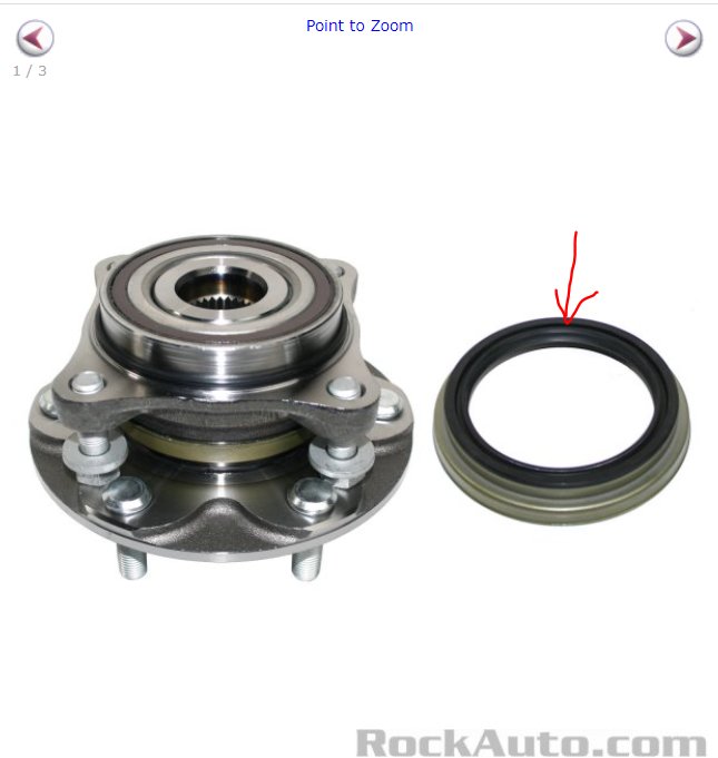

    Here the seal.
    It goes in from the back side.
    The CV Axle slide INTO it.
