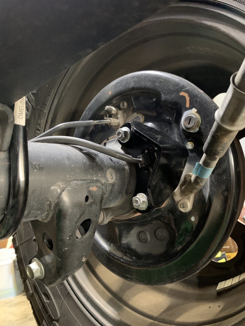

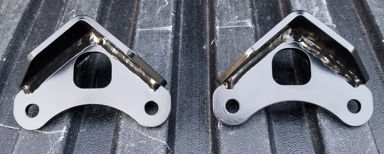

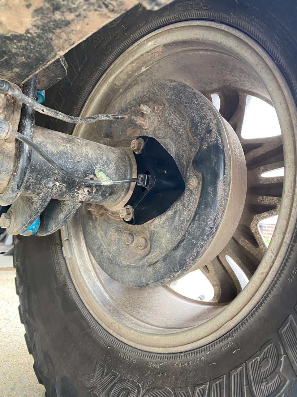

    2005-2023 Tacoma wheel sensor skids
    , made in USA with 3/16" high strength steel
    https://archivegarage.com/products/tacoma-wheel-sensor-skids-2005-rear-axle
    Install Instructions (time 15-30mins):
    1. Block front wheels, recommend that rear axle be raised just off the ground and placed on jackstands, to remove weight off nuts/studs.
    2. Use narrow flat blade screwdriver to release sensor connectors
    3. Use 14mm socket to remove 2 nuts per side.
    4. Place skid brackets on studs WITH WELD BEAD INBOARD TOWARDS DIFF (weld should be visible when mounted)
    5. Reinstall factory nuts and torque nuts to factory spec 27 lbft
    6. Plug sensor connectors back in
    Fact: Archive designed this independently weeks ago without knowledge of another brand offering similar ideas for a different Toyota model mounted to bearing studs.
    @PcBuilder14 Passenger side:
    Driver Side:

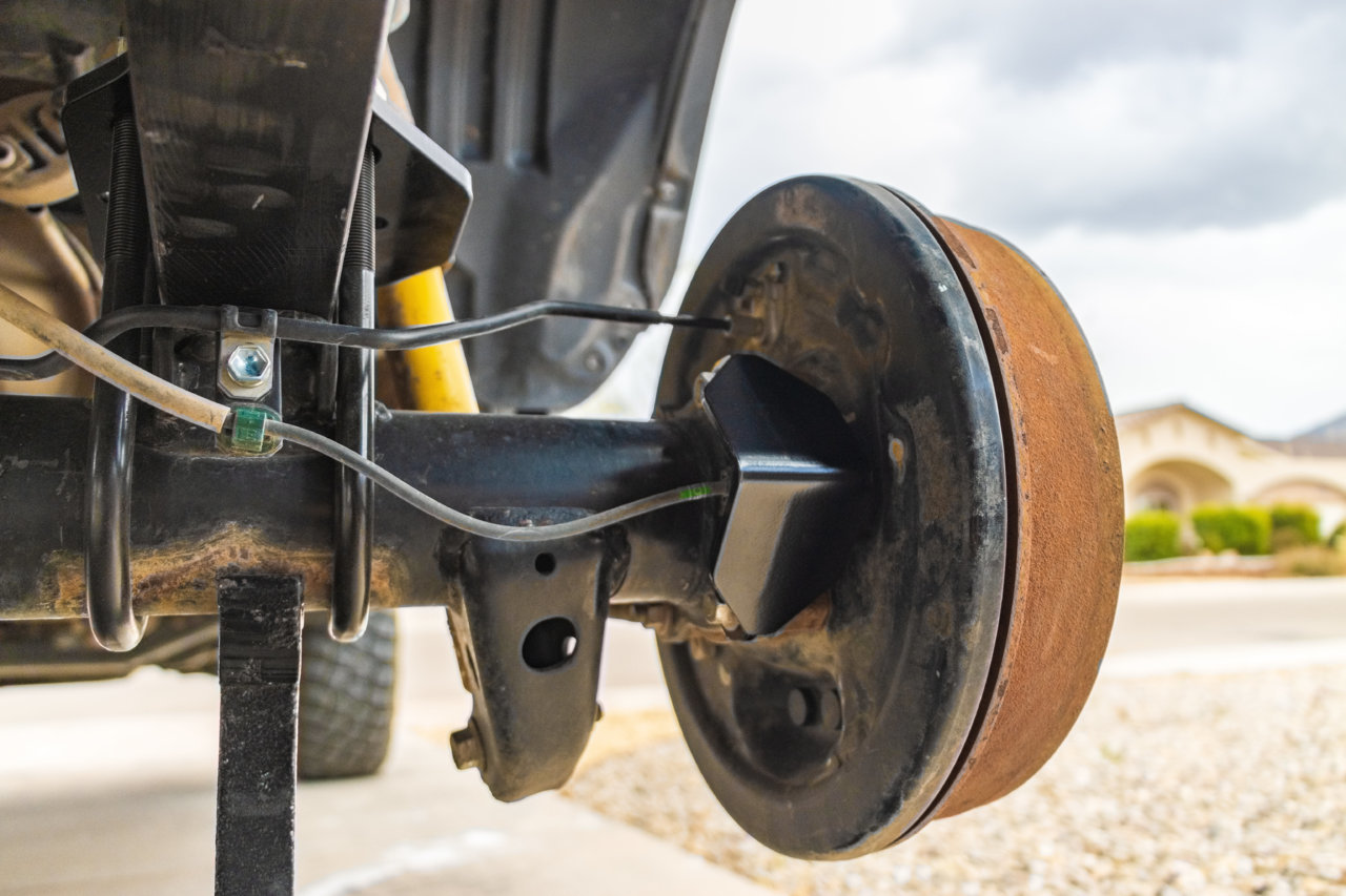

    One of the easiest things I’ve installed. Didn’t even jack up the truck. I crawled under with my impact and a 14mm on a swivel. unclipped the sensor, undid the two nuts, slipped the skid on and reinstalled nuts. Reconnect sensor. DONE.
