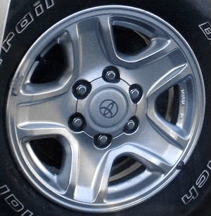

    You might also consider these... 4.625" BS so not a huge difference from stock 4.5". I have a set needing to be refinished then I'm going to try and pair them with 255/85's. Not sure if it's going to be a success, I know I'll need to hammer away a bit but hopefully won't have any severe frame rub at lock.

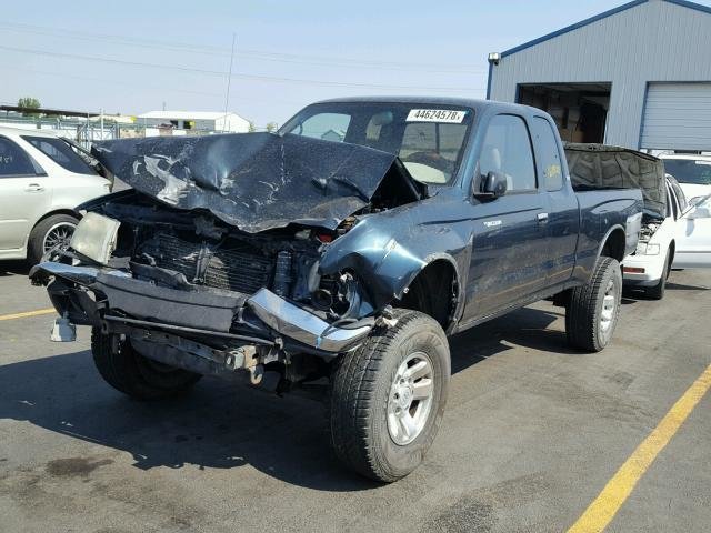

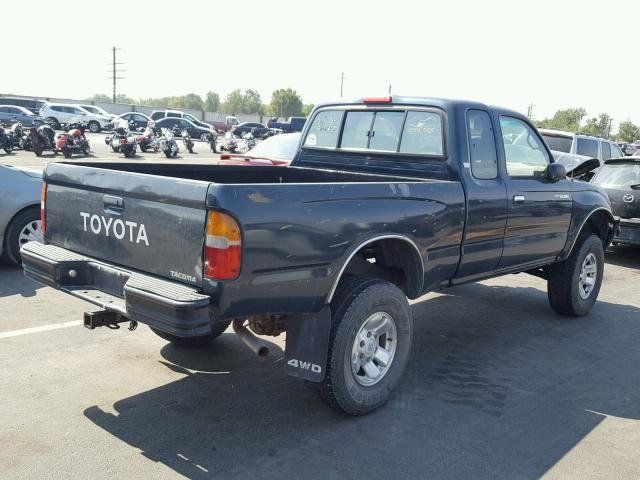

    Thanks to the helpful link from 1997tacomav6 in another thread I found these alloy wheels and getting them shipped out from Idaho recycle yard for a spare set to put some more fuel-efficient Highway rubber on during the summer or switchAroo with the winter rubber. I think this poor truck had only 168k on it and I sure hope anybody inside survived this. Probably will get what I pay for but these wheels I priced new at $400 a piece at camelback recently is a good chunk
    Now I probably got to look at getting some good wheel cleaner/polisher and do my originals while I am at it

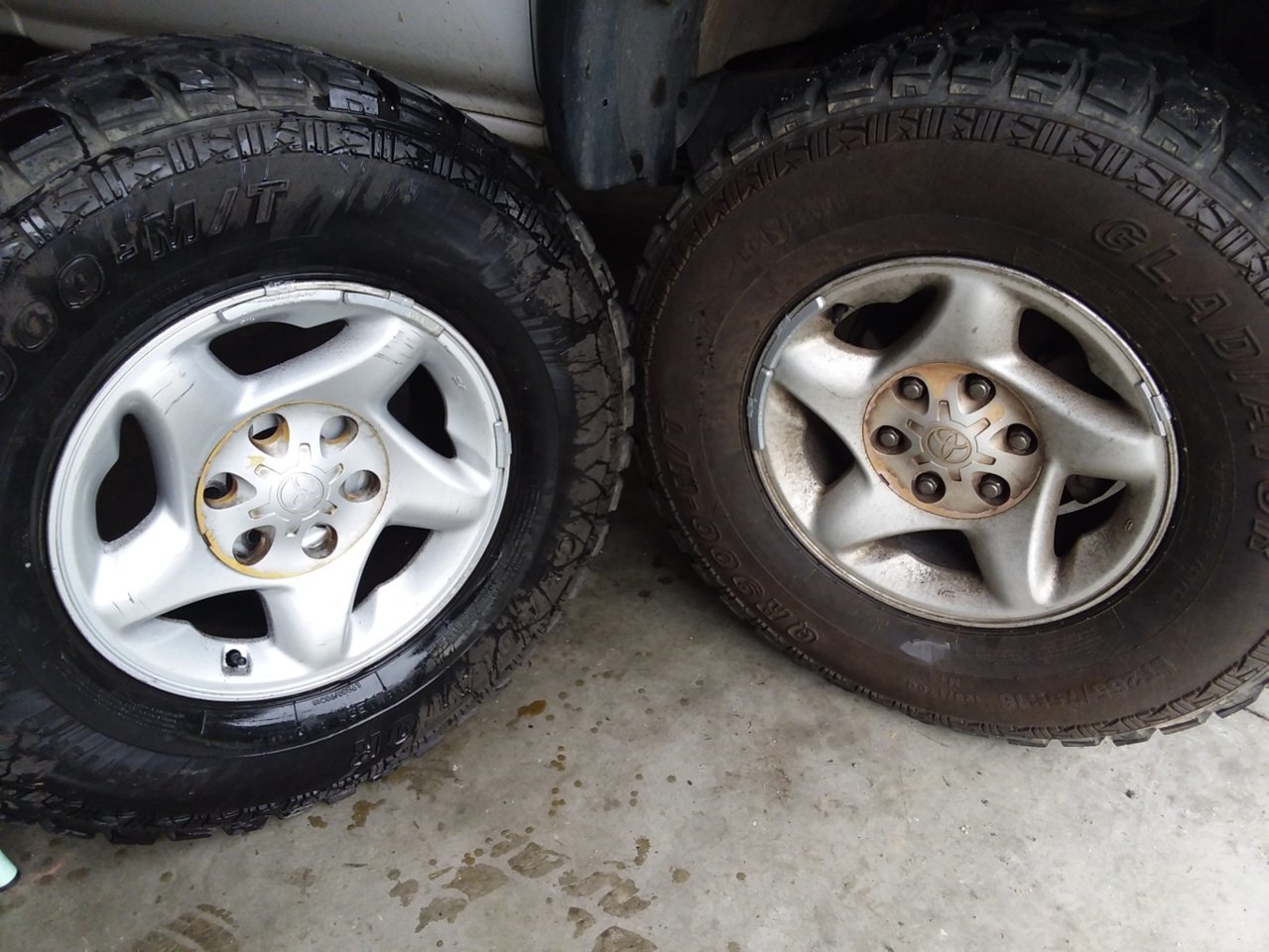

    im looking to get some 3rd gen wheels as a second set as well. missed an opportunity for a free set a month or so ago.

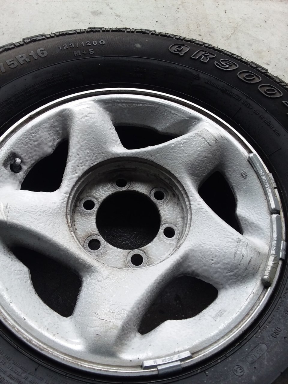

    any way i finally got fed up with my old wheels being permanently stained with brake dust. tried various things including simple green (not much help) wheel polish ( works slowly with a LOT of effort) then finally oven cleaner ( darn near miraculous)
    in just about 2 minutes the oven cleaner loosened up that brake dust so that i could brush it off with a tooth brush and water without much effort. i did each wheel twice.
    not fully restored but much better. a chill restore would require sanding and repainting.

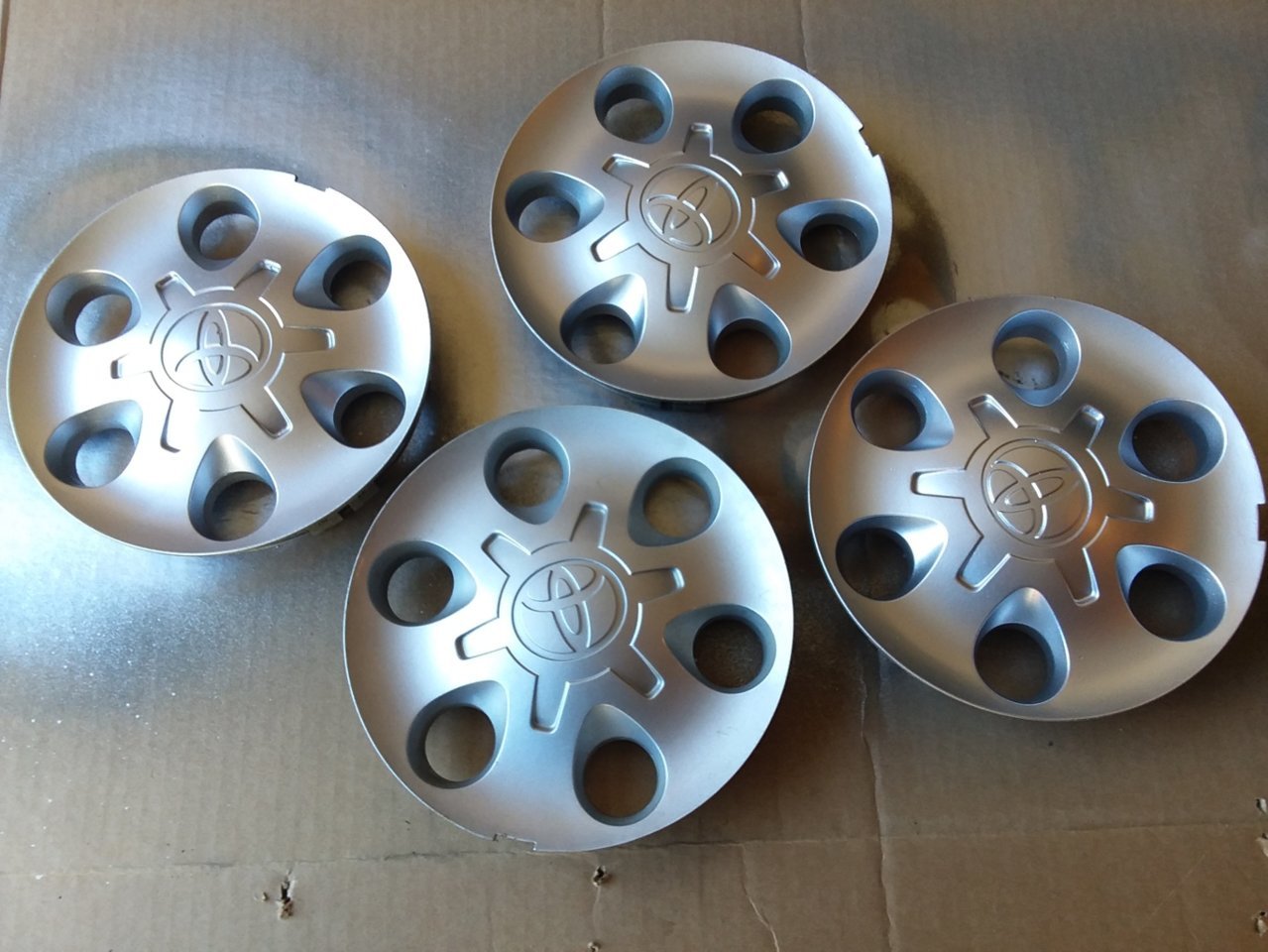

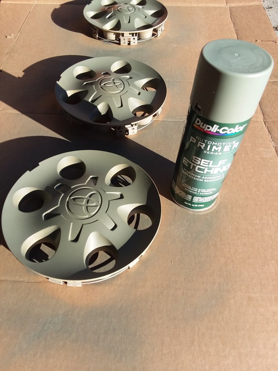

    finally the hub cap covers where gross so i stripped those with orange stripper meant for furniture and repainted.
    last one is a good factory compared to the repainted ones. pretty close.
    use this method of you find some grody wheels for cheap.
