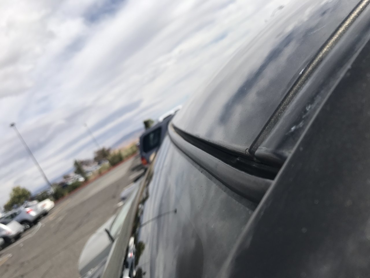

    Try tucking your windshield seal in first. Takes one minute and is super easy. The seal can flap in the wind and create the kazoo. Here’s what mine looks like after poking it in 18CDDC9C-FD86-4EC1-BEF0-FCA6A21B8B29.jpg

    The other source could be the section of trim that is right around the side mirror sail panel. You can diagnose that one by pressing on the sail panel real hard and the noise will go away.
    That one is my issue. I haven’t done much to fix it yet as it only acts up if I’m going 80+ or there is bad wind.

    Mine doesn’t have that window seal to tuck in either that or it already is....? I’ll have to try the other suggestion. Mine does it all the time regardless of speed
