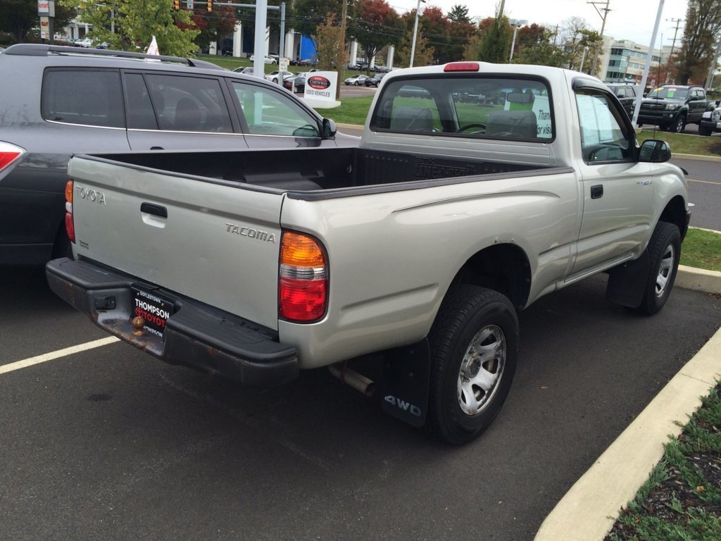

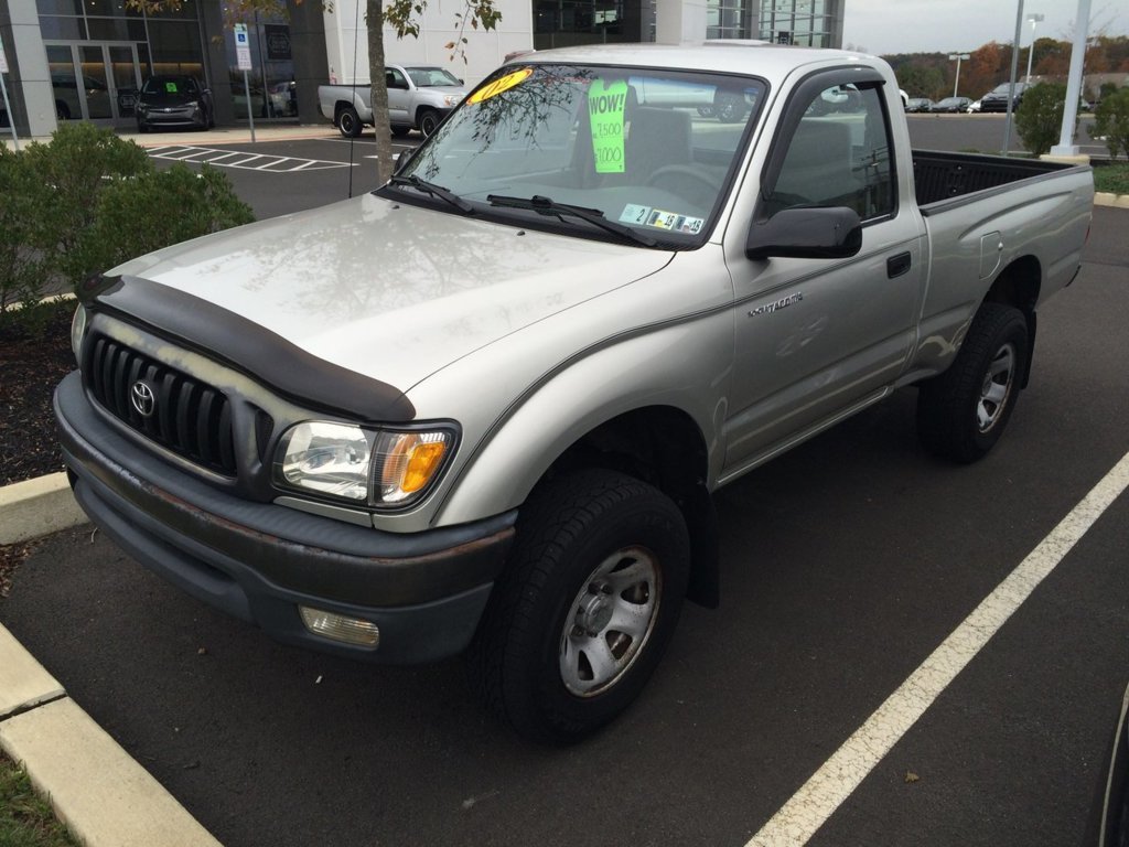

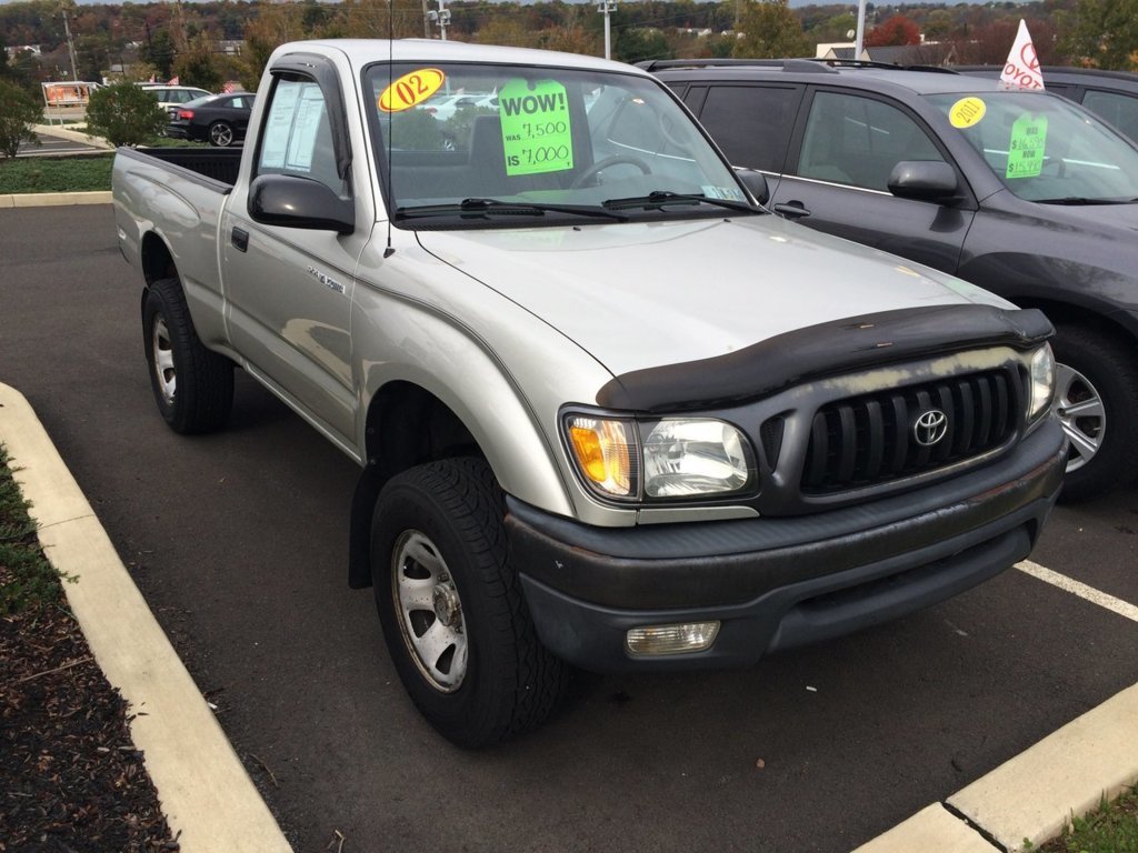

    I saw what I believe is your truck's twin at the local dealer in my neck of the woods back in November 2017...

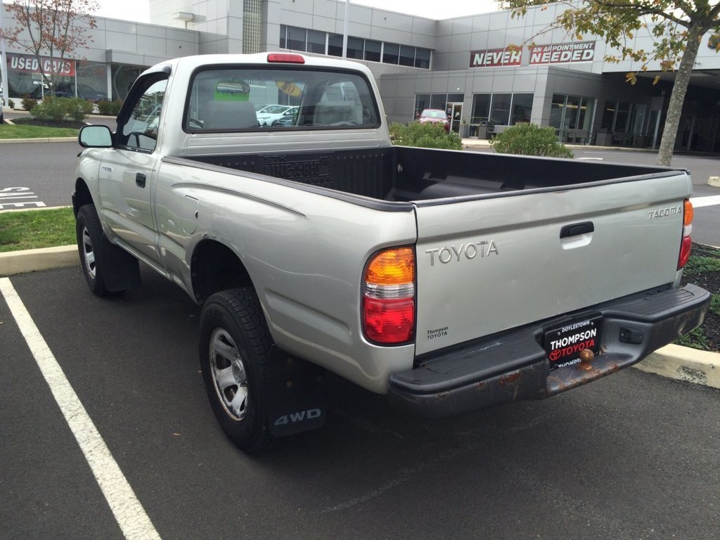

    No A/C, which is shocking for a 2002 base model truck of any make or model here in Southeast Pennsylvania!
    8CACF85D-18EE-4133-8A29-137170617ACE.jpg 326896E6-B220-4156-BD7D-354F4CFDAC36.jpg

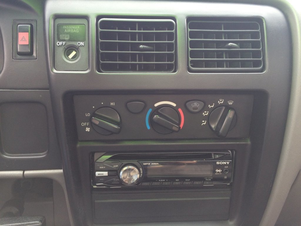

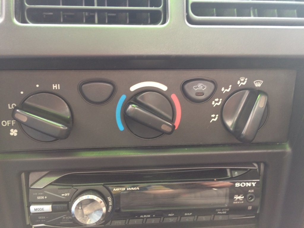

    OP, do your HVAC controls look like the one above with the blanking plate in place of the A/C button, or is there evidence that there was an A/C button at some point?

    I, too, have a 2002 base model without AC. Only “option” mine has is 4wd. My dash looks exactly like yours fwiw

    That's actually not mine; I found it for sale at the local Toyota dealer almost four years ago. I do not have power windows, but one thing I could not do without in a vehicle is A/C, which my truck has!

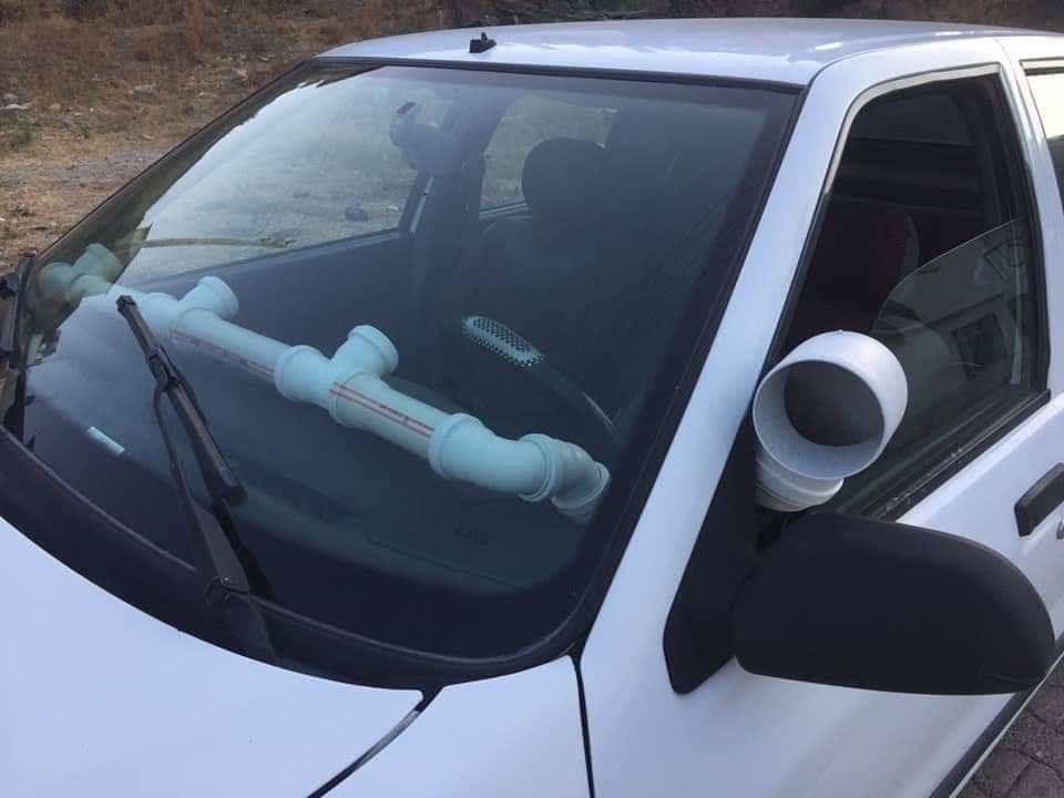

    I'm not saying I'd want to go back, but it wouldn't be worth the expense of adding it to a 20 year old truck to me. You still have the option of 2/60 AC. That's 2 windows down @ 60 mph.
    Or do something like this.

    I love that Toyota just put a blank button :p
